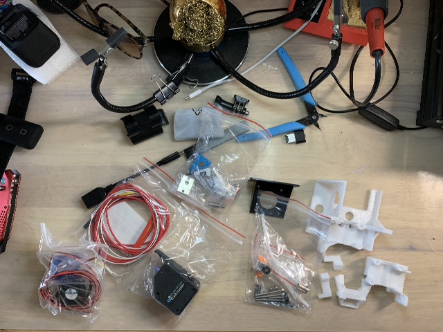

Parts arrived. Need to go to pick them up and hope to mod this weekend.

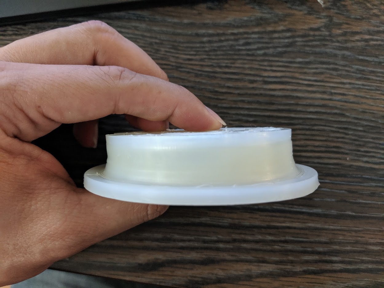

Increase the bed to nozzle distance as much as you can, while still making sure that the first layer sticks. The first layer shouldn’t be squished, this is the most important part. Trust me, it will work. Print first layer slow 15mm/sec and others at 35mm/sec. Use 0.5mm line width, so that the nozzle doesn’t touch the already printed line. Use 0.4mm retraction distance.

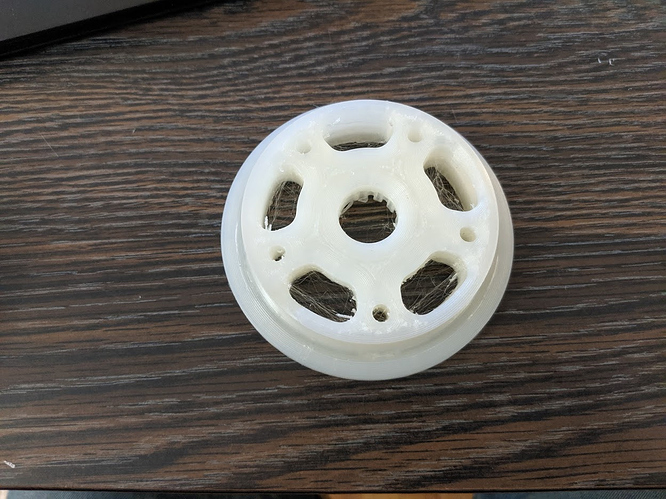

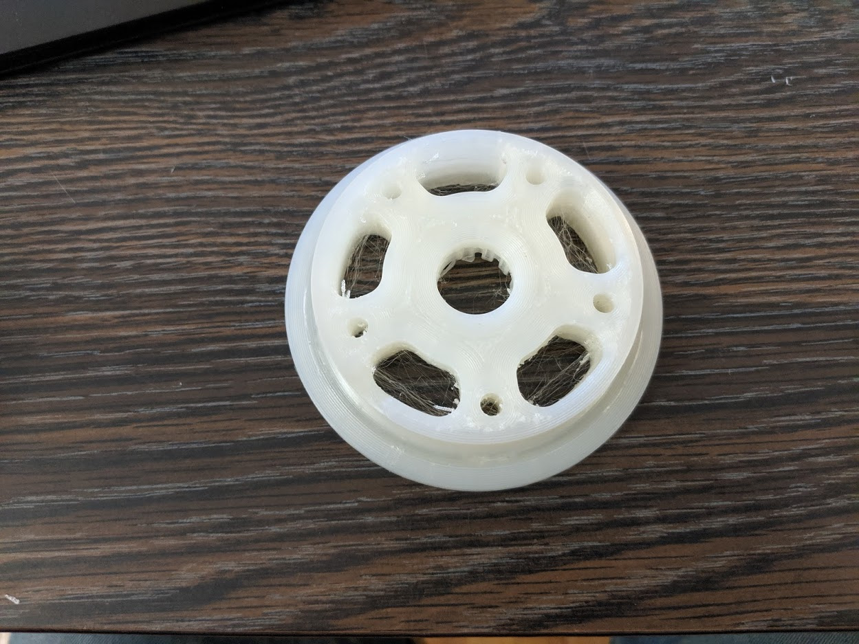

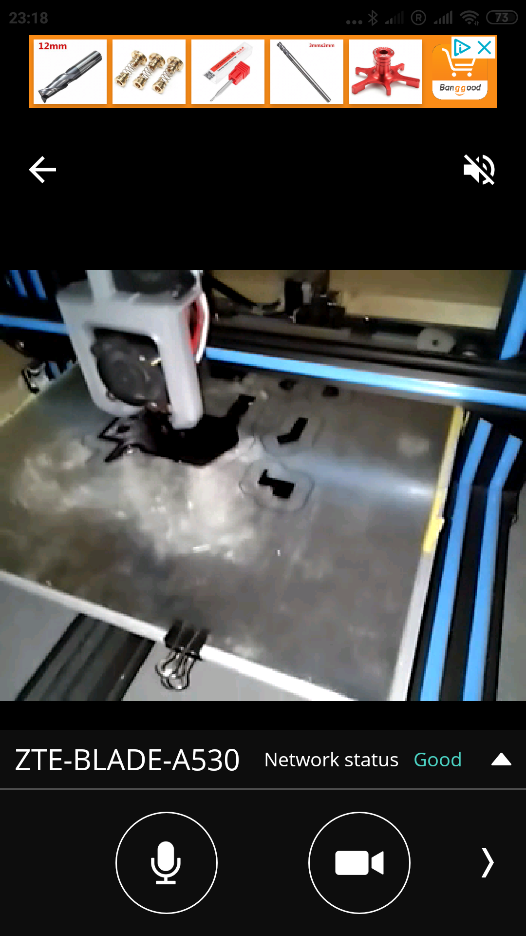

It printed great but even with 20 lines of brim the part lifted and warped. So now the print is pretty wonky. Maybe I have to enclose the printer properly. Support structure comes of easily, so that’s a win.
I got warping only on very large parts. Try different beds. I got lucky with one enclosure on glass and hair spray, first layer 90 degrees then I uncooled the bed.
Any purple glue stick or anything on the bed?
Got pretty much everything including the new creality tsc board!

Glue stick yes, but not purple. Next time I’ll try the white liquid PVA glue like alloy 910 manufacturer recommends. Other thing which they recommend is 35C build plate. I had mine at 70C. Don’t know if that will affect anything.
First time I hear about 35. Always read 70C as you did. To me different surface bed and mostly an enclosure if you don’t have it. That usually make a lot of different.

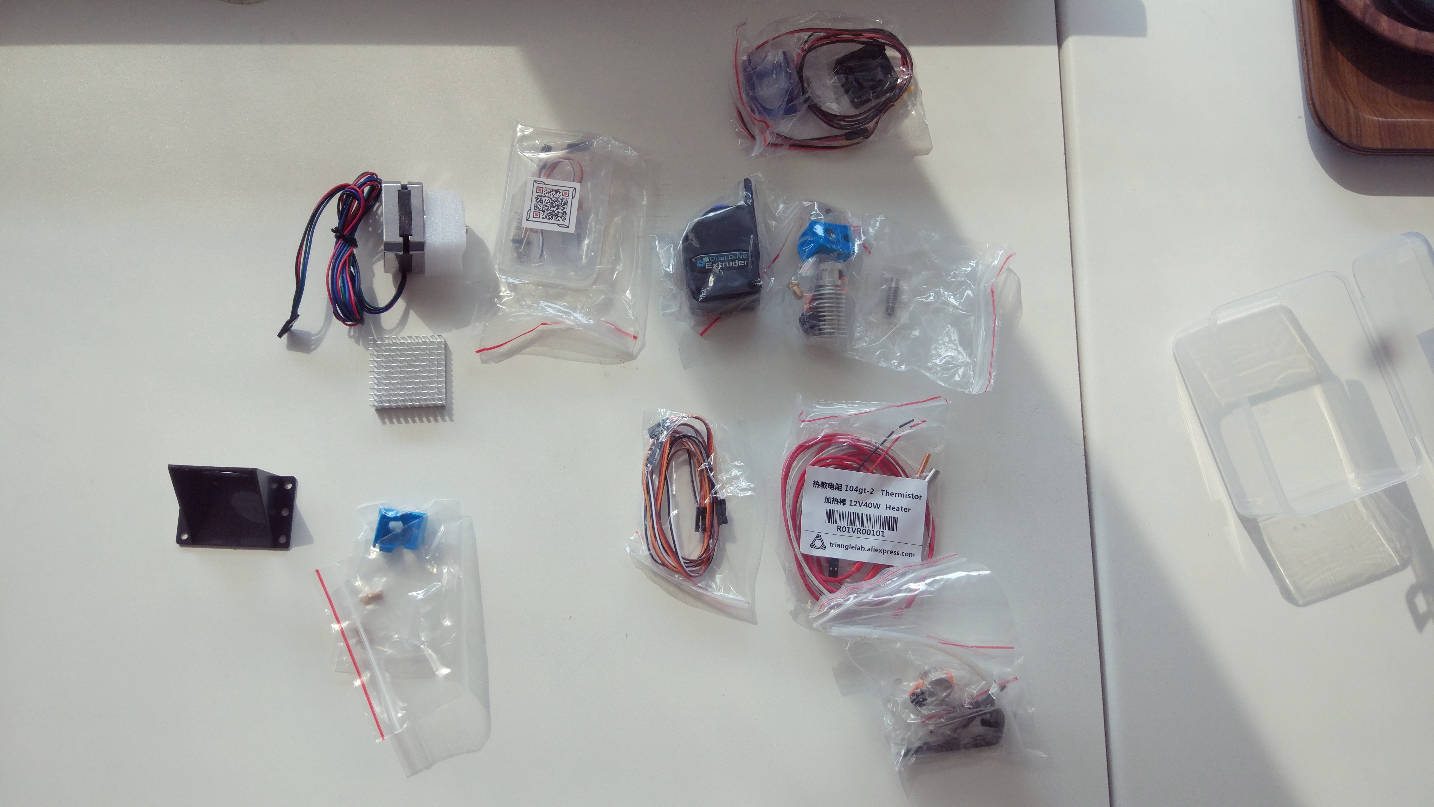

Did you also get the pancake stepper motor? I don’t see it in the pic.
Got the parcel from Trianglelab. Really nice. They even included the heat sink for the stepper motor. Looking forward to mount it…

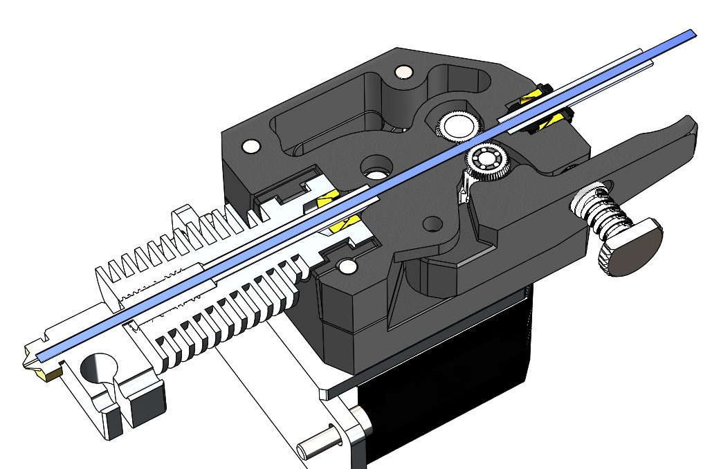

didi you install the bmg and V6 with the 5mm PTFE tube sticking out and going inside the BMG system?
Like in this picture from Bontech
I used standard PTFE tube, which I think is 4mm OD. It was only sticking out out of the V6 by about 1-2 mm when I installed it, as otherwise it would be hard to install the V6 into the BMG.
Yes, that ptfe tube is very important. I had put it without and immediately resulted in jam. I followed bondtech’s instruction. It should come with one, right?

Yes that was my doubt. I tried and I can only get like 1mm in the BMG and not 5mm. That’s why I asked. Ok I will do like that thanks.
