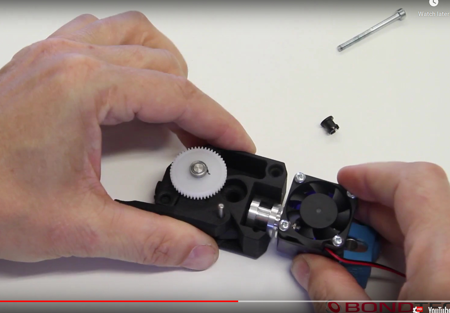

@DAddYE, this bondtech video is what i followed

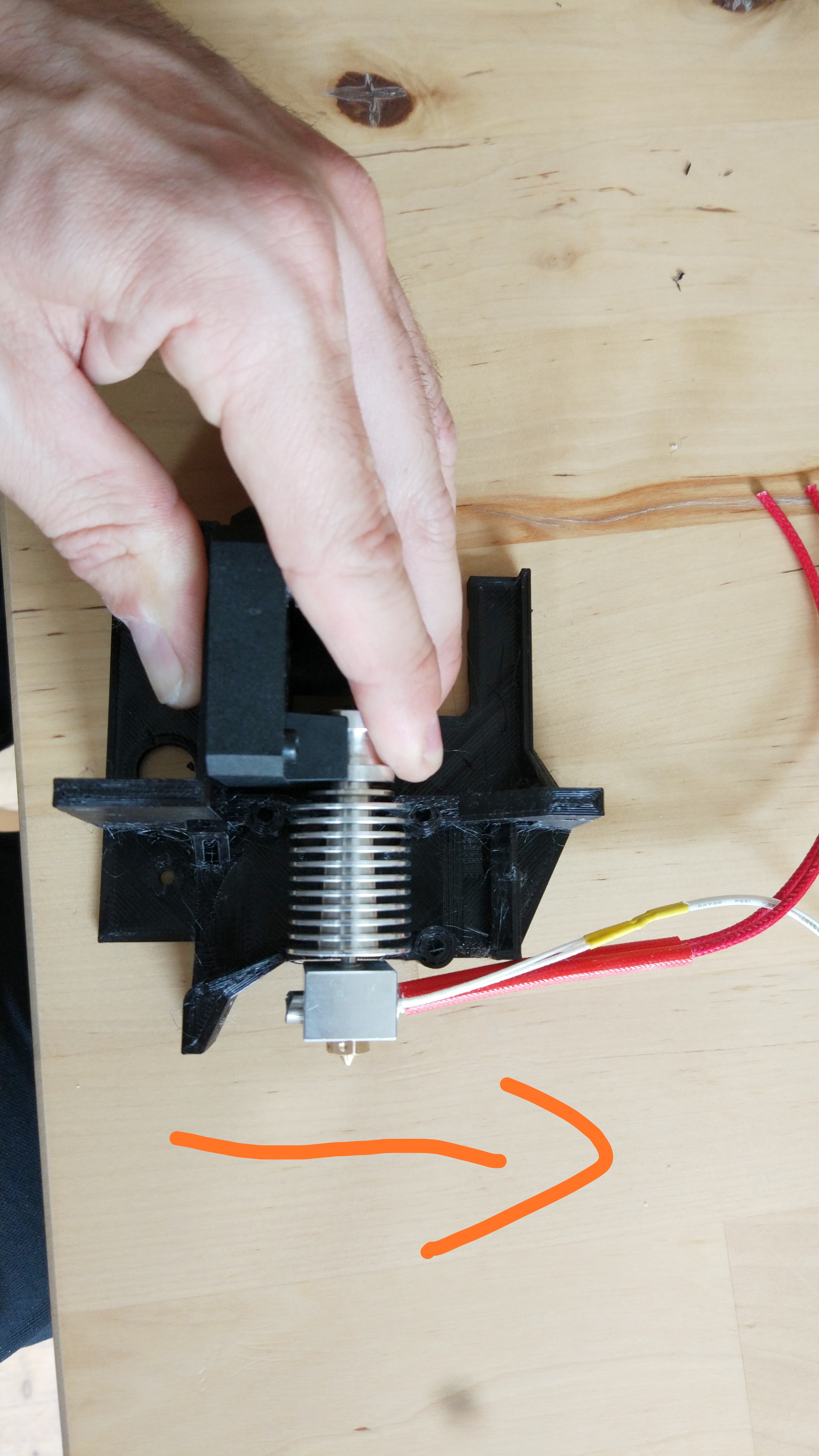

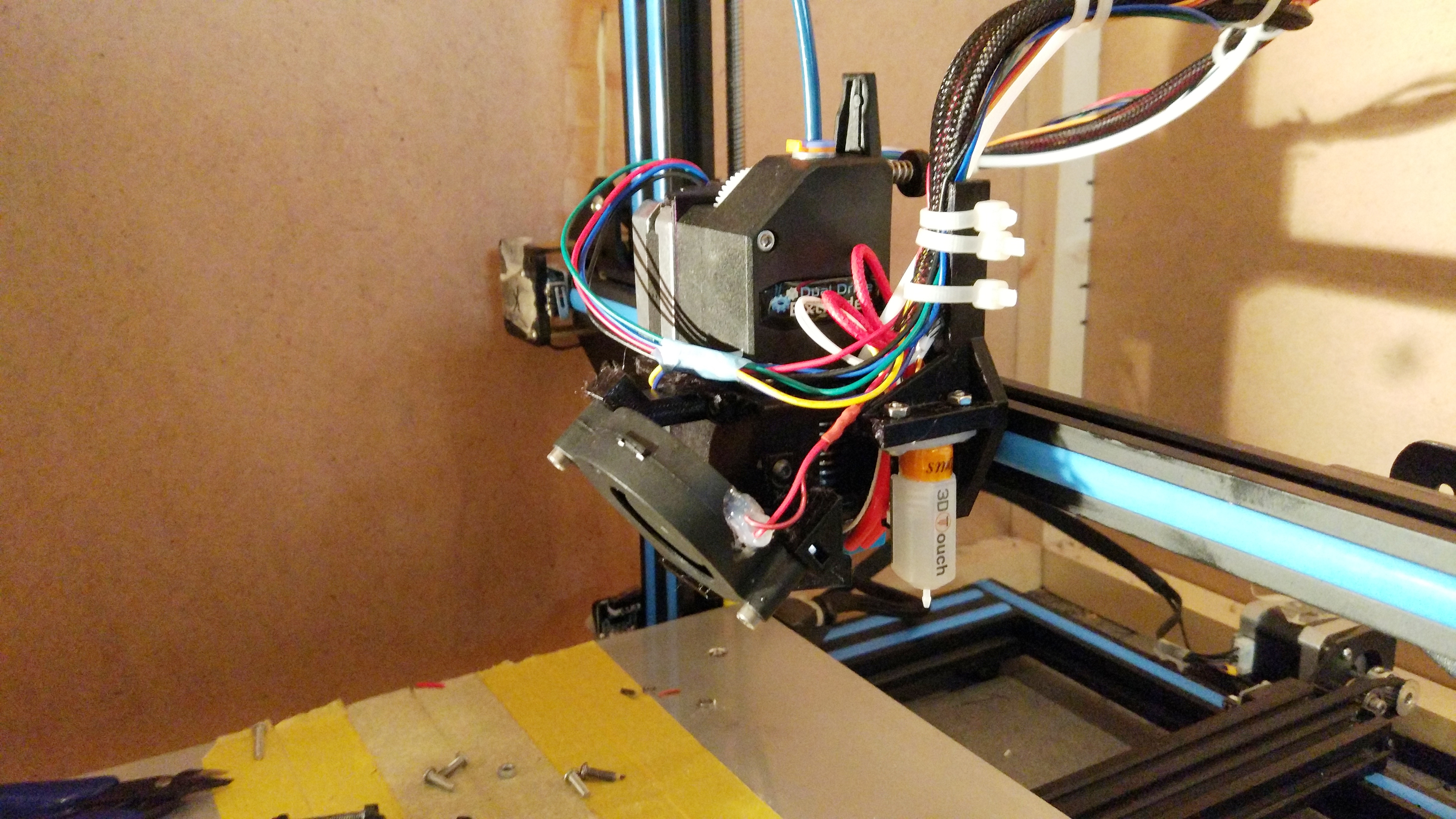

Man did you also have problem to assemble the hotend in the mount? The pocket is good but the all thing is shifted of like 2-3mm to the right and so no way I can get it in. I am also try to remove plastic but it’s al lot of material and I can not get it in. Problem that I have already unmount all the stock parts so can not print another one after fixing the step file.
Maybe in the picture is not clear but the hotend finds itself 2-3 mm off set from the pocket.
@rey8801, did you put that black piece on the side. It shouldn’t be on the hotend.
It’s ok I got it work. Dremel and make a new pocket and that’s it.
Yes I know thst you don’t have to use the bowden clip. It won’t literally fit in the BMG with it
Can you show where you had to remove material from, so I can fix that?
Also @mishrasubhransu did you have the same issue?
Yup! Guys that was my issue. The damn clip! You have to remove it. That’s why mine was getting stuck all time.
Also … yep, I had to dreemel it as well. Sorry I forgot to mention it

Anyhow here it is. I still have to update the firmware. I hope I connected the bltouch to the right pins.

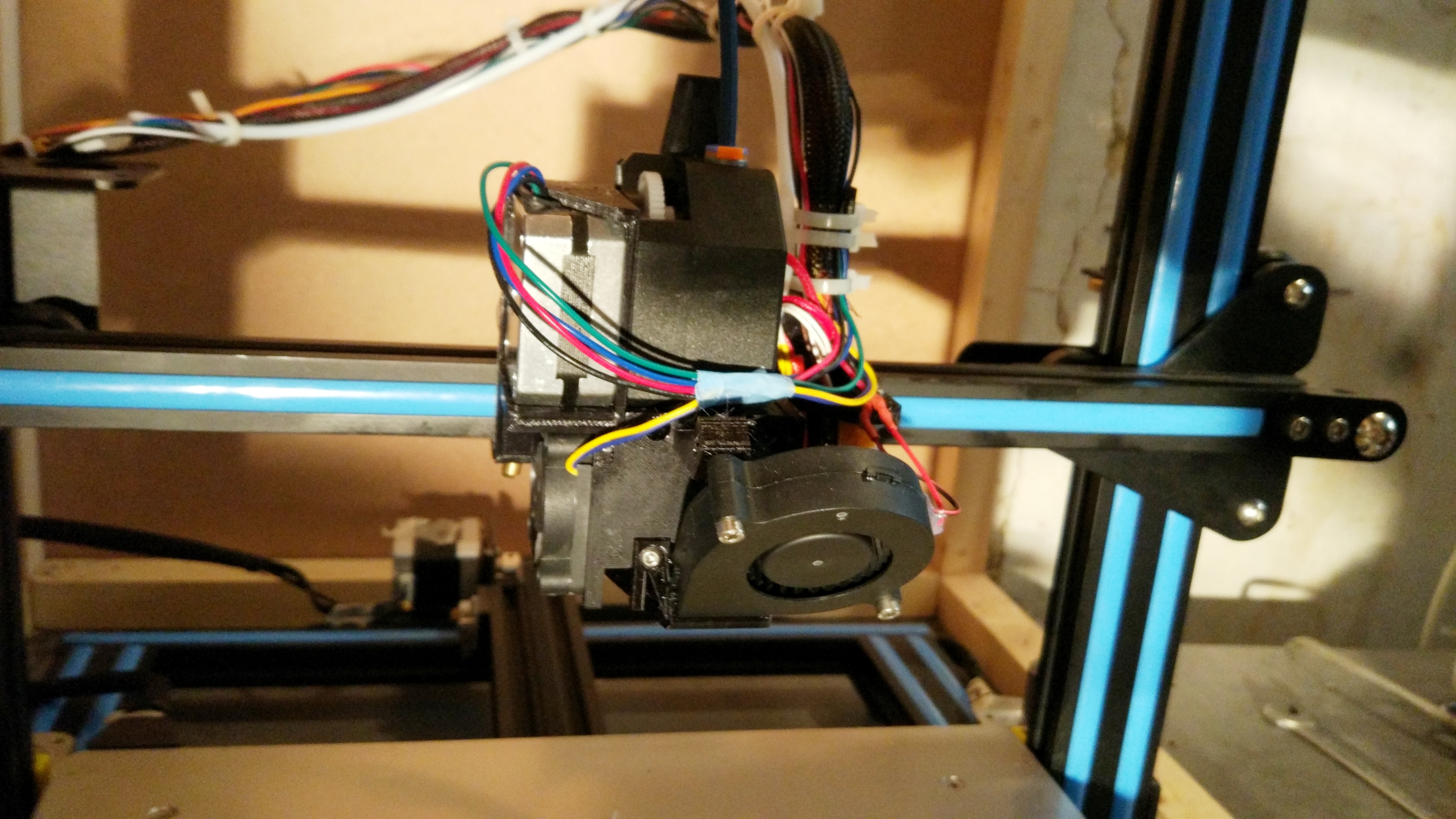

I used a bowden tube to keep the wires under tension otherwise they could bend and on tall prints potentially touch the print. I should make something to keep the wires up, maybe usong a skypass holder. The one with the spring :grin:

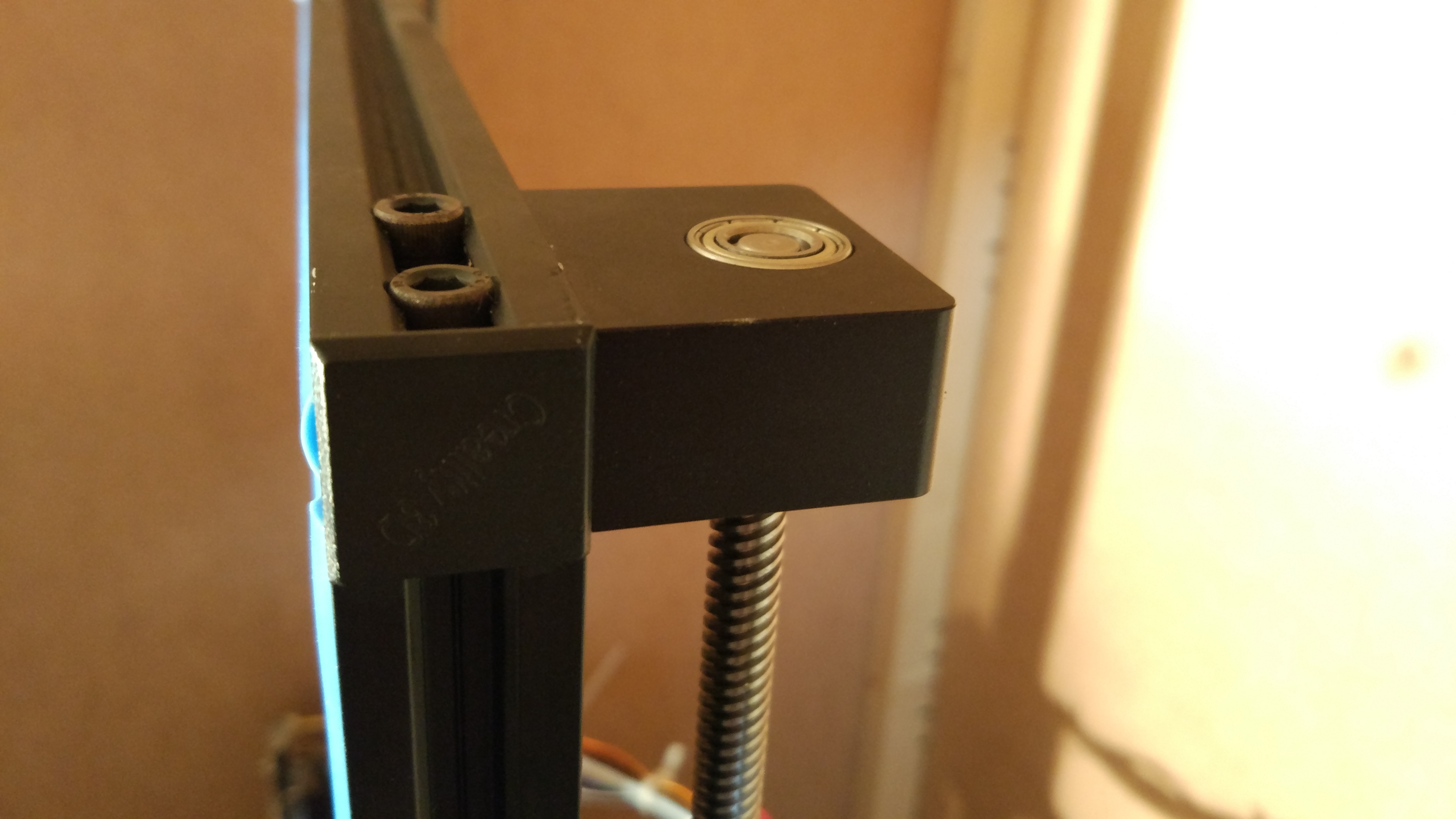

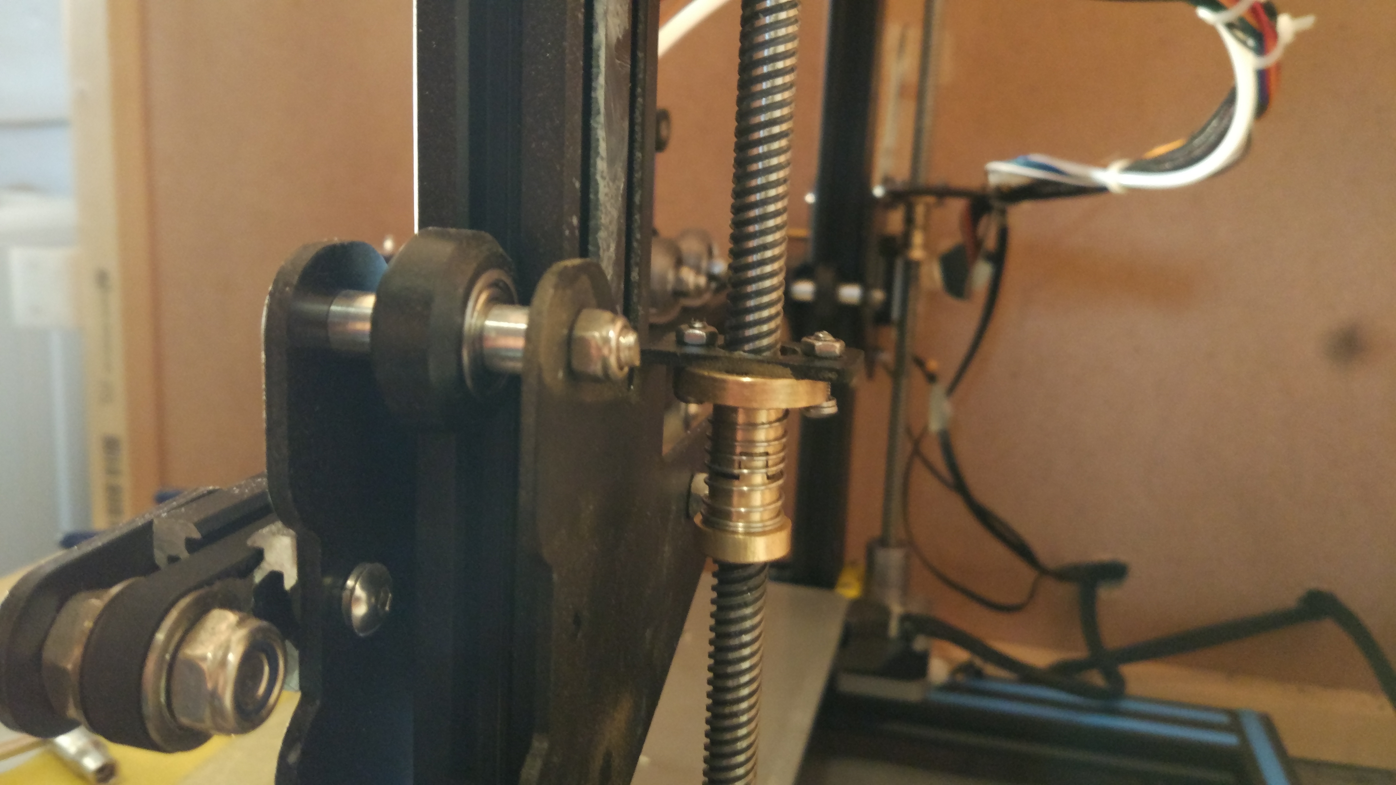

I also added the antibacklash nuts since the Z axis is way heavier now. Also replace the Z plate with aluminium one and snug fit bearings.

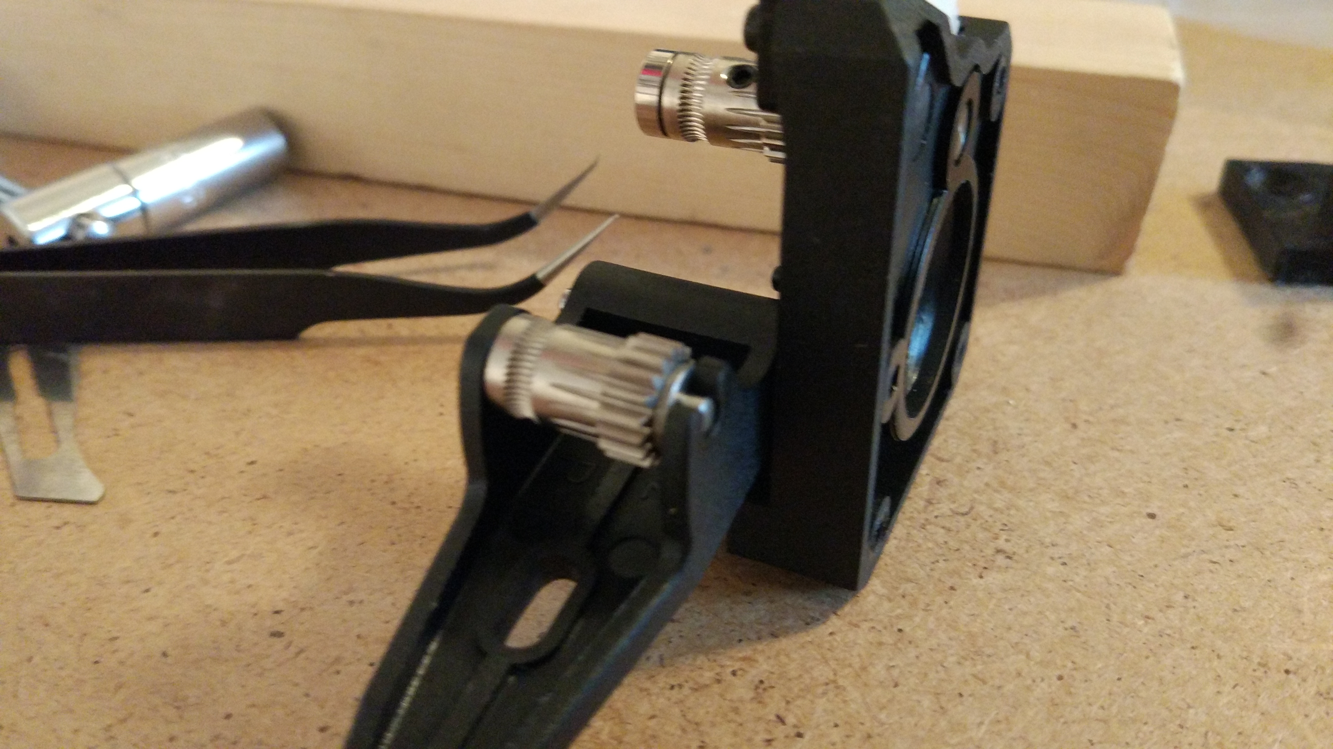

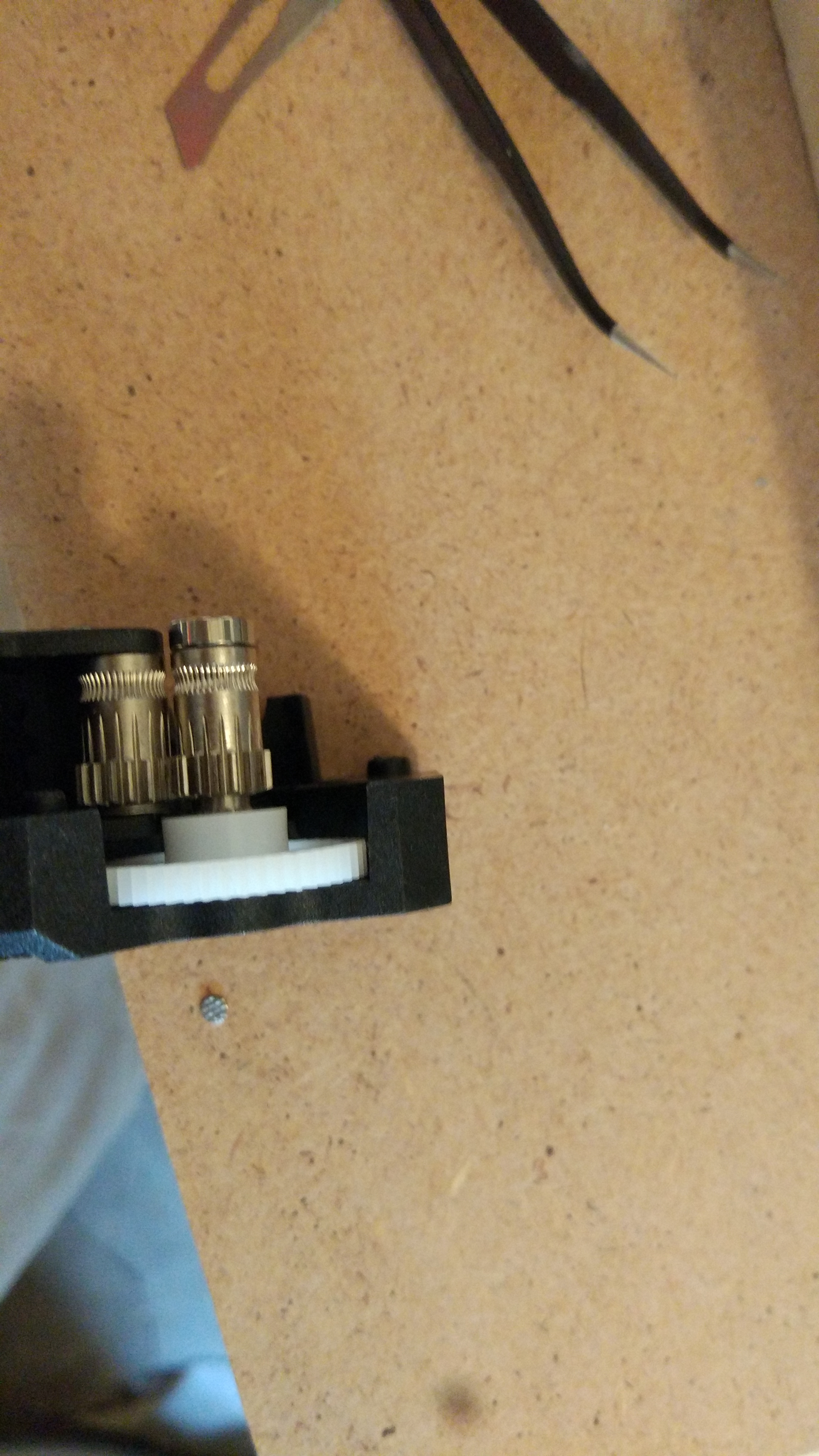

Ah one thing I notice for the bmg. One of the filament gear guide had quite some play and could slide back and forth for like 2 mm loosing the alignment with the front gear and filament. So I placed 2 C-clips to hold it in place.
That’s normal. Both BMGs I got from Trianglelab had that. When inserting the filament the second gear moves to it’s place by itself.
Just set it to 415 and leave it. It is worth it to check that it is correct by extruding a specific amount of filament. Mine was perfect.
Also you might want to install the anti backlash nuts flipped up, as now they actually would have a negative effect compared to normal nuts. The gantry is heavy, so at all times the nut is pushed down and it uses the bottom side of the threads. This is fine when using a normal nut, as it is always engaged with the same side of the threat on the leadscrew. In your case, the spring is actually pushing it up, so it might cause the nut that’s connected to the gantry to sometimes not touch the bottom of the thread causing inconsistent lines. If you flip it around, then the spring will push it down which will make it better. However you might not notice the effects in real use as the spring on these is pretty weak. This is pretty hard to explain, so let me know if I didn’t explain that clear enough.
I understood what you mean. I watched a YouTube video that had them installed in this way and was showing how it prevents the Z to drops lower than aspected. I will try and if I see some lines skipped on the Z I will correct it.
Thanks for all the info and the mount is pretty solid. I will post where the parts didn’t matched but basically is the V6 pocket once installed to the bmg that has to be shifted about 2mm towards the bltouch. To understand the direction.
Where did you get the anti backslash nut?

[9,38€]5pcs Geekcreit® T8 Anti-Backlash Spring Loaded Nut For 8mm Acme Threaded Rod Lead Screws 3D Printer & Supplies from Electronics on banggood.com
https://banggood.app.link/Zfm0KoEMvY
