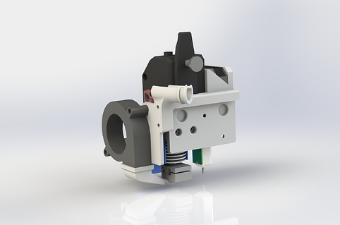

I use my own bracket. The shape is similar to one I found on thingiverse, but didn’t use it as it didn’t fit correctly. So I designed mine from scratch and added more features. Using the ender 3 original CAD files, I made sure the nozzle position is same as before.

Neat! Mind sharing step files for it? Btw what app are you using for the 3D models? They are pretty.

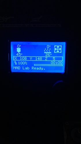

Software wise everything seems fine. Calibrated the Z. Probing works just fine. As test I will try the new extruder with some prints.
The files are shared in the very first post. BTW, do you have m3 inserts? For bltouch and the fan holder/cable guide. I use 4 screws in all. Either they can screw into plastic or into inserts. It’s just the hole diameter that will be different in the model.
I use Solidworks.

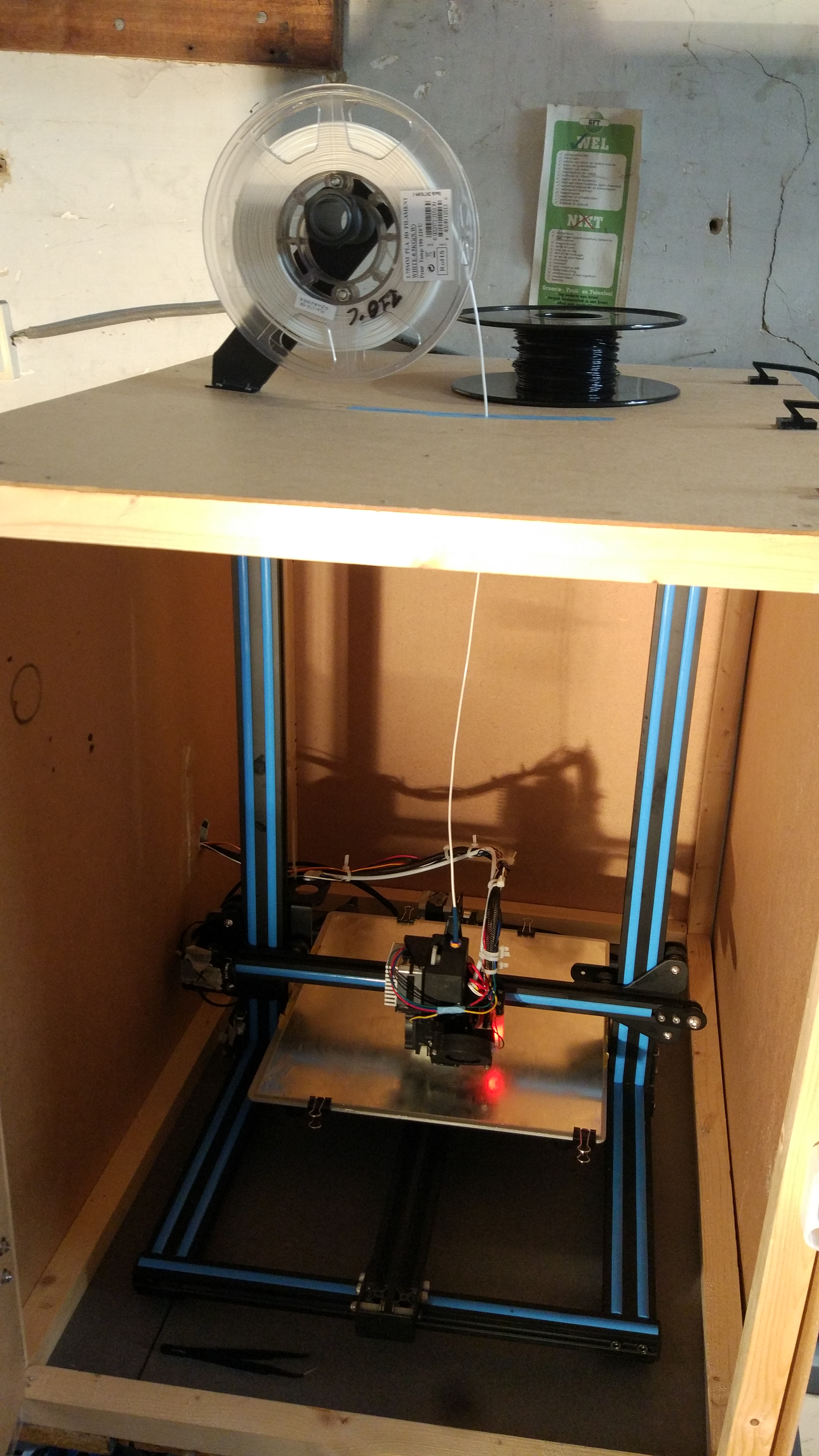

Yeh now at work. I finished to mount the spool holder on top. After I will try to check calibration and print something.

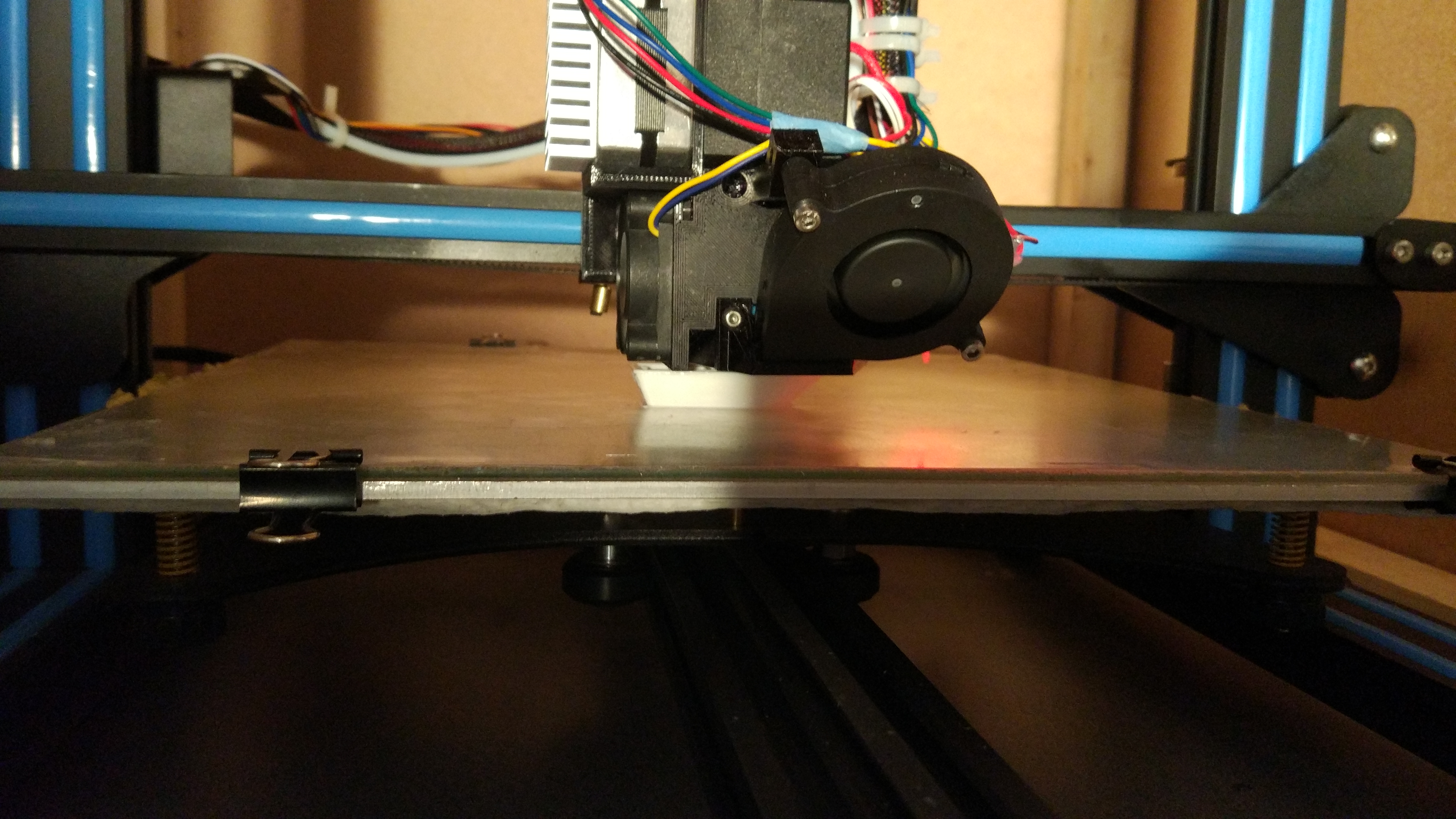

At the end couldn’t resist. Came back home for lunch and calibration is perfect as it is. Unbelievable.

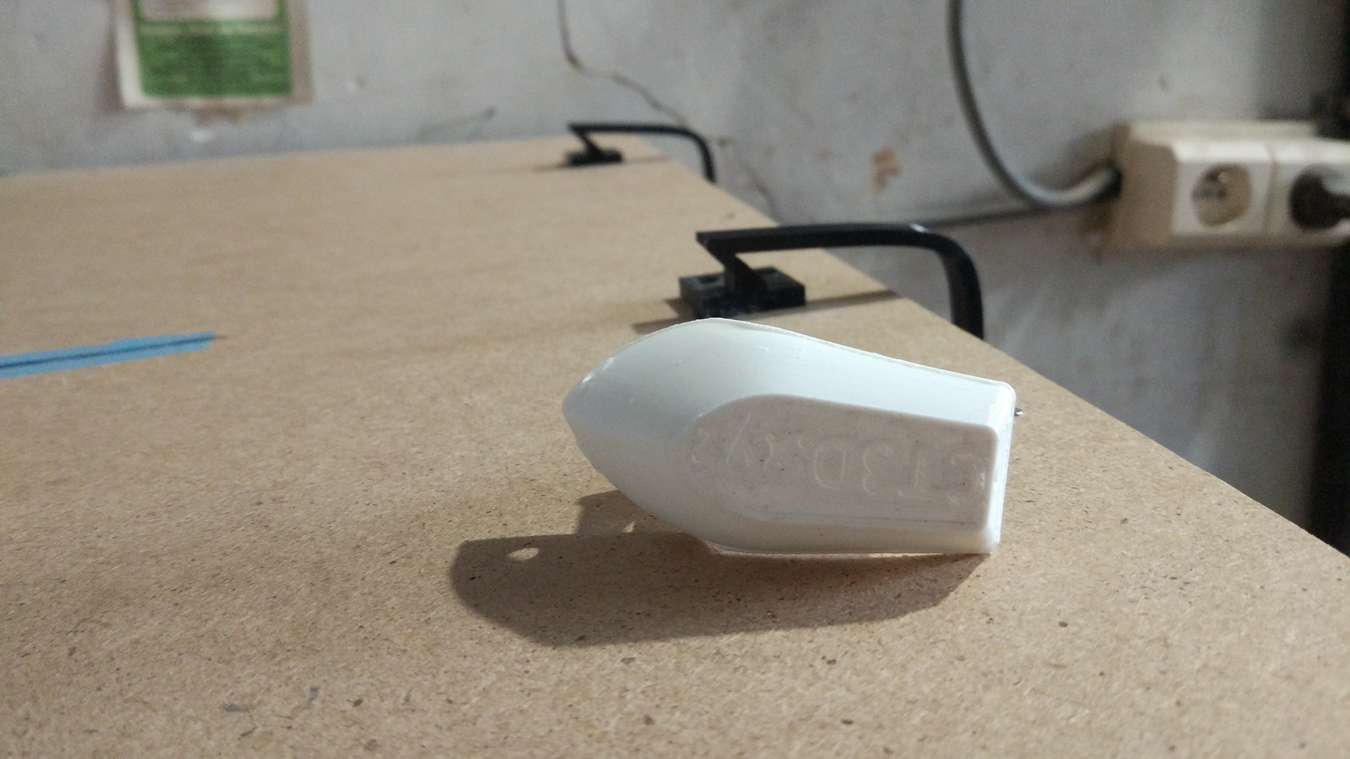

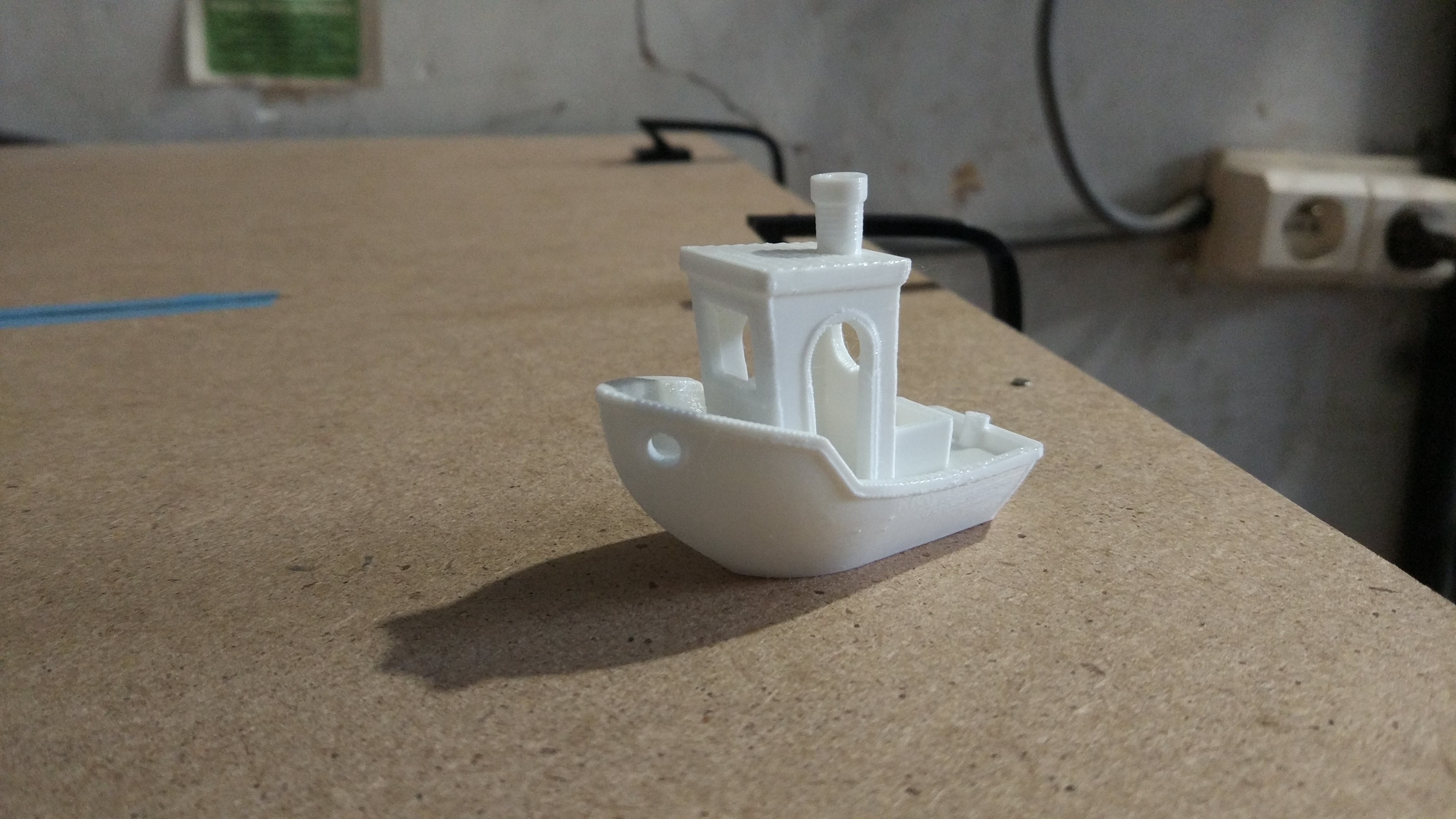

First print on going…
0.2mm 8%infill 3 walls. Not bad

If you already have direct drive made then is literally 1 hour of work to instal the probe. Between the different probes is the best to me because is phycally mapping the surface. So you can change the build plate and just press print. You add G29 in the gcode initial script and it runs it automatically.
