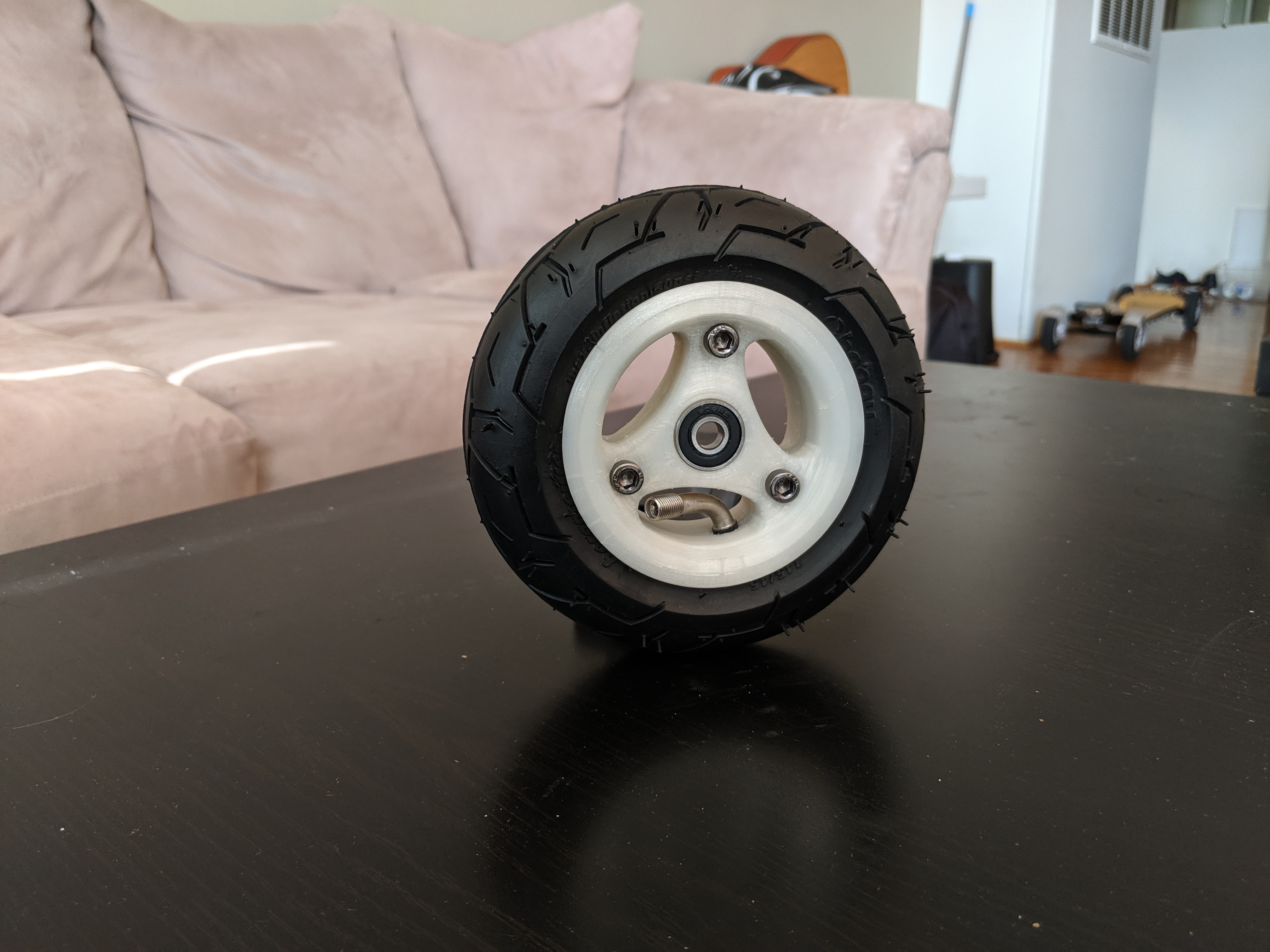

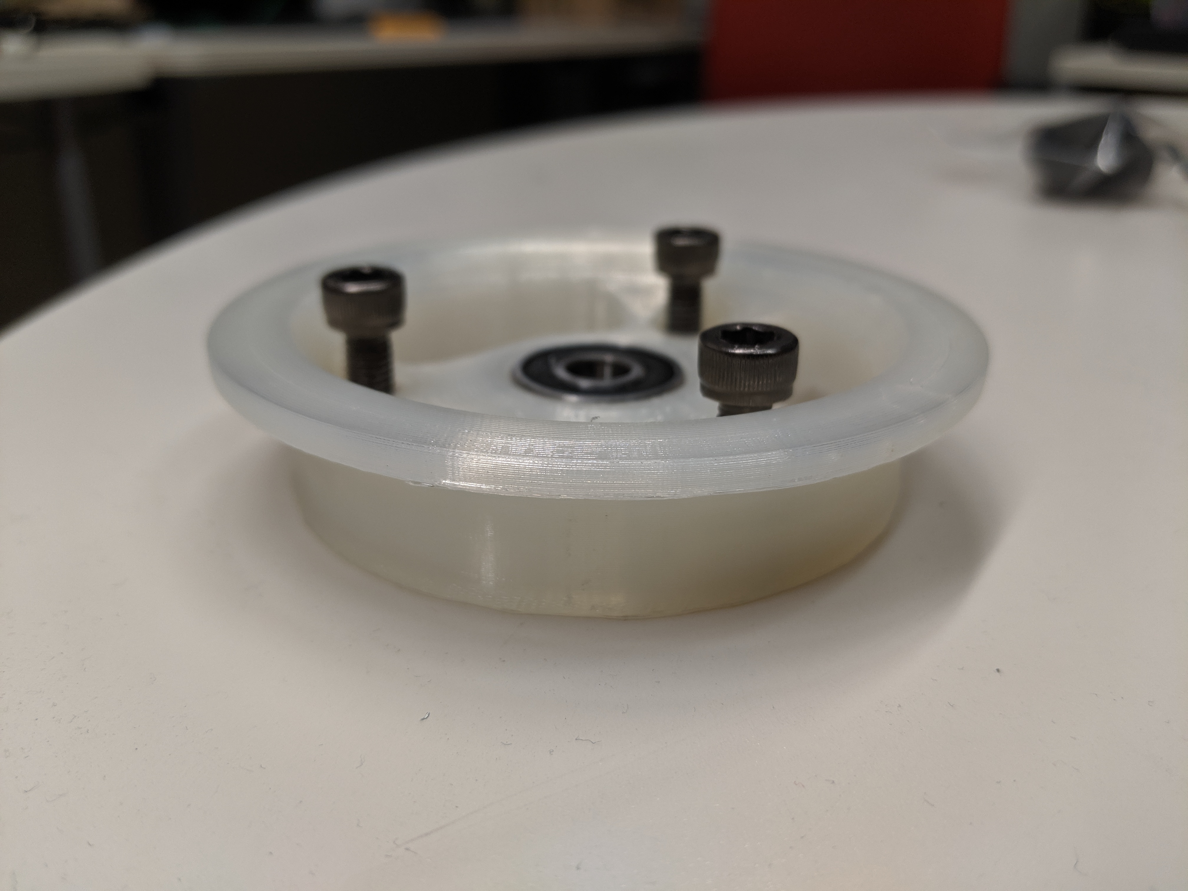

Really nice hubs. Now it should last for a while!

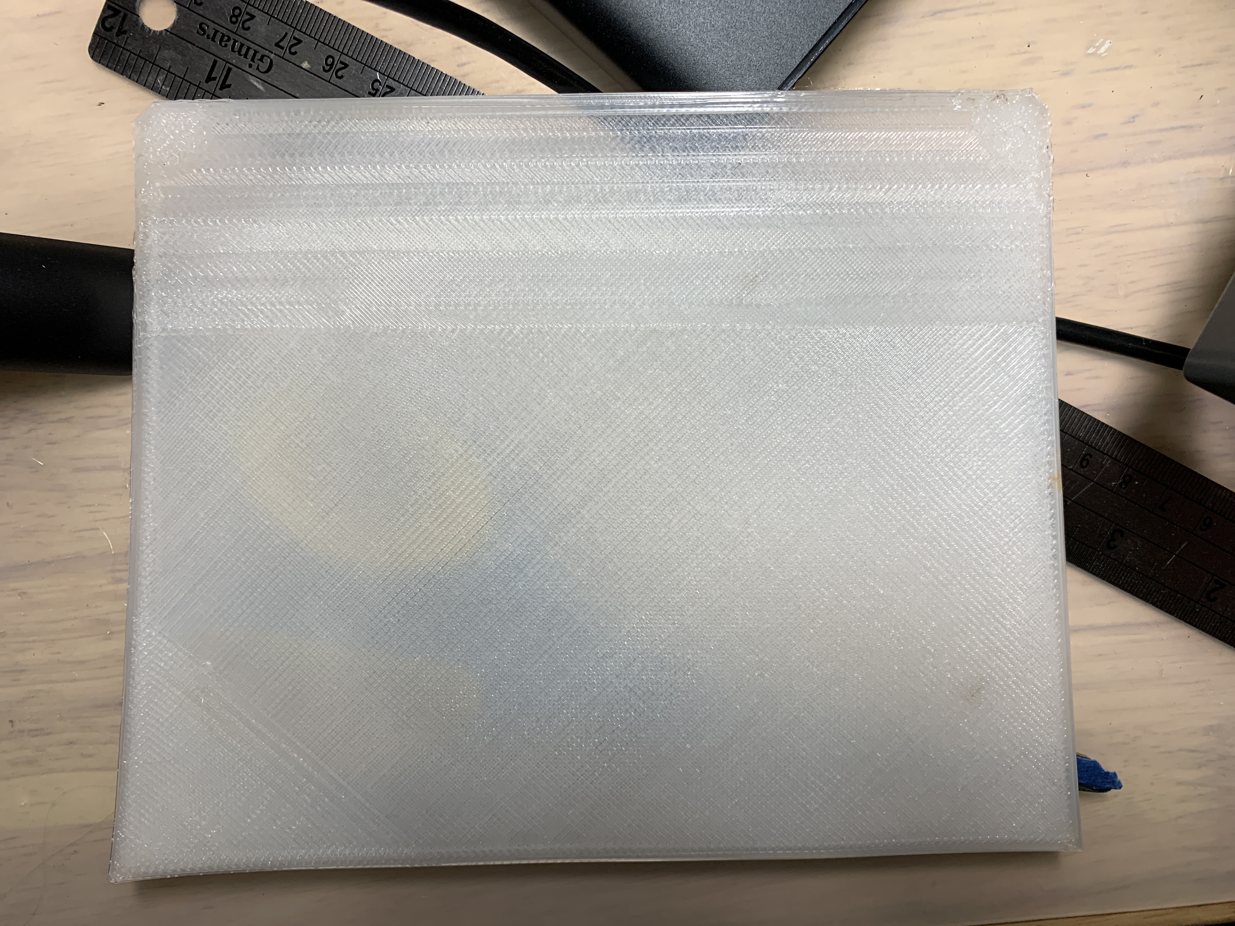

Here a sample of the print
I still do the first layer at 40mm
I keep the bed temp of 60ish for the first layer so the glue and the line fuse better … yeah I don’t think makes the difference
The others I either turn the bed off or leave at 40ish

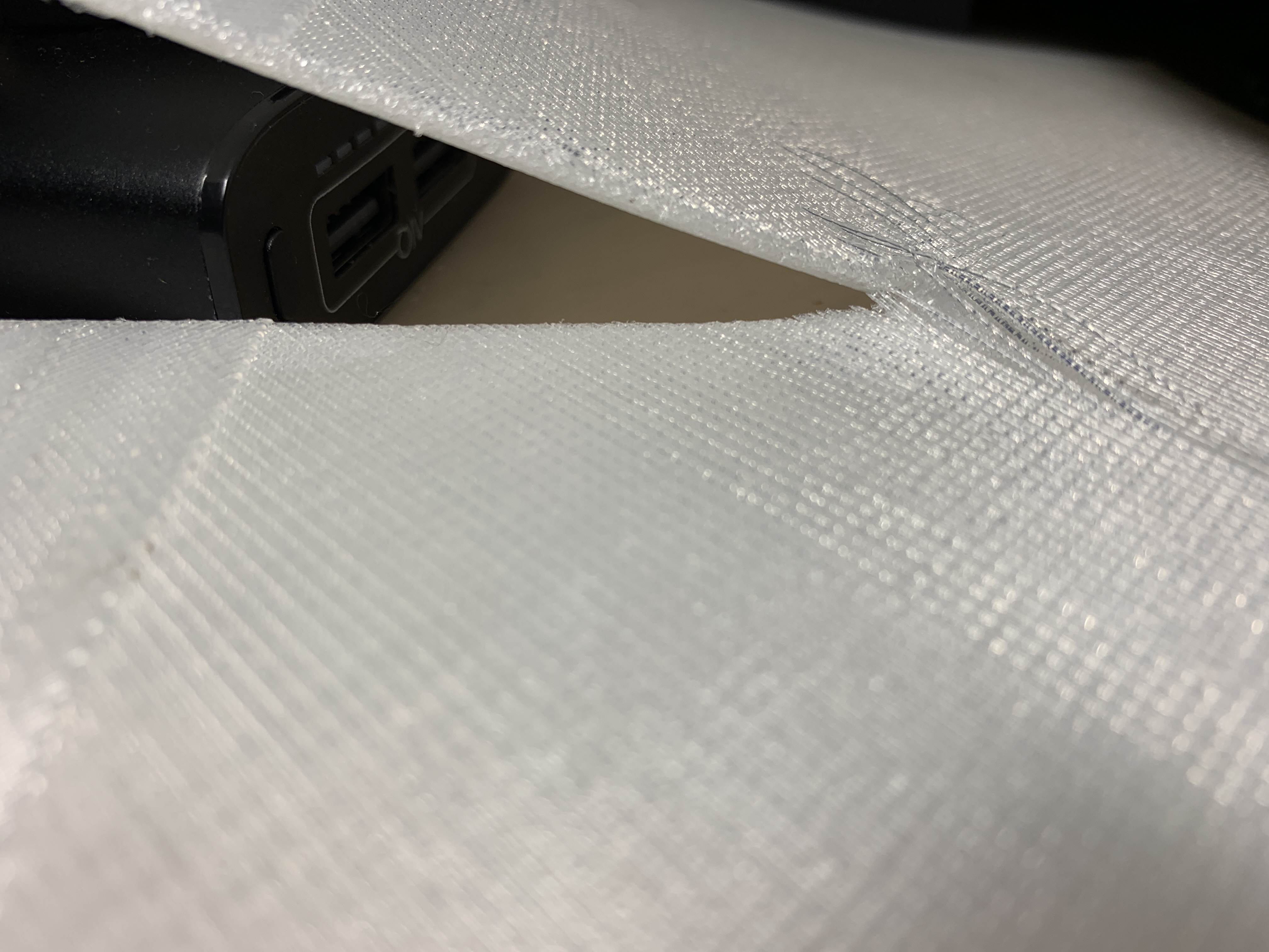

Here a pic of the 2mm sheet ripped with a cutter then tried by hand:
Looking at the fibers separating, it doesn’t seem the layers have bonded nicely. You should print a hollow cube with 4-5 perimenters and try to break it. It will give a good indication of where the problem lies. For adjacent layer adhesion problem, I would suggest to increase flow%(cura).
BTW, everyone. Alloy 910 is available at amazon for $30 with free shipping for amazon prime. I think I paid $40 from matterhacker before.
I’m experimenting with different speed and temperatures. I’ll try to print the cube tomorrow but I decreased a bit the speed to 60mm and now layers bond much better.
