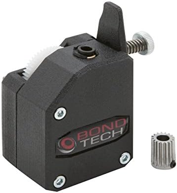

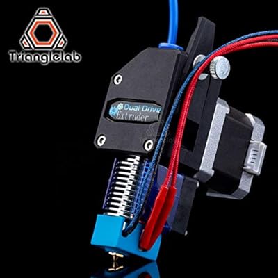

100% go direct drive - triangle labs bondtech copy. The hardest part is rewiring a pancake stepper but you can run the stock extruder stepper of if you dont want to fork the extra cash. Just a lot more wieght.
@rey8801 I havenā€™t had any problems with the brass but they are the triangle labs ones too haha :man_shrugging:
I suggest everyone to look on YouTube. There are a lot of bontech, trianglelab bmg upgrade. Both bowden and direct drive. Pretty well documented.
Direct drive alone with bmg extruder can be run on normal stock firmware. You need to change the extruder steps as @mishrasubhransu suggested. While if you want to install some auto leveling sensor then you need to flash marlin. Not difficult to do it but for sure more tricky then simple bmg conversion.

You have to extend the 4 wires to the extruder and thatā€™s it. I have added connectors to all the parts on my carriage, so I can easily replace a part if it gets faulty withough having to splice and solder wires every time.

If you want tinglelab costs a bit more then from Ali but you get the V6 too

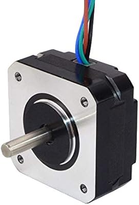

The only thing missing is the pancake stepper motor nema 17. Link

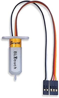

I already have BLTouch. Guys, buy it Directly from creality, the others that are around needs a bunch of fixes on the firmware. Iā€™ve done them, but took quite a bit to get it right.
Thank guys for the links!
OS with the one from Creality was just plug nad play and maybe flas ha creality firmware? Do you have a link? If I can avoid to mess up with Marlin I will be happy of that.
