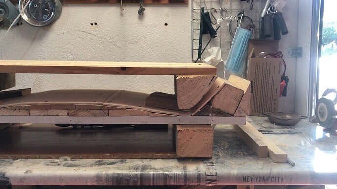

The first mountainboard I built was for my brother-in-law and the cheapo deck we used was by far the worst thing on it. He decided to try his hand at creating a mould (that honestly I didn’t think would work for maple) but…
…he definitely proved me wrong. The first board to come out of it would be for my GF, who had tried his and loved it.
The deck is a lot shorter (80cm tip to tip) than a typical mountainboard and has pretty radical curves, with the intent being 55 degrees. Even though the wood didn’t fully get them, we measured it to almost 50 degrees which I still think is pretty impressive. Makes the board a hybrid between a carver and a mountainboard, but still has enough ground clearance for offroading. We had to get the wood wet and we let it sit for a week after gluing. When we got it out of the mold, weird things started to happen:
Several layers split longitudinally, but overall it looked solid enough so we went for a jump test…aaaand it failed after 10 or so jumps. The failure, however, was not around the cracked veneers but simply several layers around the center delaminated. This event lead to my GF naming it “Pan the pita”, which is spanish for pita bread ![]()
Fortunately, separation was clean (7 layers on top, 3 on the bottom) and clearly due to lack of glue…so we reglued and again let it sit.
This time, it passed with flying colors! Time to fill cracks with epoxy, cut, and sand the hell out of it:
