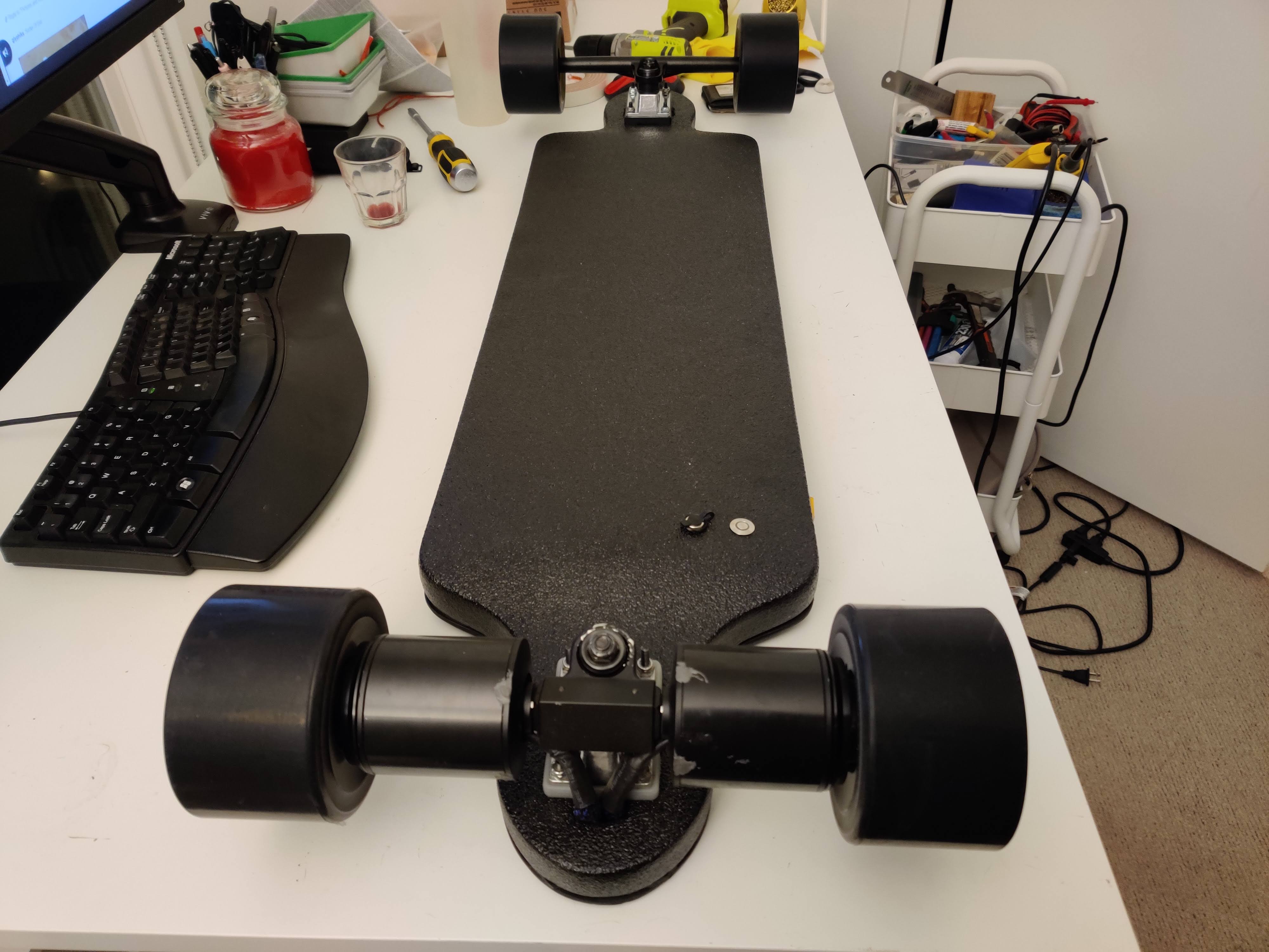

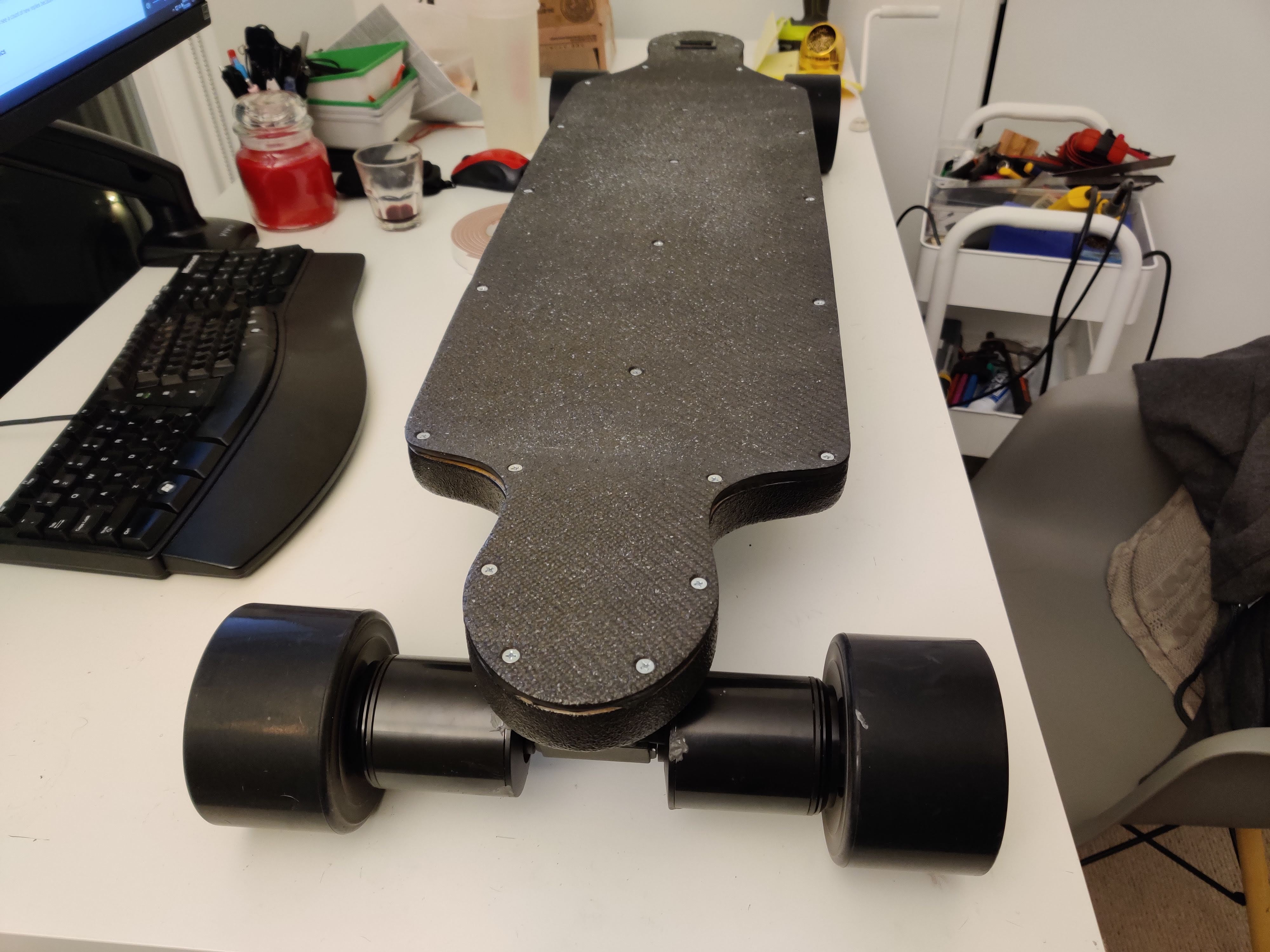

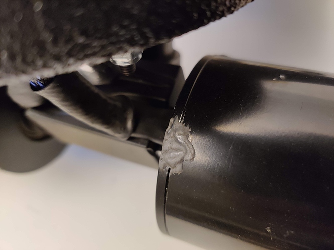

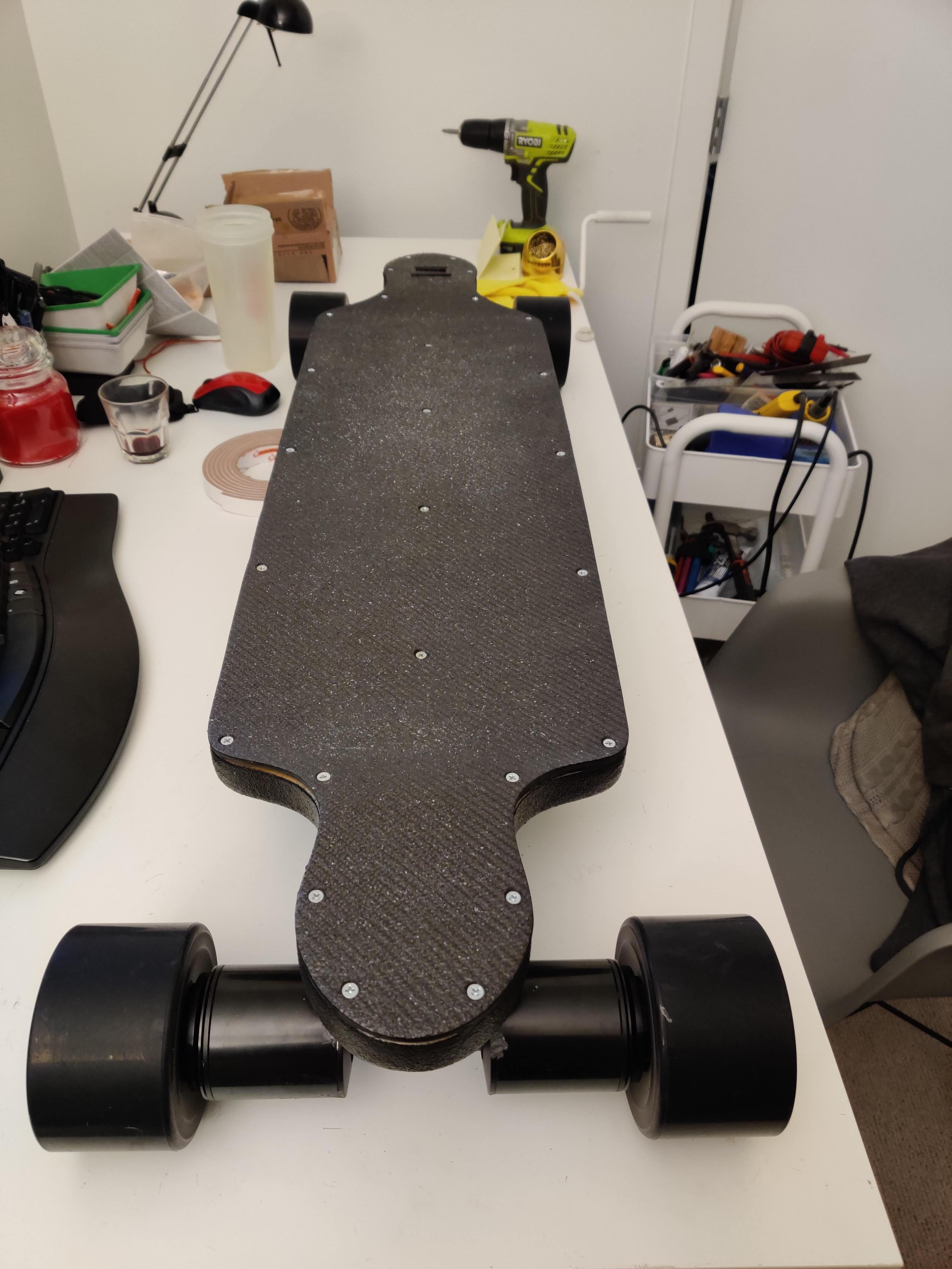

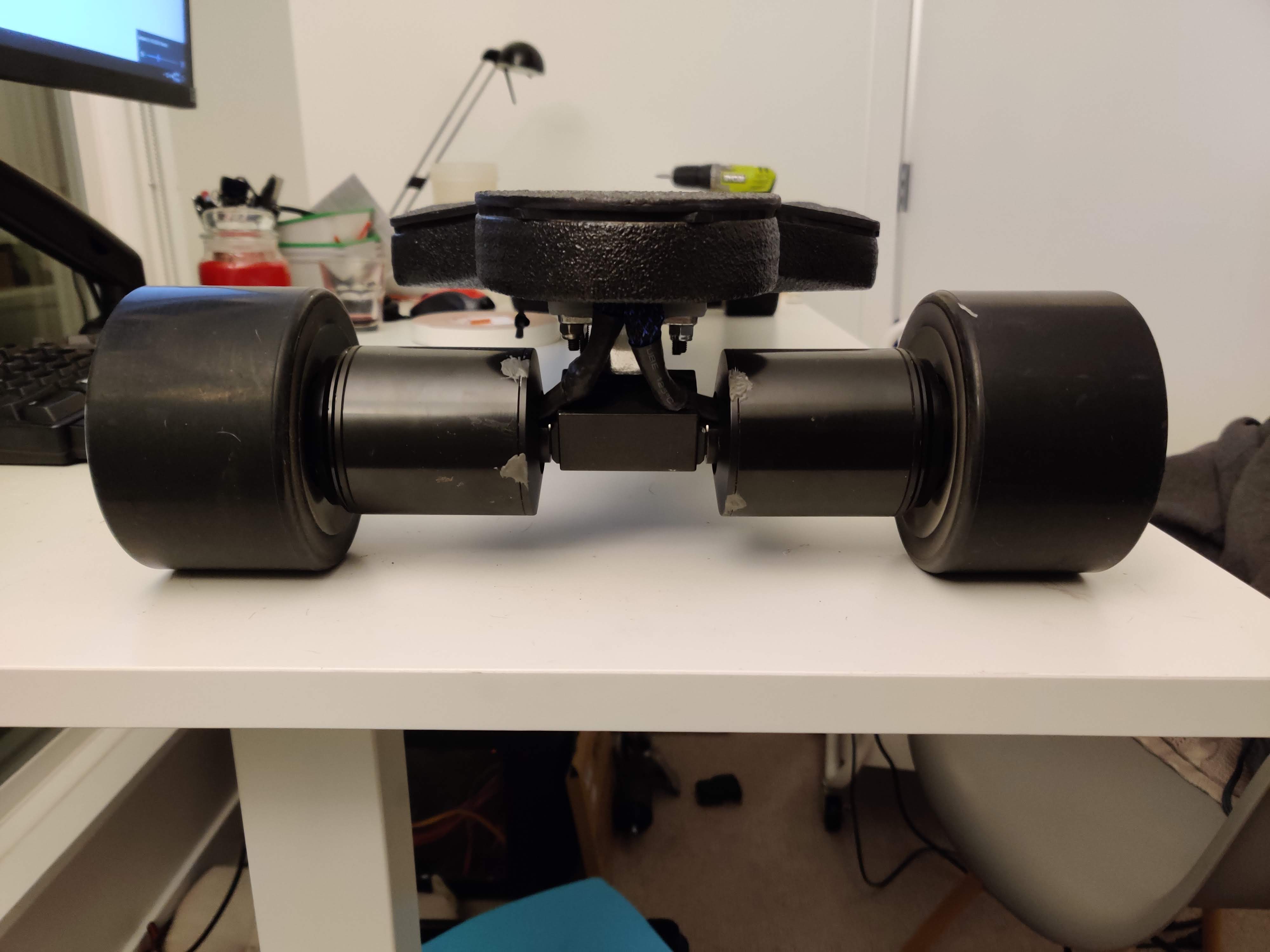

i didn’t get replacement motors from kenna, with the can screws to prevent it from coming loose. so instead drilled tiny divots where it unscrews with a drill, and filled it with jb weld. this stuff holds engine blocks together so hoping it’ll keep the cans from coming loose.
used a rocket deck skinned in line-x and lid skinned by @Sender. it’s almost murdered out, kind of like the look of it, except i’m afraid how hot it’s gonna get during summer.
