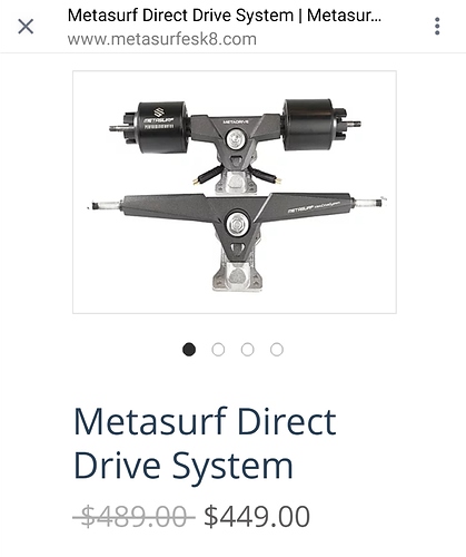

Those metasurf have one thing I like : short motors!
The much too wide axles is the only thing I don’t like about the eloftys. (apart from their overall crappyness of course :joy:)
You say that like it’s a bad thing.
