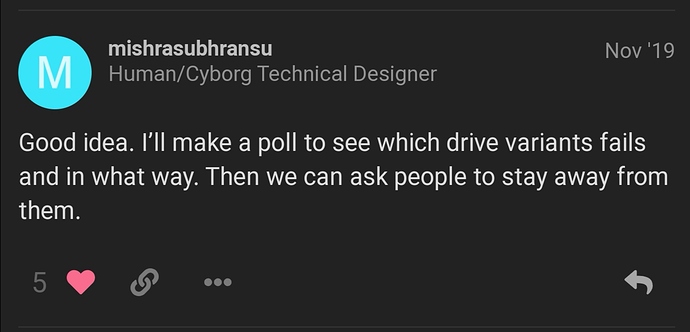

I’m sure @mishrasubhransu is almost finished with his budget DD variant thread.
Umm, what? What was I supposed to do?
I only somewhat remembered it correctly. Still claiming as a win.
Oh wow! I totally forgot about it. I’ll get to it today, hopefully.
