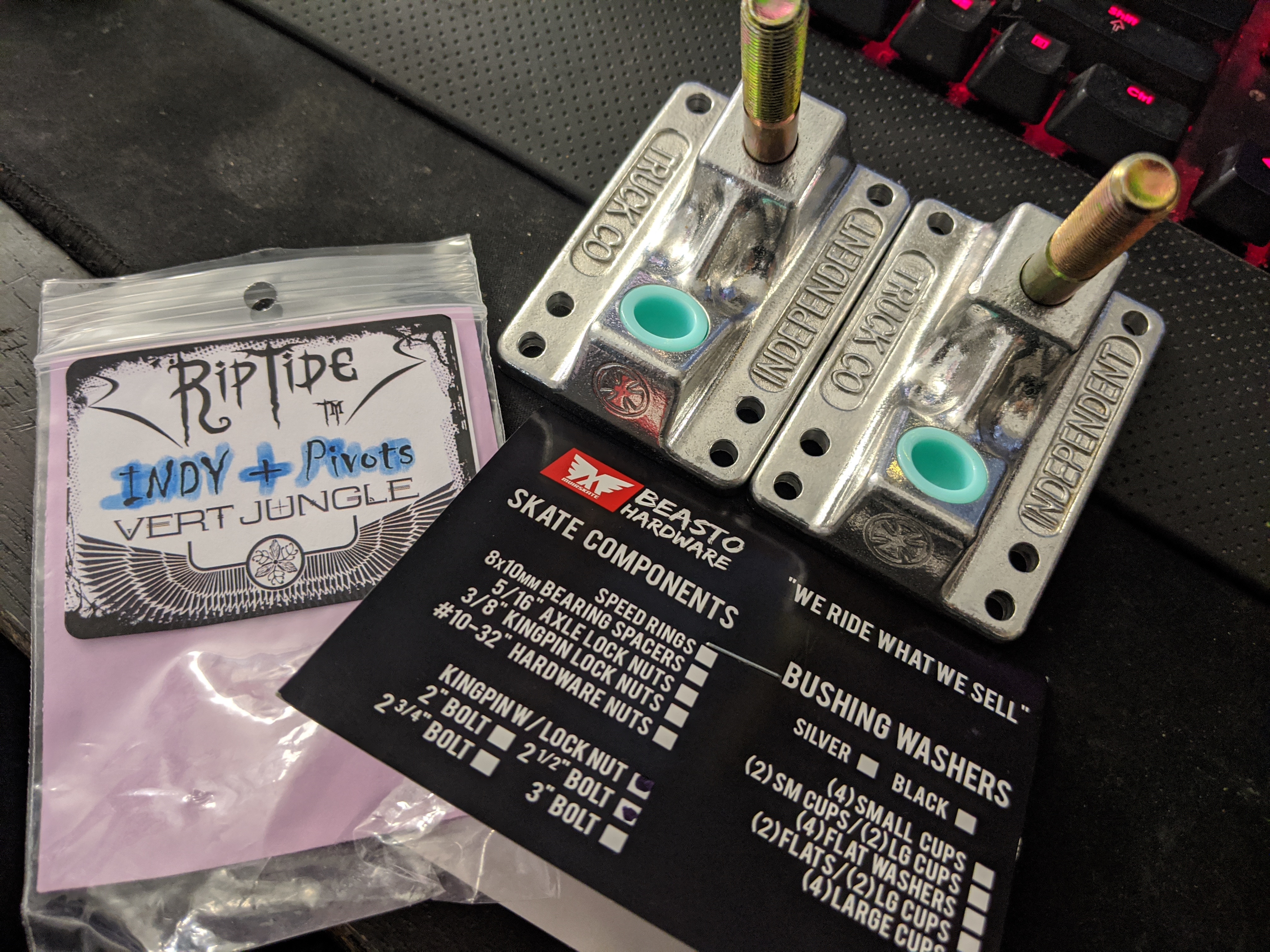

Got the base plates in. Swapped the kingpin and put some Riptide Pivots in them. Drives should be here Friday!

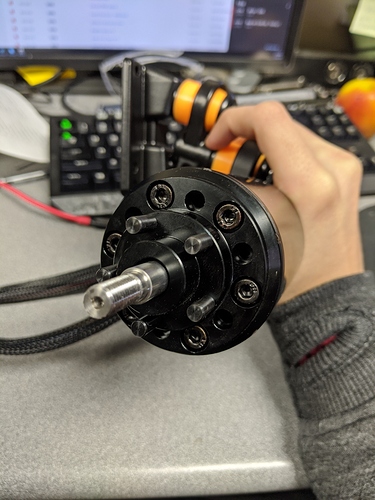

I got the drives today somehow. Dhl changed the shipping from Friday to today. Anyhow theses things are dense!

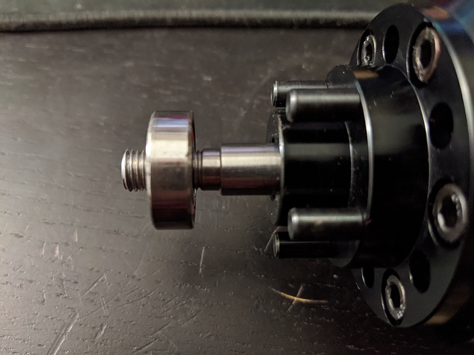

  1. I noticed that a regular skate bearing isn’t able to sit flush on the axle. It ends up sitting half on solid axle and half on threads. That’s not really a huge deal but thought I’d mention it.

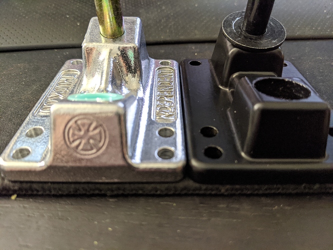

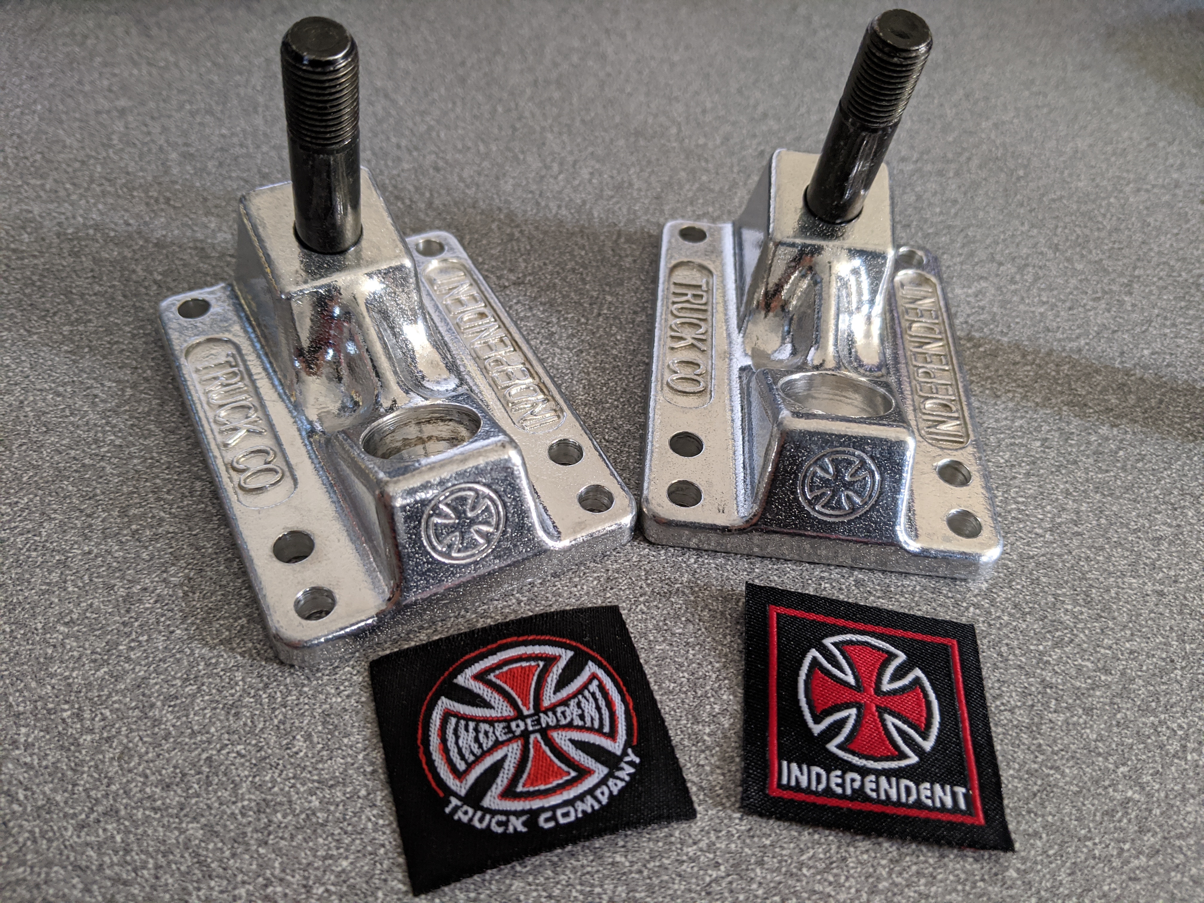

  2. Also my freaking Indy baseplates don’t fit :sob::sob::sob:.
    Seems they’re slightly different.
Bearings not sitting flat could cause premature failure. Should be a problem in theory but in practice, it’ll be interesting to see if it causes any issues.
Do the base plates not fit because of angles?
The bearings should not be a problem, have you tried putting some wheels on it yet?
Are the indy baseplates for single kingpins? the angle seems different

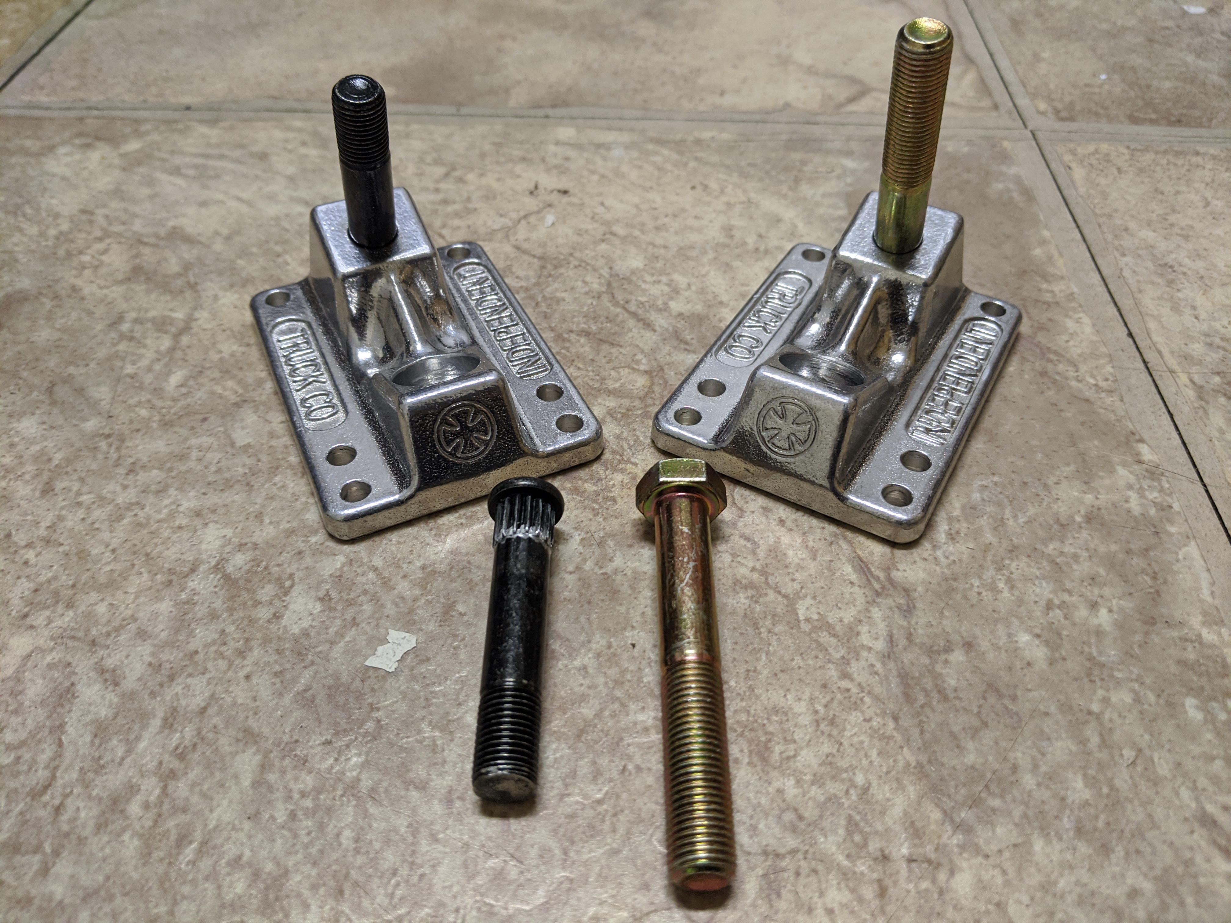

Yeah the angles are wrong. I could just hammer the kingpin out of the elofty baseplate and swap them. However after looking at this i’m not sure if I’d be able to mount these drop through in TKP config on a hummie deck. I’d have to bottom mount if I wanted to run TKP.
@ThermalChild - yeah with TKP I needed a small riser
Yeah no drop though on TKP for sure. Try the double kingpin if you want to drop though. Just make the rear truck as tight as possible and have the front looser. That way you will be able to carve and don’t have speed wobbles
I’m probably gonna run DKP even though I don’t want to. Mainly because I need to buy twice the amount of bushings and pivot cups. Also the fact that the kingpin is smaller kinda limits being able to use full size bushings. Depending on the top speed DKP may not be an issue.
whats wrong with using the original DD baseplates and taking out the ā€œmiddleā€ piece?
Asides from looks, it’s a baseplate that riptide specifically makes a pivot cup for. From what I understood of people telling me it should have fit but doesn’t.

I’ll post more when I get home. Fitted my 85mm otangs on them quickly yesterday. Required a bit of oomph. It’s weird though. You only use one bearing and the axle is stepped to the size of a bearing spacer and then it kinda slides into the bearing seat of the wheel.
Interesting! Having one of the wheel bearings replaced will make the bearing not sitting flush less of an issue.
I wonder if you can open up the can to replace the bearing however. Hopefully!
