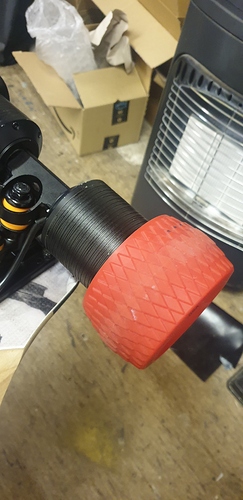

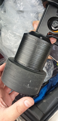

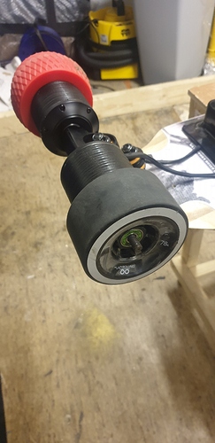

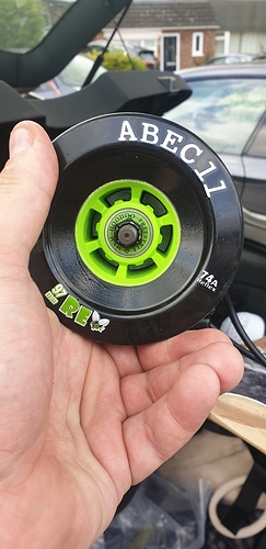

I’m about to see @Lee_Wright and test fit the new adaptor he has designed. I finally got the motors on the deck, added bullets and sorted the sensor wires, run detection. All looking good so far
Do the mbs and SR wheels have a genuine abec core or the clone core? Thats what I’m asking. I do it have a working clone core adapter yet :confused:
the MBS ones have a non-clone core, different to the cheap clone ones anyway
MBS and Slick rev will not fit my adaptor, im working on one though

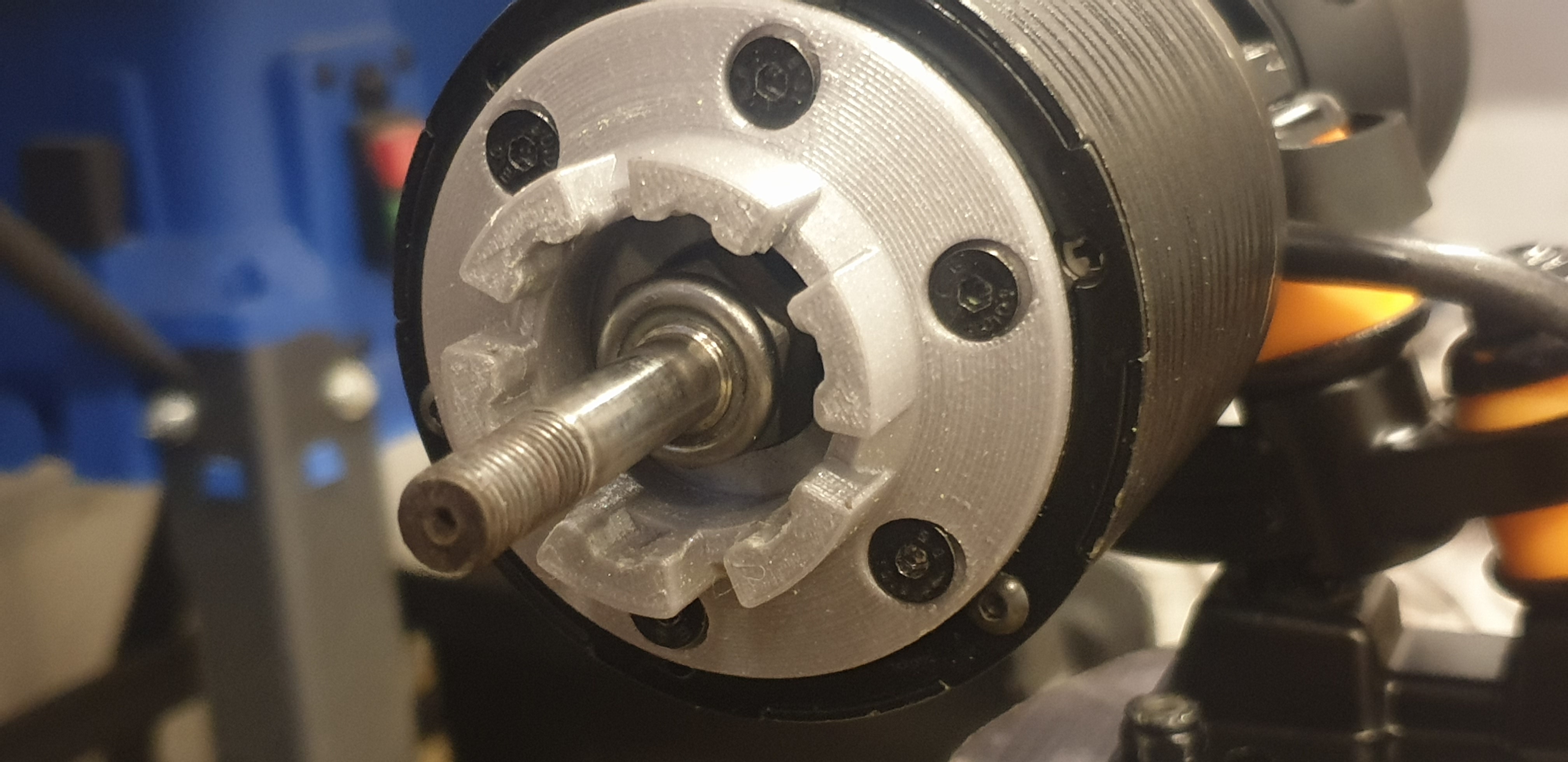

I have to make one small change and then its final! They fit beautifully on @Tonkatron board and keep the inside bearing on the wheel against the nut on the axel and we have ridden the board with them on. I just have to make the spokes 4mm taller.
I will offer to the group the adaptors printed in 100% Nylon for $20 plus postage, let me know if you want a set.
In case you want to print your own the final design is here
Ok So I tried SR and ABEC clone and they dont fit yet, but I can make them fit tonight. The spokes are a little too loose, if you hold the motor tou can move the wheel slightly left and right. Easily sorted later.
Try this one bro
The adaptors fit really well and @Lee_Wright has done a fantastic job designing them. We did a test fit and then had a very quick ride up and down the street. My motors are running great and once I have some new adaptors printed I will get some miles on them and report back.

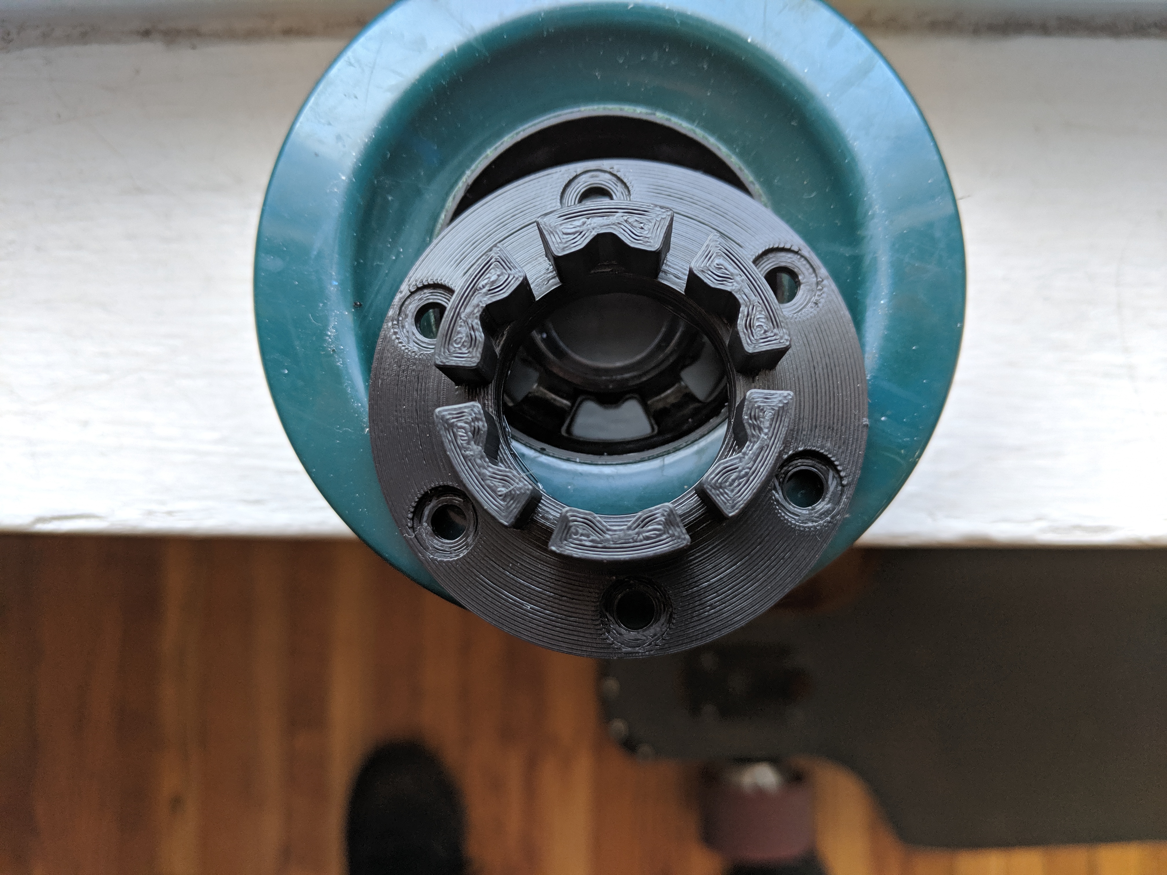

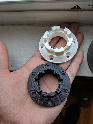

The clone adapter does not fit clones wheels unfortunately. The prongs are not the correct shape/size
Thanks for checking man, they seemed like they would fit the SR wheel I had to test with. If you can get me accurate measurements I can make it, but I’m shooting blind without that measurement
This other one I have from thingiverse actually fits. It just doesn’t fit the screw holes on the drives
So what I really need is these prongs on your baseplate
