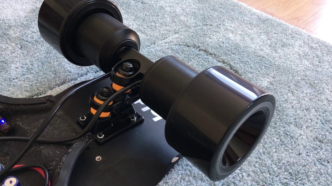

Looks clean. What wheels?
Chinese 97. Feel good but not great.

How does the traction control help when testing on a bench with no load? I have two other boards with both sensored and unsensored motors and it never happened to me there. I repeated the motor detection a few times and the problem seems to have disappeared now. I’m now getting some weird sound in one of the motors though. :roll_eyes: This thing is never ending trouble.
I don’t know how it happens but I have seen that behavior plenty of times(on my belt drive board with TB motors) when I used to have shared ppm. Once I shifted to CAN+traction control, I have not seen it.
BTW, did the off axis problem get resolved though? If not, then have some serious QC issues with these new drives.
What does it sound like? bearing issue, loose magnet? BTW, since you see into the drive by opening the adapter, you can probably check if it’s a loose magnet. I am curious to see what it looks like inside.
I went up the driveway once on them then put my 107s on haha
Yes, I managed to center it. The mounting holes are slightly larger than the bolts so there’s some wiggle room.
Here’s a vid. Sounds like the motor is rubbing against the hanger? It’s only in low RPM. Maybe this is only a problem on the bench. I did a quick test ride in the garage and don’t remember hearing the sound while riding.
Interesting! What firmware are you using?
I believe it’s 3.48. Do you think it has to do with FW?
I was wondering if it sounded like cogging.
If it would be cogging the motors where running in different directions randomly or stuttering at startup. But I would also guess it’s hall sensor or phase wire related.
@janpom have you tried switching phase wires on the strange sounding motor and do a detection again?
I did repeat the motor detection a few times. The sound is the same for both motors.
