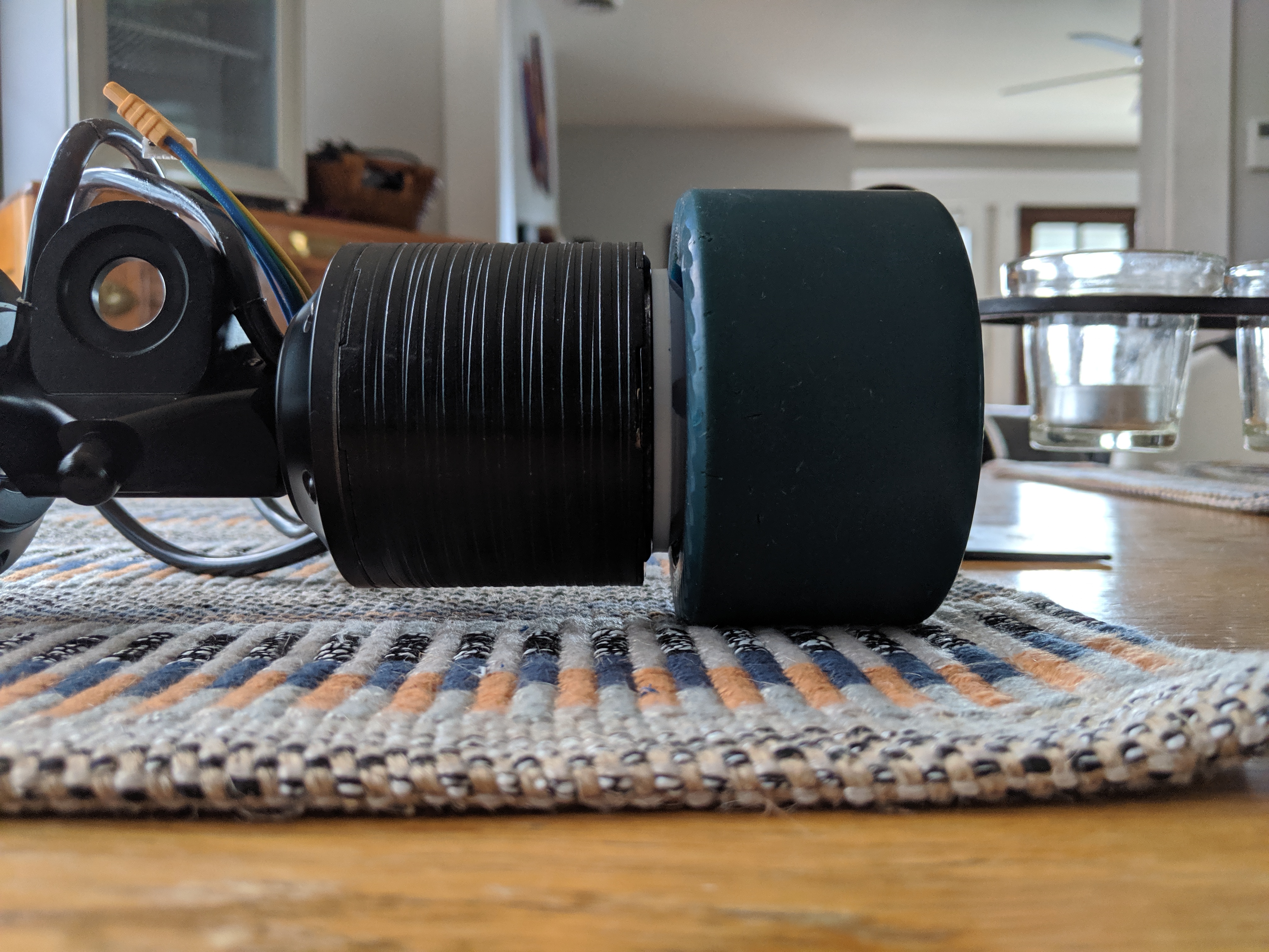

I would say they won’t fit clones
Man… I feel bad for anyone that ordered those 90mm wheels and gets them with these new drives… Dat clearance lol
That’s quite low.

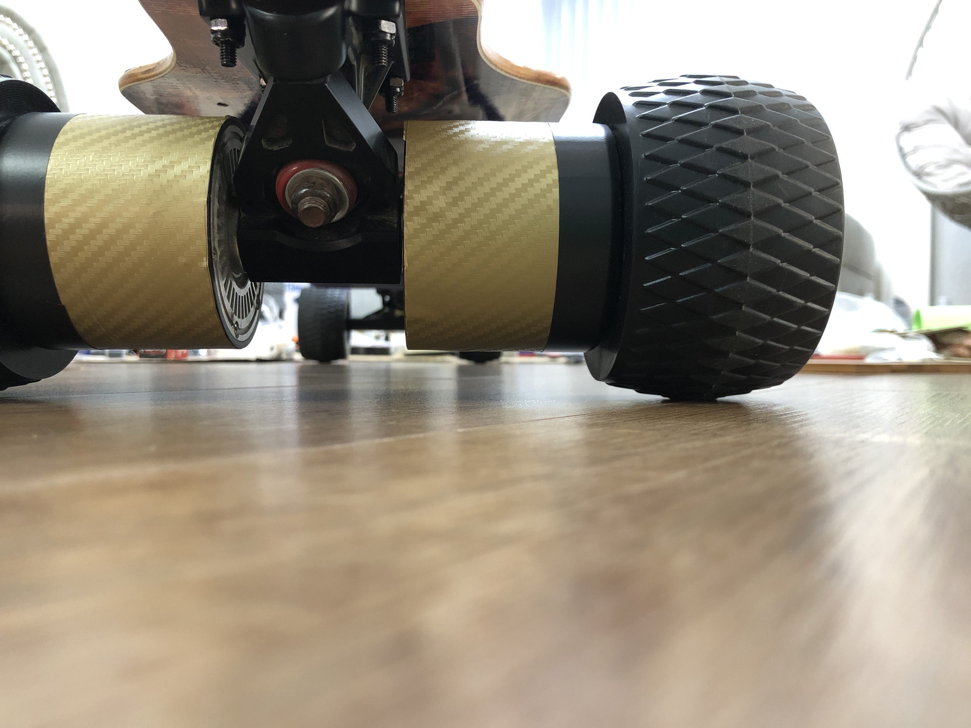

These are my carvons on 110mm wheels
@Lee_Wright those are the new 78a rough stuff wheels btw. Noticeably softer that the 85a. Not abec soft but pretty damn good

@Lee_Wright yep! These fit my drives perfectly, but they indeed do not fit clones.

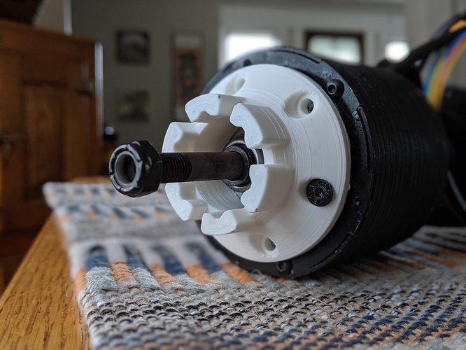

I made some improvements to the adaptor now @ryansinatra. I have V2 up now which includes a bearing press for the inner wheel bearing, less of a slope to better fit ABEC wheel cores and a slightly refined spoke design.
I can make you a clone version if you like, just need to get the profile for the clones. Give me a little time

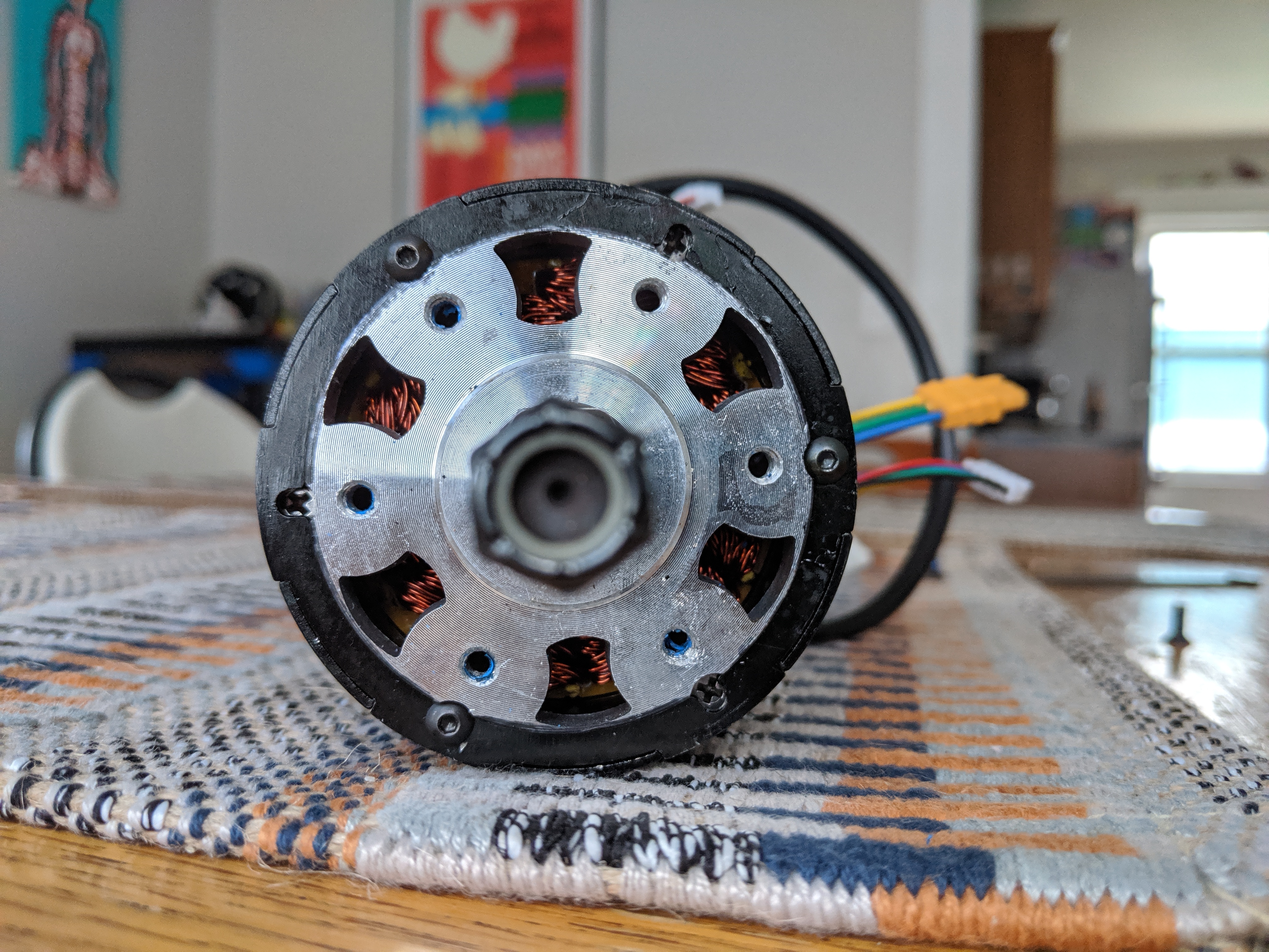

Edit, shit I just realised I have to further refine my design. Can you take a picture of the end of the drive for me without the adaptor?
if anyone has a document showing the profile of the clone ABEC shape I would appreciate it!
Can you give me that nut height? the one nearest to drive. Height from drive to end of nut please. I need to see where the bearing needs to sit
I don’t have calipers at the moment :confused:
its ok, @Tonkatron is on it for me. If someone gives me the ABEC profile I will make you another adaptor.
even a high def photo of the top down on a clone pulley with a ruler in shot would do
I have 2 chief concerns. The drives can get up to 80 degree Celsius. How is the 3D printed part going to handle that?
Does the 3D printed part increase the chance of water and dirt going in through the holes?
I honestly like the previous design better. The one that I have.
80C is nothing for the right filament. Its under 50% of the glass temp of Nylon, PC, PET etc.
it wont increase the chances of water ingress over the metal kegel version that ships with it.
The 3d print version is a road to getting some made in Alu really.

Here’s how one of my Kegel adapters arrived. Completely out of center:
I was scratching my head why it’s so hard to put the wheels on. Well, this explains it.
Also, why they used countersunk head bolts where clearly flat head should have been used is beyond me. :roll_eyes:
I stripped two bolts when trying to undo them so that I can align the adapter. I had to file a groove so that I could remove them with a flat screwdriver. :angry:
