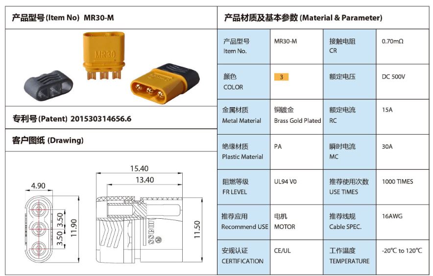

yeah they are only rated for 15A continuous…
(source)
I thought they are mr60
Nicely done but if that was hardened steel then now it will rust easier. I advice to cold blue the expose last 30mm. Better would be with heat but do it twice on the same metal make it weaker and moreover they are connected to the motor. Only cold blueing should help already.
I guess they are not the genuine mr30 connectors, but they fit the same. So maybe the ratings on these knock-offs are even worse, who knows. 15A per motor might be enough for some (with 30A bursts), especially if you want to max your range. Maybe I try them.

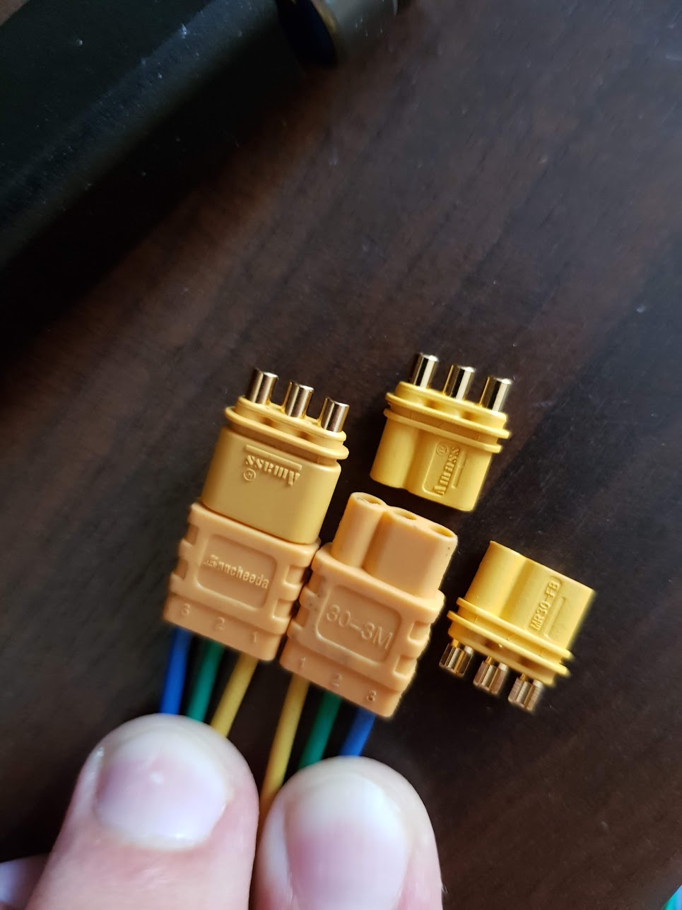

I promptly reduced the length of the phase wires and attached mr60 to it. I had gotten a mr30 connector with my drives.

Yeah, those connectors look funny. I thought these would be MR60, not MR30. I didn’t have any MR30 on hand but I did have MT30, which are a pretty good fit with for the tiny phase wires and still big enough for using 12AWG at the VESC side.

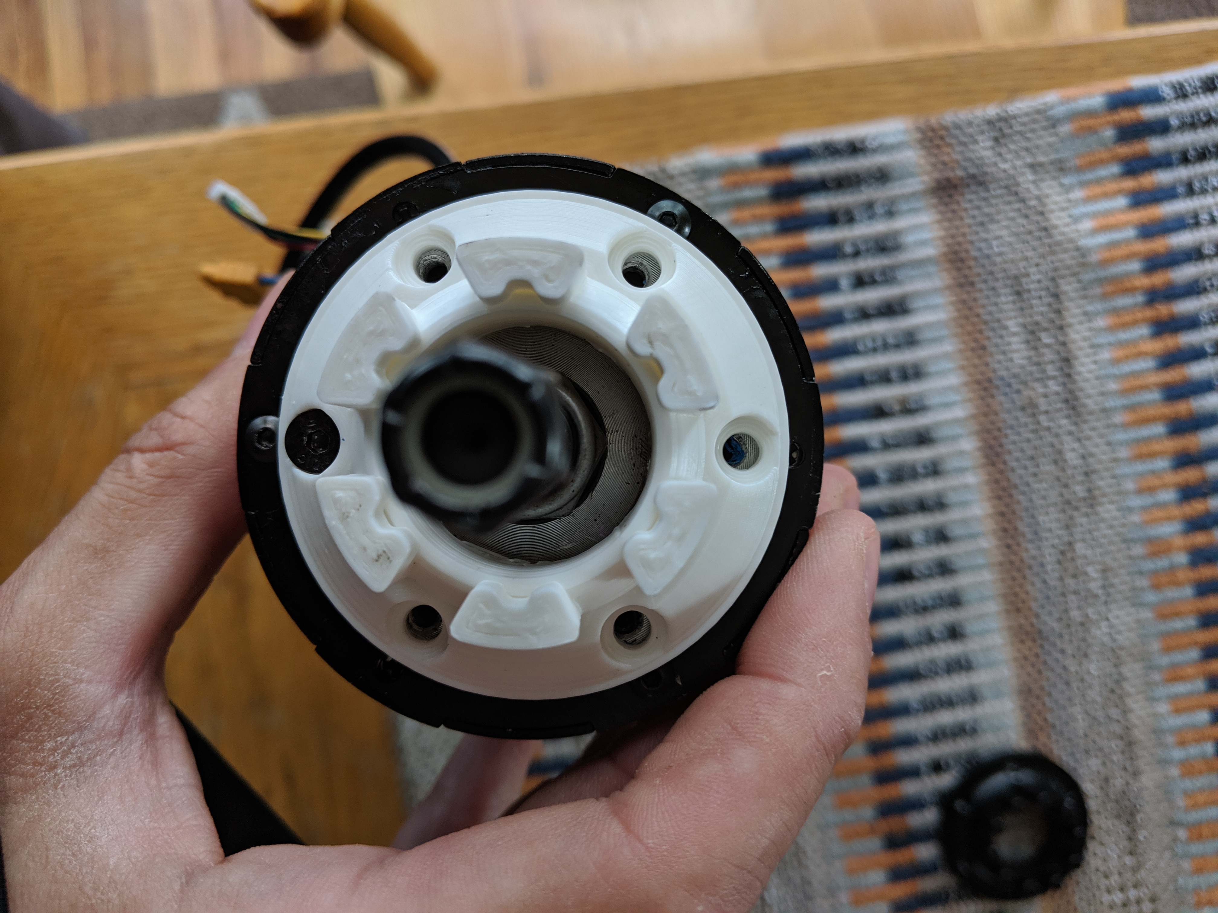

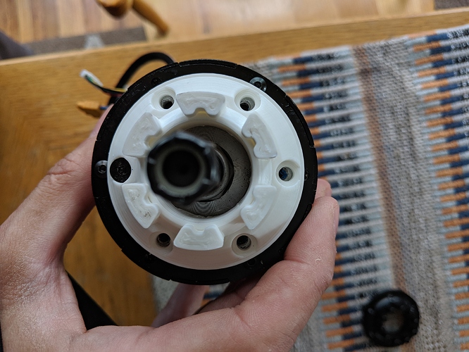

So it looks like these motors are a different size. The adapters printed off thingiverse do not line up with the screw holes for my set of drives :face_with_monocle::worried:
I have the file you need, I designed it yesterday to fit @Tonkatron motors. hang on I’ll upload it to thingiverse.
What do you think your motor type is so I can write the correct description?
My motors are the ones with the removable sleeves. I don’t know what size it’s hard to tell unless I take it all apart :confused:
Try this, this is for @tonkatron DD’s
incidentially, if there is interest and these fit I was considering doing a run of CnC’d aluminium ones.
