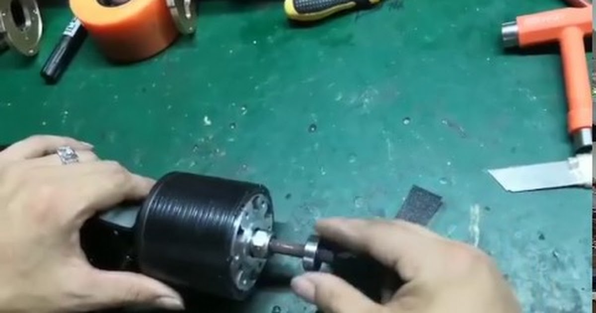

Just over 1 hour with 240 grit wet and dry a fine metal file and it’s done.
Hopefully tomorrow I will have a change to test the motors and make sure they work and then I just need adaptors
Nice. Looks better now :joy:
I need to do this with the Torqueboard DD. :joy:
Kenna’s factory sent this video over. Looks like fairly coarse sandpaper, but appears to get the job done. YMMV.

axels not fitting bearings can hardly be described as ā€˜little details’ :slight_smile:
mine needed a lot more work that just that. I had to remove over 0.2mm from the diameter
0.2mm is a little detail dont you think? :wink:
I know what you mean but they are new to the industry and this is a brutal way to learn but I hope they dont make the same mistakes again.
not if it stops the product from performing its main task IE does it actually hold wheels
first QA step ā€˜do the wheels fit on this truck’ and if THAT is not done then NOTHING else is getting checked - I’m not sticking untested shit on my board and hitting 20+mph - someone else can do that testing
