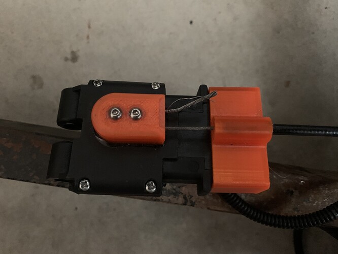

Development started by 3D modeling an adapter plate for the motor to the transmission.
Then I made a coupler from the 10mm motor shaft to the transmissions input. This pic is after the test run.
Also a way to connect the throttle cable to a hall sensor.
I then simplified the mounting plate design so it was more rectangular.
Then I sent the designs off to @Savage1 who did an awesome job of making them out of aluminum.
Here is its current state:
Motor mounted
Skid plate under battery made of a old 3D printer Y axis plate

How does that (comparatively small) motor measure up to the stock gas engine in power output?
Dude, this is cool! What Are you planning on doing after high school? I see a bright future ahead!
So the stock motor was 2.2hp (1.6kw) according to its specs, and this motor is is rated for 12S 100A, so ~5.8hp (4.3kw at nominal charge, full charge should be higher).
The thing is, the electric motor has a top speed 60% faster than the gas engine!
I took it out for a half-assembled test ride last week and at 100A it has too much torque :rofl: Only one of the wheels is connected to the transmission so it does a pretty hard one wheel peel. I knocked it down to 60A which still is very strong but isn’t scary acceleration like 100A.
