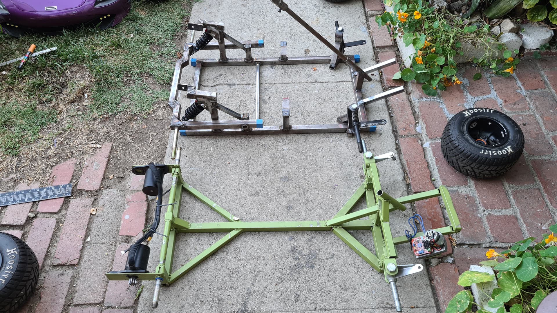

So I just want a decent frame basically.
I found racing frames for $900 :face_vomiting:

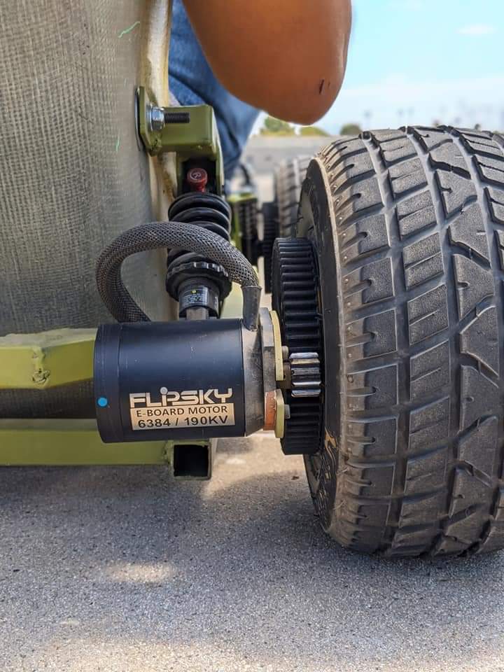

Looks like a couple lynch motors to me. Iirc those’er brushed dc motors.

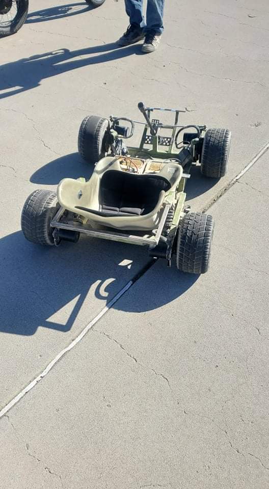

Got any more info on this little monster? That’s like my dream mini kart. :heart_eyes: Looks like a blast.
It’s a custom frame. Springer spindles up front and rear has swing arm suspension. 6384 x4 with 12s16p battery. Started with 3d printed gears and now using stooge gears. 35-37mph with current gearing and 40 mile range. The only difficulty is really space constraints when working with a kids ride on body, standalone go kart would be pretty simple. If you’re thinking of getting a welder I recommend you do, it’s a lot easier than I thought it would be.

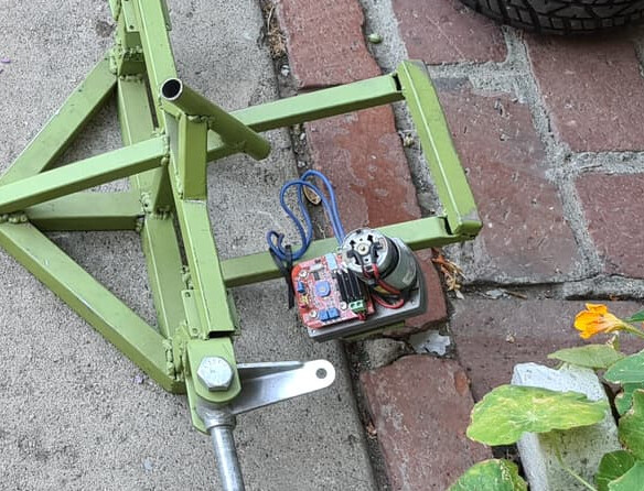

whats this?
Mini gearbox, interesting.
It’s for remote steering (I’m pretty sure) like an rc car
Like @DEEIF mentioned, this was for rc steering, that is the servo.
