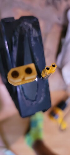

I want to add my EGO yard tool Battery to my Board. I tried this on my daughters electric Jeep and cooked it. So, seeking advice before I ruin the board.
I have the adapter to connect it to the board but the Voltage and Amps are way different. Which I believe is what cooked the car.
This is the battery I removed from the eSK8
So, main question is, how do I do this and what am I missing to throttle the power?
Has anyone tried this? Terrible idea? I have several of these sitting around and I can swap them on the fly, so…seems like a no brainer.
2nd Question… I also have about 10 Mikita Batteries for cordless tools. But, they are really small and shaped poorly. I feel like I am better with the eGo battery but open to feedback!

They are called xt90s, i didnt see any in the photos and could be a coulprit of burning items. I mean that esk8 needs to be taken apart to see the internals before yah go buying things.

I’m pretty sure it is a ling-yi based board on the esc and they don’t have integrated antispark on them at all. You get a nice spark noise when plugging the xt60s in on them. No xt90s in there at all. The tiny xt is an xt30 for the charging port to connect to the battery. Port is on the esc enclosure so the battery enclosure can fit as much battery in it as possible
The Team Gee board shares a lot of parts, including the enclosures, with the Lycaon GR models or at least the old ones. Those enclosures are super strong and the gaskets are great for keeping water out so @ChloesDad don’t toss those out.
As for the battery, so long as you can step down the voltage to ~42-40v you should be able to use the tool pack. I wouldn’t step down to 36v since you’d be loosing power for no good reason.
The makita battery packs you said you have are 5S 18650… so two of them would make a perfect 10S replacement for the stock 10S pack.
Much easier than all the steps to get the 14S Ego pack to work on the 10S system.

You’d probably fry the ESC if you connect the 56v battery to it even if you use an anti-spark first.
You should be able to find some DC to DC converters online if you really want to use the tool battery. You might have to be one with an adjustable output unless 56v to 42v is commonly needed for some reason.
You can add in an antispark if you really want to, or just switch the xt60s to xt90s with anti sparks in them so it won’t spark when plugging it in. I never bothered with using one with my esc and it never had any issues. You should use an antispark if you ever switch to a vesc though (unless it has one built in)
