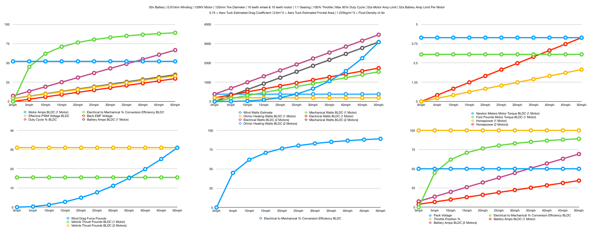

^Blue line bottom middle chart shows the electrical to mechanical conversion efficiency (comparison between efficiency control BLDC vs current control BLDC with the same current limits during full throttle acceleration), yellow line bottom left chart shows vehicle thrust in pounds at full throttle, blue line bottom left chart shows estimated wind drag force in pounds on flat ground. Blue and yellow lines top middle chart show the reduced motor heating with efficiency control. Purple line bottom right chart shows the battery current. Blue line top left chart shows the motor current. Purple line top middle chart shows the electrical watts. Black line top middle chart shows the mechanical watts. Blue line top right chart shows the motor torque in newton meters.

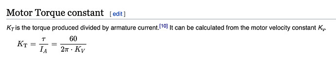

First to get the KT (torque in newton meters per motor amp), the formula is:
60 / (2 * pi * KV) = KT
next to get the torque, mutiply the KT by the motor current:
reference:

Edit : so basically a 85kv motor should be able to push 11nm for 100A minus the losses right?
60 / (2 * pi * 85kv) = 0.1123nm/a
100a * 0.1123nm/a = 11.23 newton meter torque

^ In this case (both full throttle):
88% desired efficiency setting, 250w min watt setting, 2600w max watt setting, 52a motor current limit, 52a battery amp limit
vs
52a motor current limit only
In the efficiency control example pictured above, 250w electrical is used (min watts setting) until the motor rpm is reached that more that 250w electrical can be used at constant 88% conversion efficiency, at which point it can be seen that the electrical power ramps upwards with increasing motor rpm at constant efficiency.
