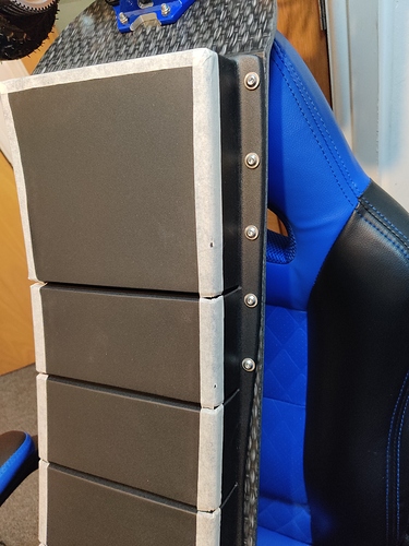

Alan suggested 3 screws for big end pockets and 2 for smaller one and to leave middle pockets without any screws.
This is what I ended up with, 18mm from the edge to first screw then each spaced at 55mm:
I’ve used M5x16 A2 flanged cap head hex screws, though the last one doesn’t quite fit so I will put non-flanged one later on.
On the deck stainless rivnuts as in original Alan’s guide but I didn’t glue them I riveted them.

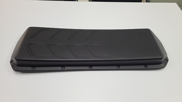

Hello Guys:
At last I was able to finish the Subsonic Century DS, this enclosure was designed and developed because of as lot of requests from builders and enthusiasts because the deck is very stable and somehow people are needing more and more range these days.
This enclosure is prepared to hold a 13S8P made with 21700 cells, meant for people that want the longest range possible, a huge discharge of constant current flow and need a high speed stable deck.
You may need to use pneumatics and risers in order to clear the ground.
