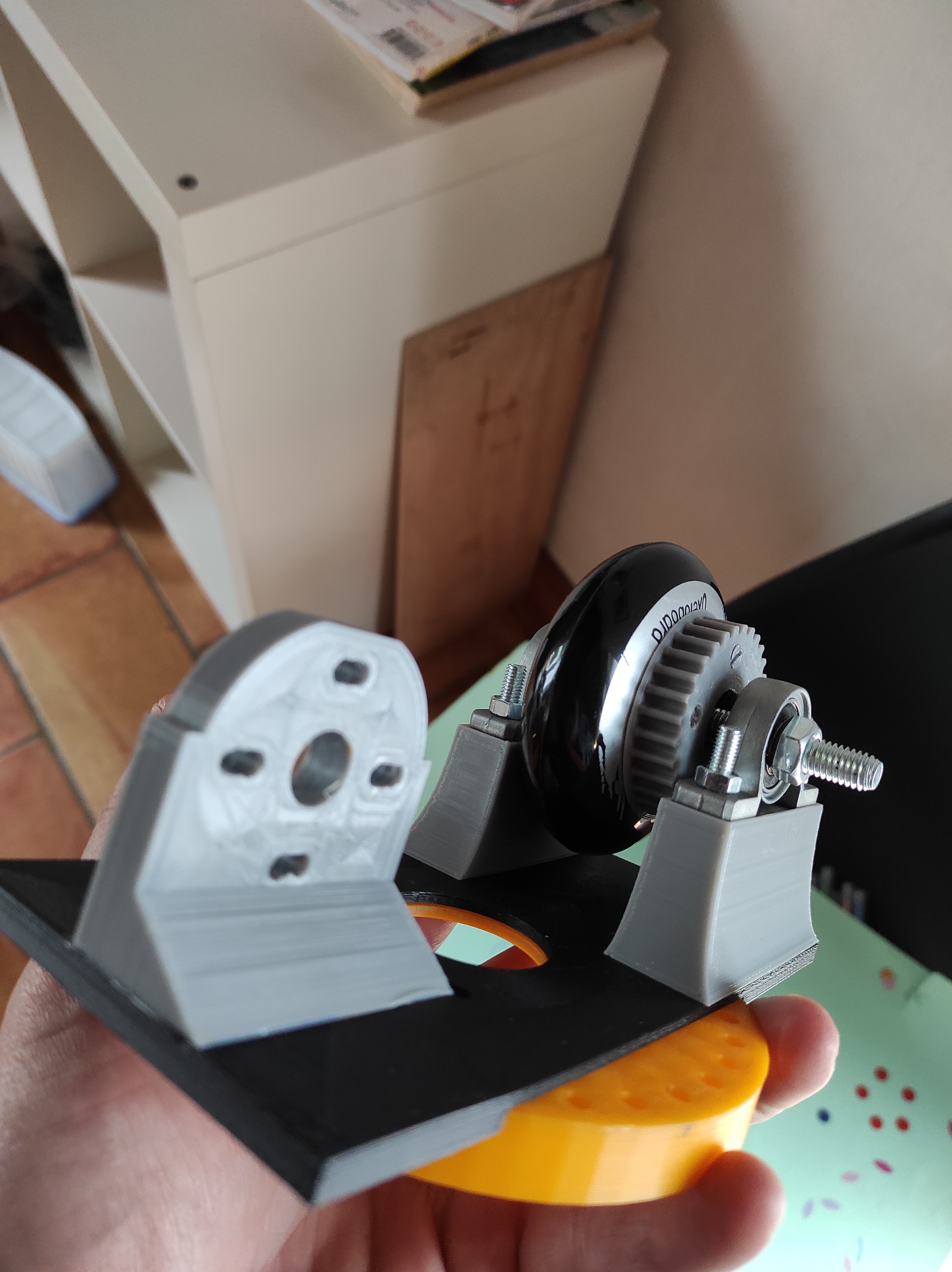

I’m happy you think the design seems thought out! I’ve been working through very many revisions and I landed on this one that seemed so easy to make that I might as well get started.
By far one of my favorite parts is how the @Boardnamics shoulder bolts were exactly what I needed for the wheel axle and pivot.
I think its uneven so it centers to a specific spot better?
I was so mad about the uselessly sideways bearing that I forgot to make an accurate model.
still attempting to figure out what the height should look like and what the suspension clearance should be.
if I want more suspension travel I need to move the motor closer in, so I might want to make my own pillow block for the 6007-2RS (id.35mm/od.60mm) that would be much smaller and allow the motor to be moved in a bit.
I am mostly trying to get the cheapest and easiest to manufacture solution, and I have some ideas on how I would make a more polished system. Smaller, with a gearbox and a outrunner built into the suspension pivot.
are you sure those bearings can take the vertical load ? won’t it dislodge them ?
Definitely they are fucking massive
Did you miss the part where it has suspension? The force on that will never be great.
The only reason I went with 35mm id was because I needs to for the 30mm slip ring inside. For the smaller 22mm slip ring I was going to try to use a 25mm id bearing.

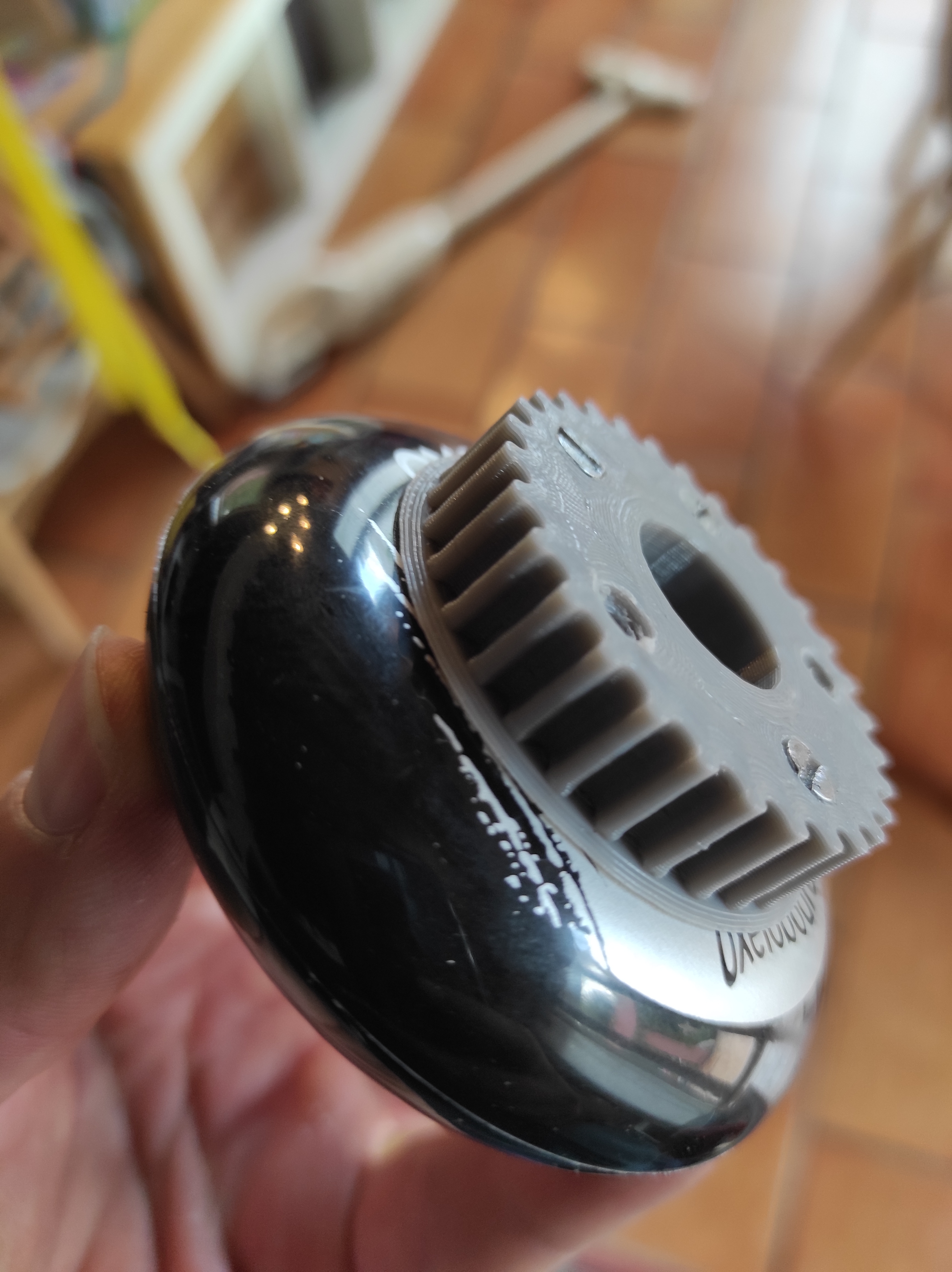

I got around to fiddle a bit with mine. I was unhappy about the pulley scratching on the ground. So i am trying to implement a wider wheel, and the pulley close to it. That way i can tilt the board a bit more.

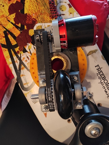

So it seemz good, but now it is the motor that sticks out too much im afraid…
Could you put the belt drive on the other side of the pillow bearing there? or are those not actually spinning and you use bearings in the the wheel?
I wanted to go for the simplest system, pulley stuck to the wheel, wich turns on its own bearings. In order to get the most yaw possible for the board. By putting the belt drive system away from the wheel you reduce the yaw ability of the board … It hard to get something efficient and compact. Got to find the best compromises

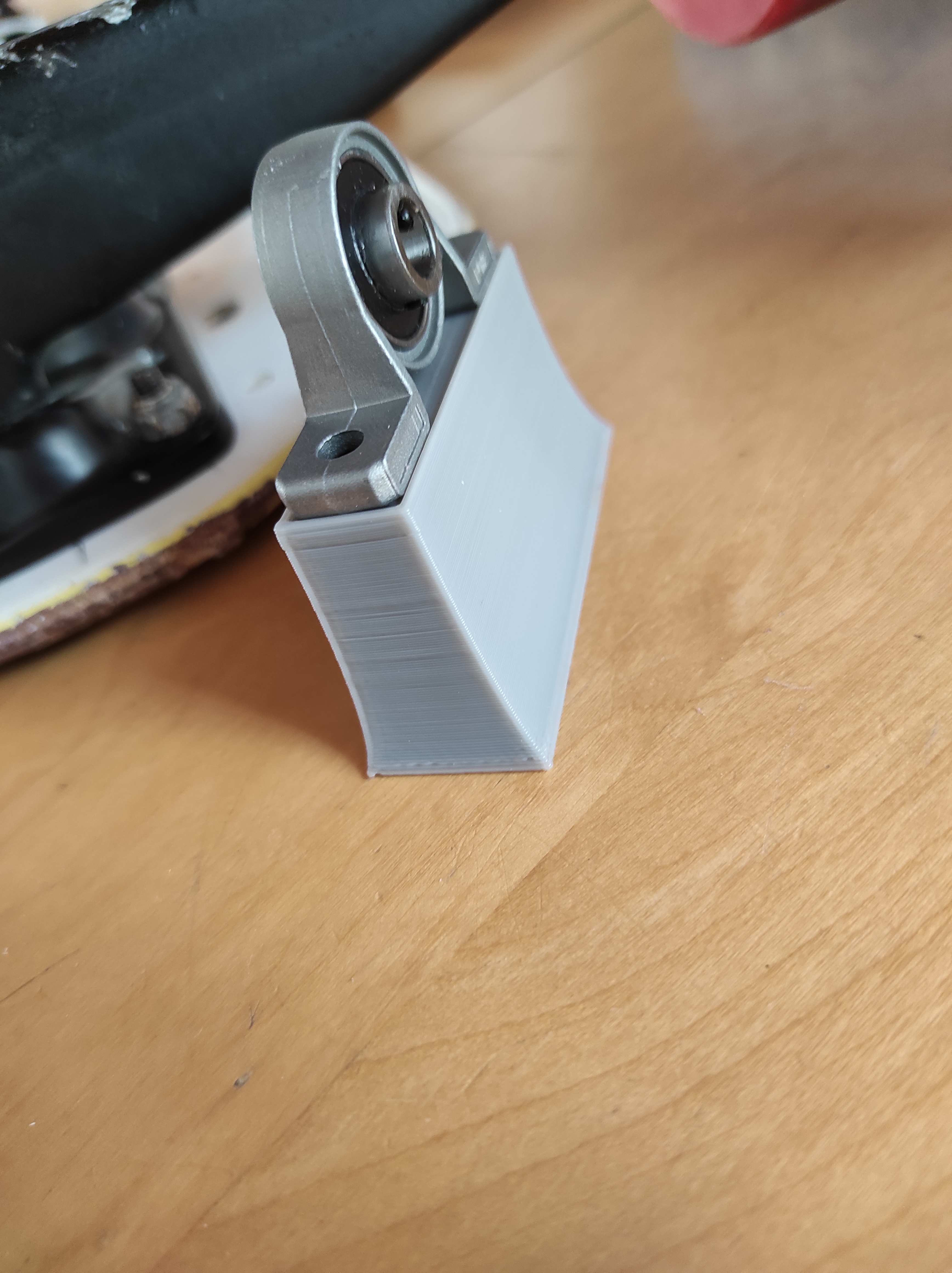

I think I might be happy enough with the dimensions to proceed with making this prototype. The messed up KFL007 pillow bearings will have to be solved with some shims i think :right_anger_bubble:
