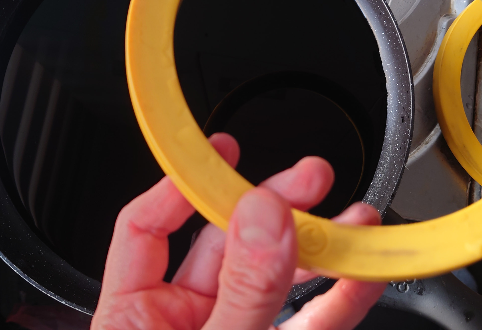

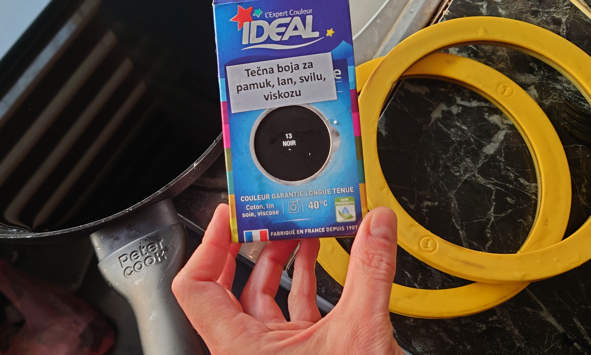

So I tried dyeing these rim protectors black.
Cotton/natural fabric dye. Recipe from post 1. After 30 minutes didn’t work at all. Left them soaking overnight - they turned yellow :smiley:
Nice color, but doesn’t really match my build.

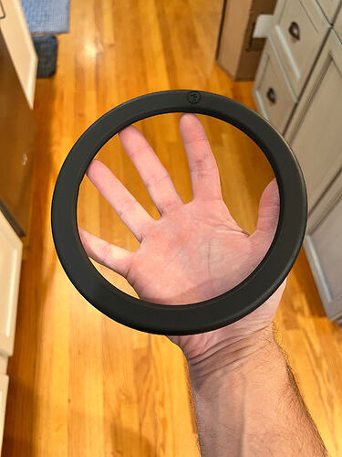

I dyed my TFL rim savers with synthetic Rit dye as well. I used graphite color for a nice black. Originally white. Took maybe 15-30 mins total.
What wheel is this going on?
That was for my old stock GT hub
Great result.

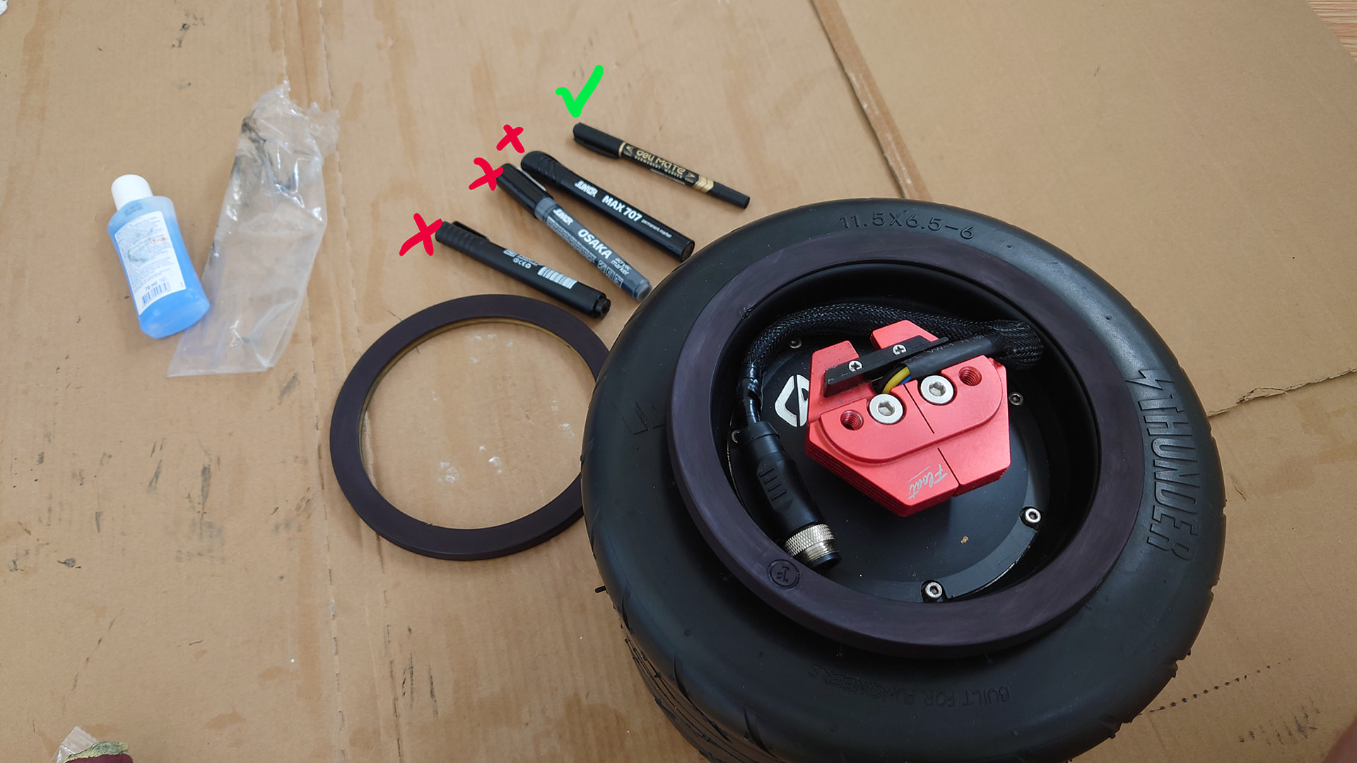

I took out the marker ink core, painted in 2 layers, wiped with isopropanol, then lightly sanded and washed.
Kinda interesting that only one of these markers penetrates into polyurethane. The first one is stable and is absorbed pretty deep, the other 3 stay on the surface and can be cleaned off with isopropanol.
The color is meh, but close enough, only cost me a couple bucks.
