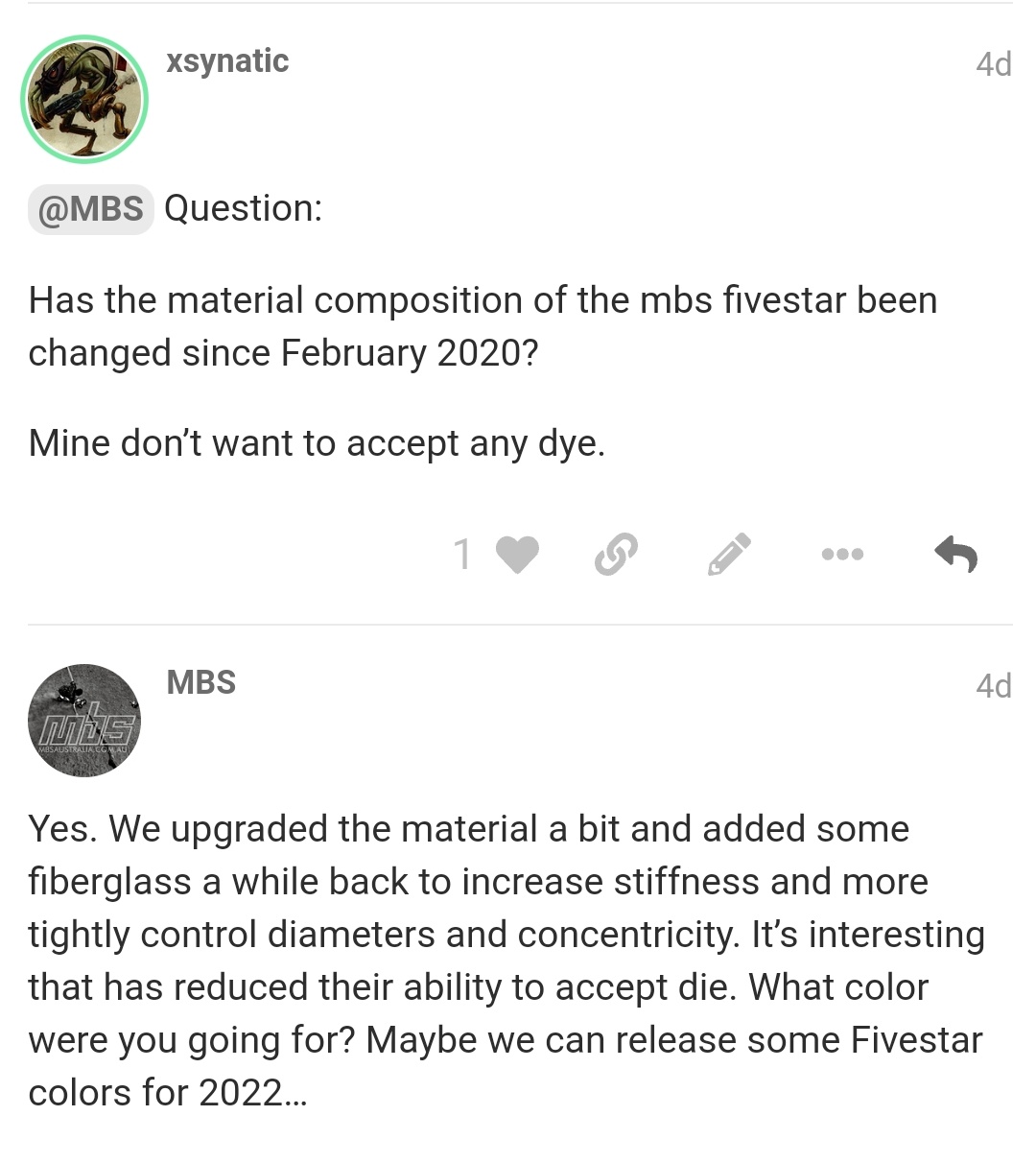

Depending on your batch of MBS fivestars (not confirmed with other hubs or if this is an isolated case ) it might be possible that they will not accept your dye properly.
MBS has changed its formula in the past year or so (no specific time mentioned)
I have a set of fivestars that i have bought in February 2020 which so far are not accepting dye the way they should.
Could this be a user error? Maybe. I’ve sent the hubs to someone that knows how to dye, i also believe this thread is no stranger to him. So im not leaning towards it being a user error.
