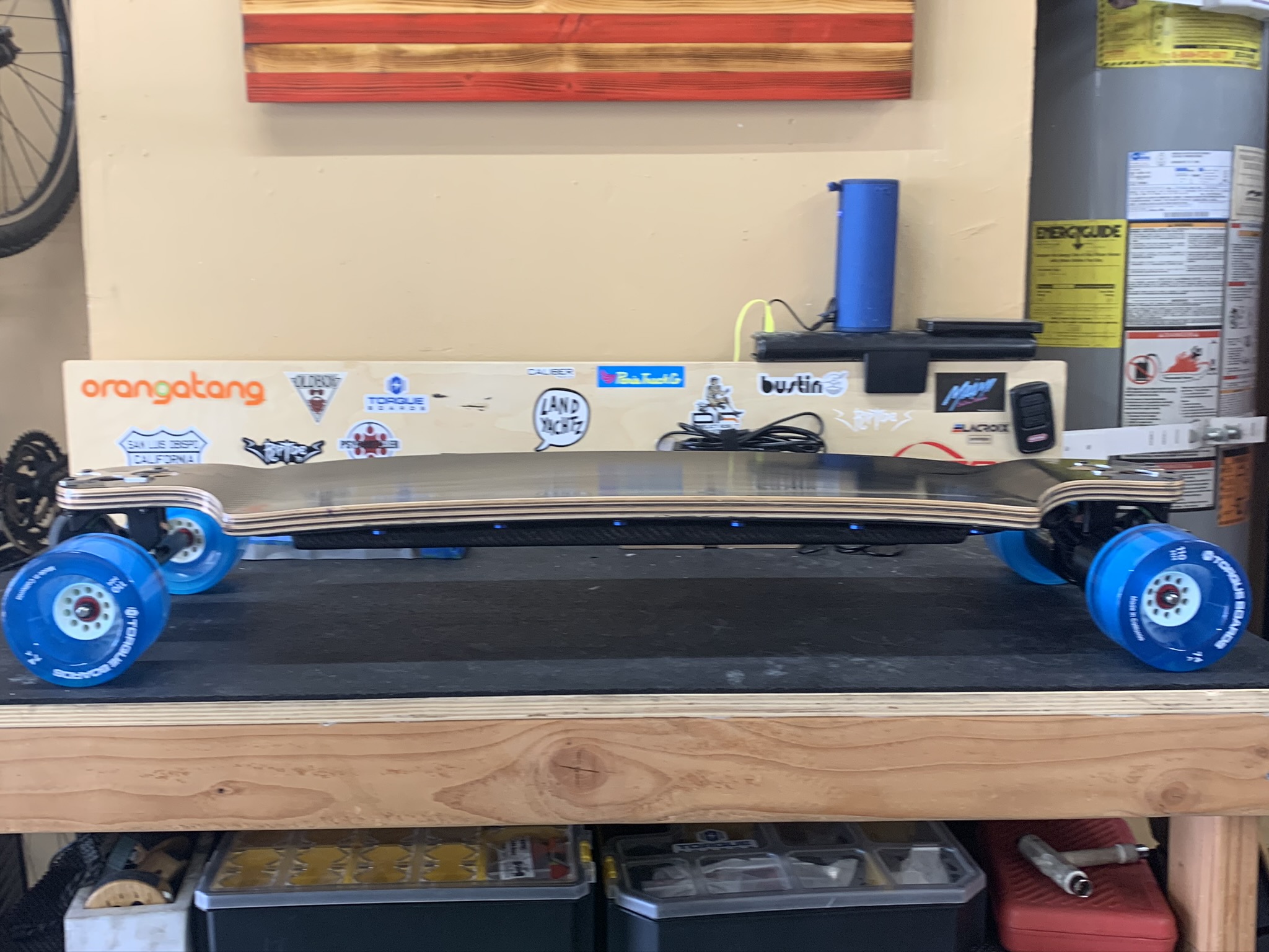

What do you think of a simple AS150 loop key with no A/S, am I walking into a problem with an ESC sans A/S running 18s7p of 30Q? The @shaman serious FOCer
Maybe this requires designer input, out of my depth in these matters.
I know I know! But it was already printed a long time ago
Cheers
Why would you want a loopkey without spark suppression?
In your picture is an AS150, the male portion comes in standard (like yours) and spark suppressing (resistor at the tip).
@magharees I do have an AS designed out (not HV in current form but can scale), but I actually 100% agree with @tipsy here- hibernate with a physical circuitbreaker (AS key) is actually a far superior solution in regards to safety/reliability IMO. It’s a really smart/simple implementation that Vedder pulled off with the last rev VESC6.
Thanks gents, yup that picture is actually Deckoz’s. I pulled the step file before it disappeared in the rage-quit
And yep mine has the resistor so so guess i’m good to go for rudimentary spark supression
