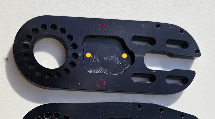

I think it wouldn’t be ideal since I have that pocket and where those holes would be are the main structural components
Last day for the sale for cyber Monday
Thanks, that’s what I was worried about & the pocket area itself seemed too thin to put a stress-taking hole in.
I’ll try running the motors (they’re big 63100 ones) without a crossbar and see how the mounts hold up, I’ve just been putting crossbars on all my drivetrains that had holes available as a precaution.
Can you use the skid plate/bumper holes to attach a supporting cross member? I was looking into making a u shaped plate for mine though i haven’t done more than just start thinking about it.

Thanks for the illustration! I was initially picturing possibly putting a single m8 support rod through where you have the outer dot (away from the clamp) - a rod at the inner position would foul the hanger/baseplate I’m working with.
The material is about 4mm thick there so seemed like it might be too thin, be a cracking risk - maybe not?
Really should not see much force I don’t think…
