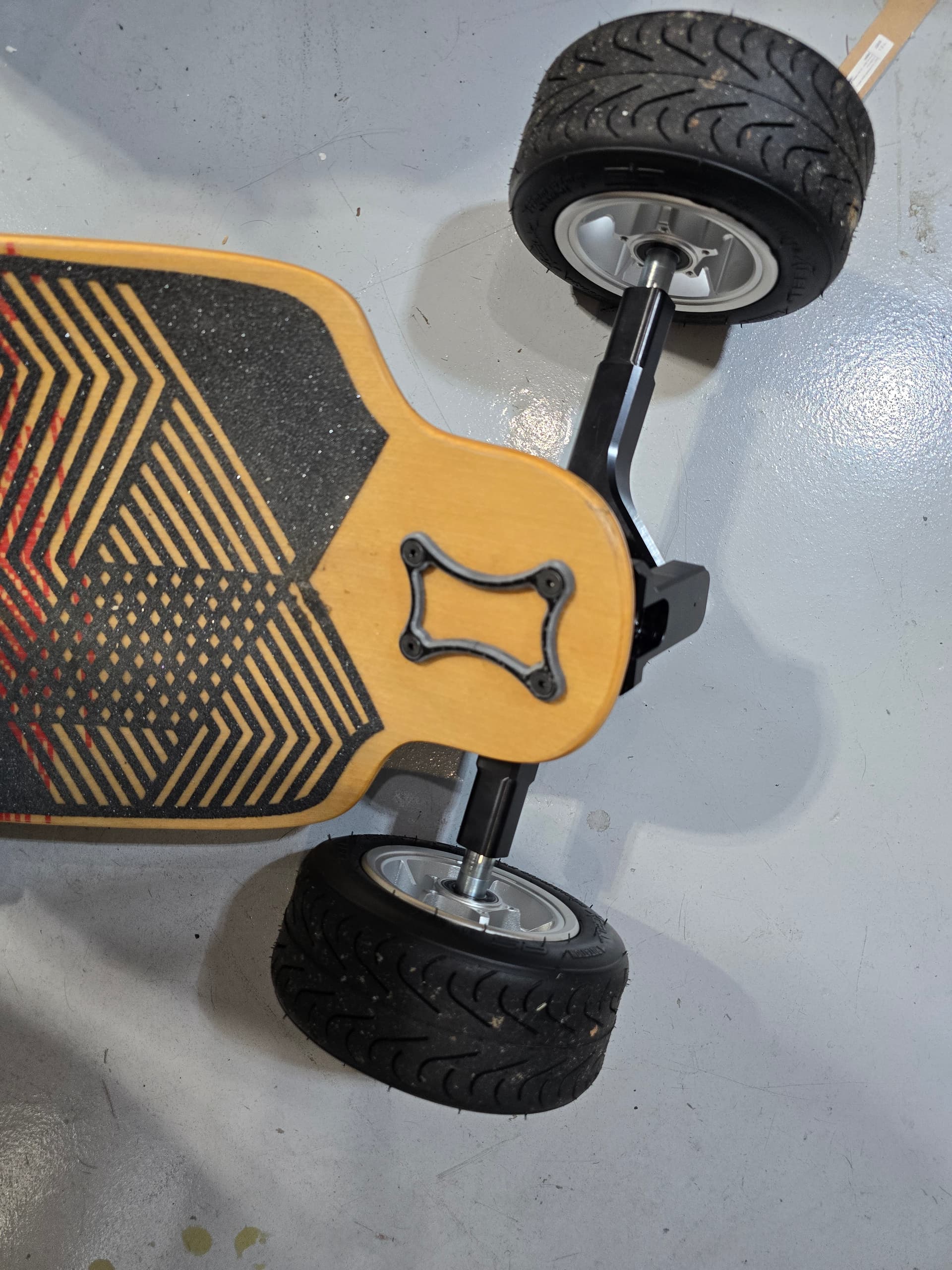

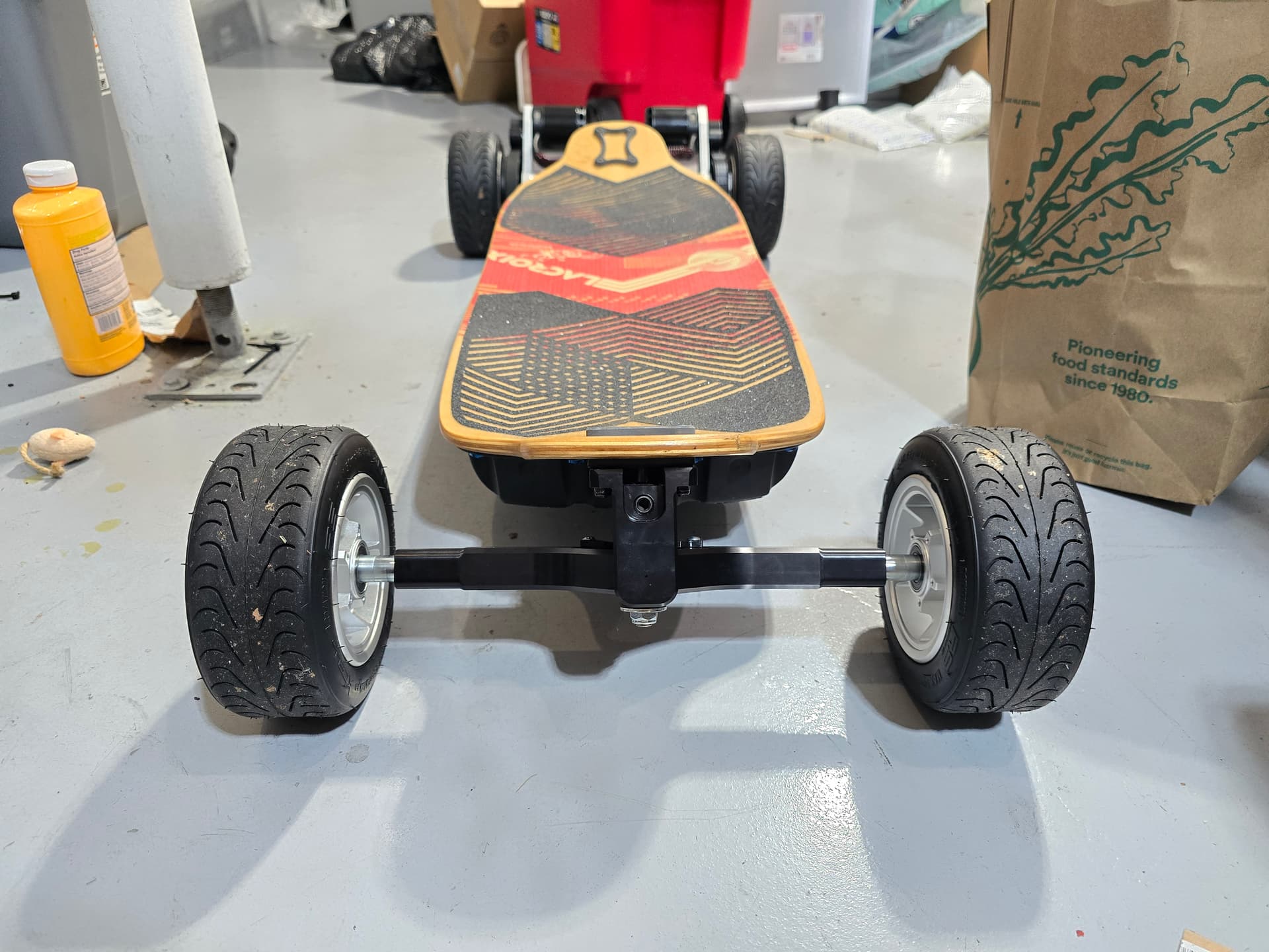

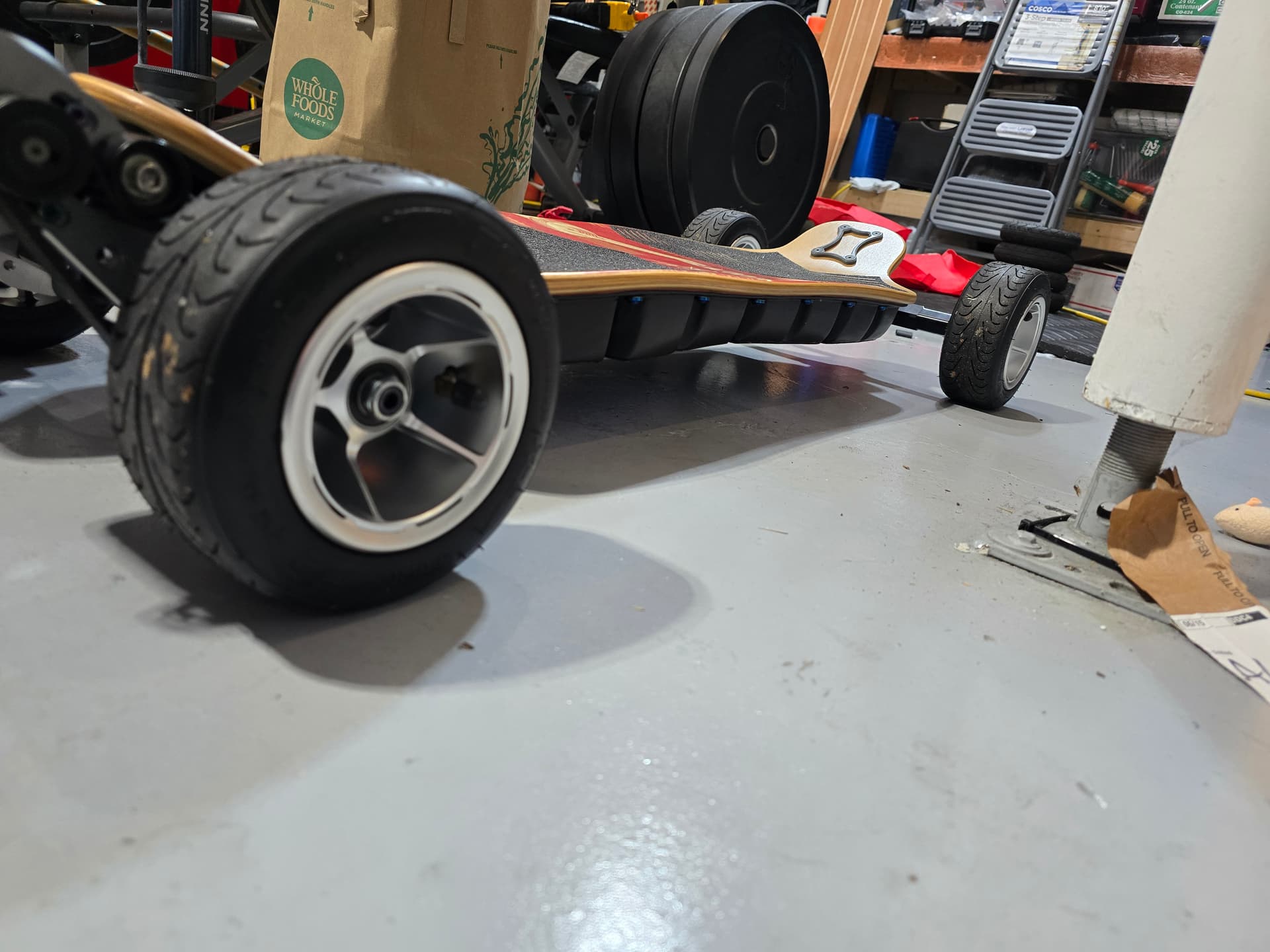

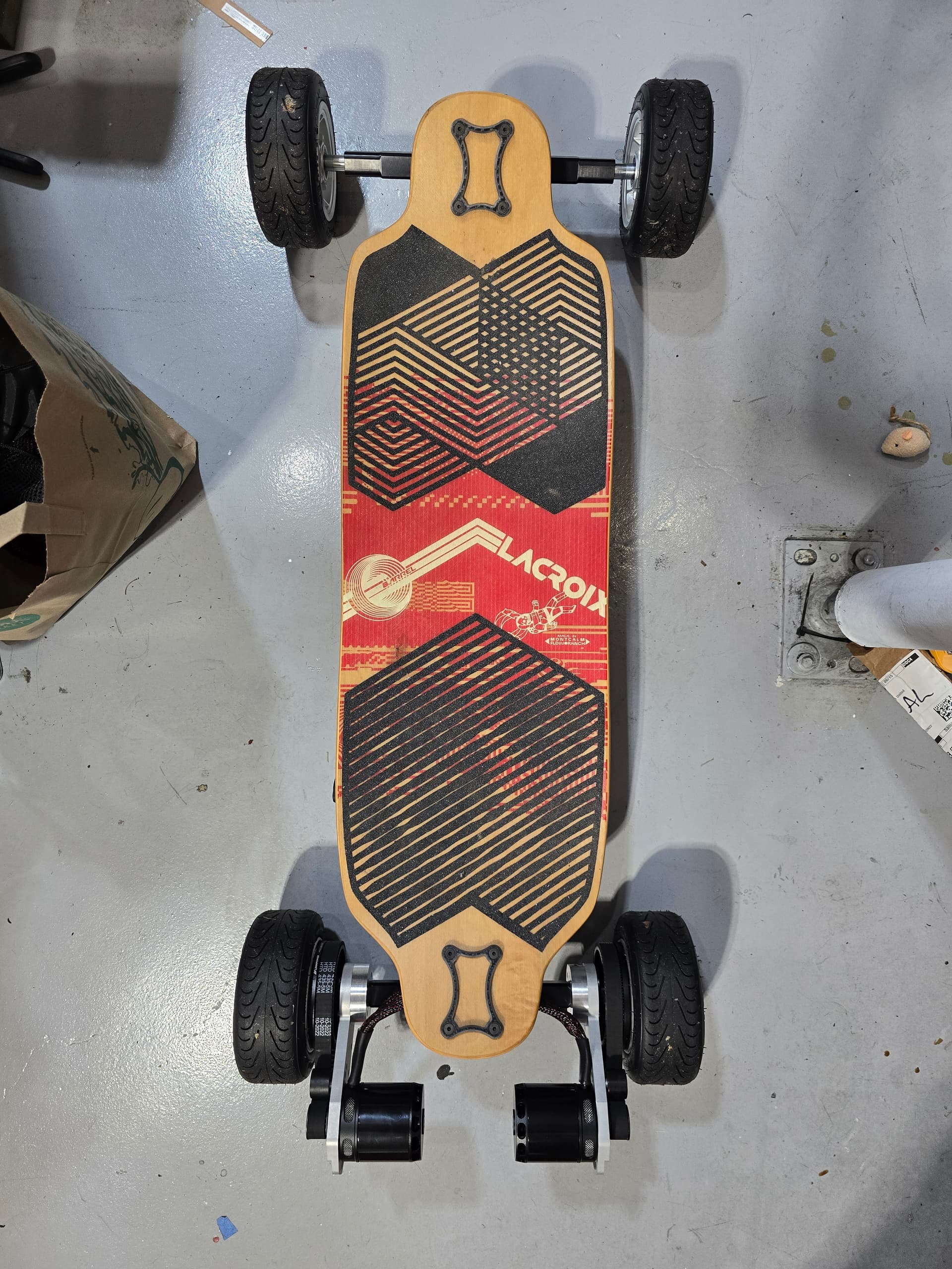

Finally got to put this together now that all parts are in. 270mm hangers with a modified baseplate that brings the hanger position more centered to the truck mounting midline.
Good amount of clearance at full lean thanks to the modified baseplates.
