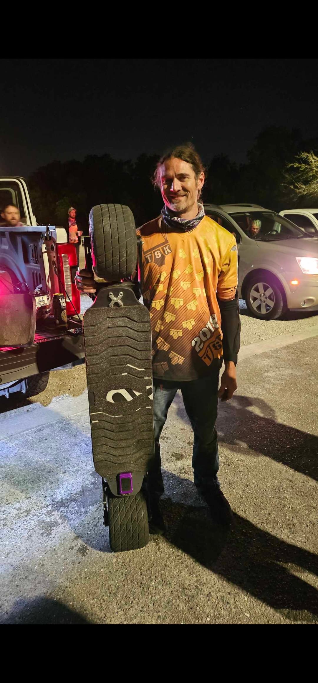

I’m 6’ tall. Here is the scale of this board
Godamn that’s huge! I want to ride it so bad :joy:
