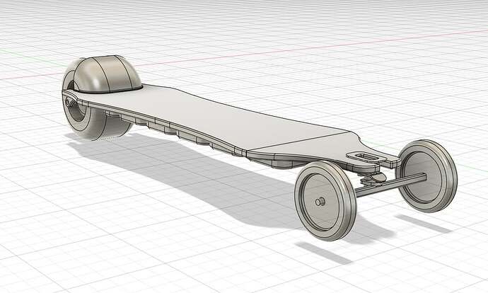

Duality, a different approach.
I’m comparing this 3 wheeled board to a regular eskate when i was making that statement.
Oh, so maybe this is more similar to the “point an shoot” stability that people have described on locked-diff Stooge boards?

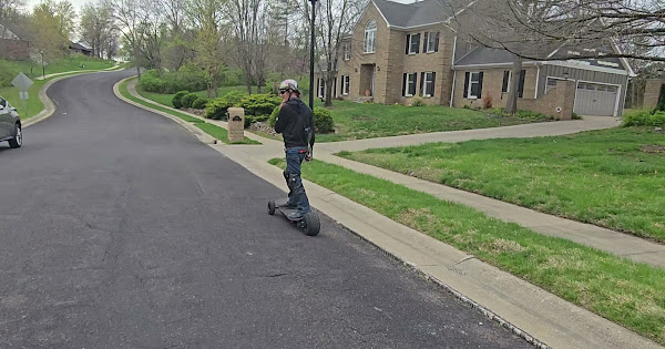

Here’s a slow motion video. You can see the smoke from the tire in this one

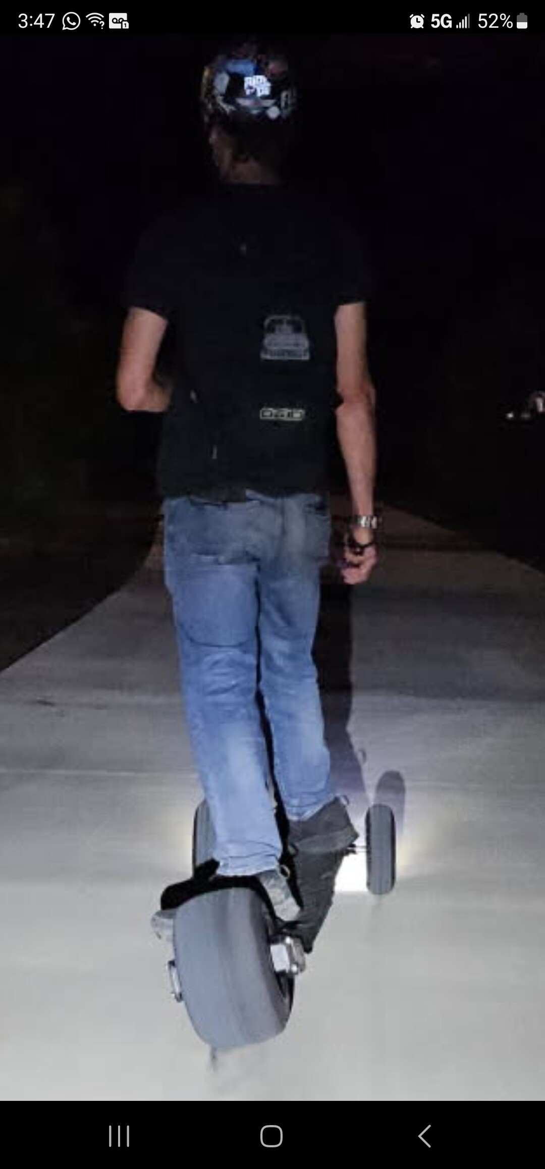

Here’s a pic from last night with the WONKY ear end. We are going straight hahaha
I forgot to turn the metr on until about 3/4 the way through the ride.

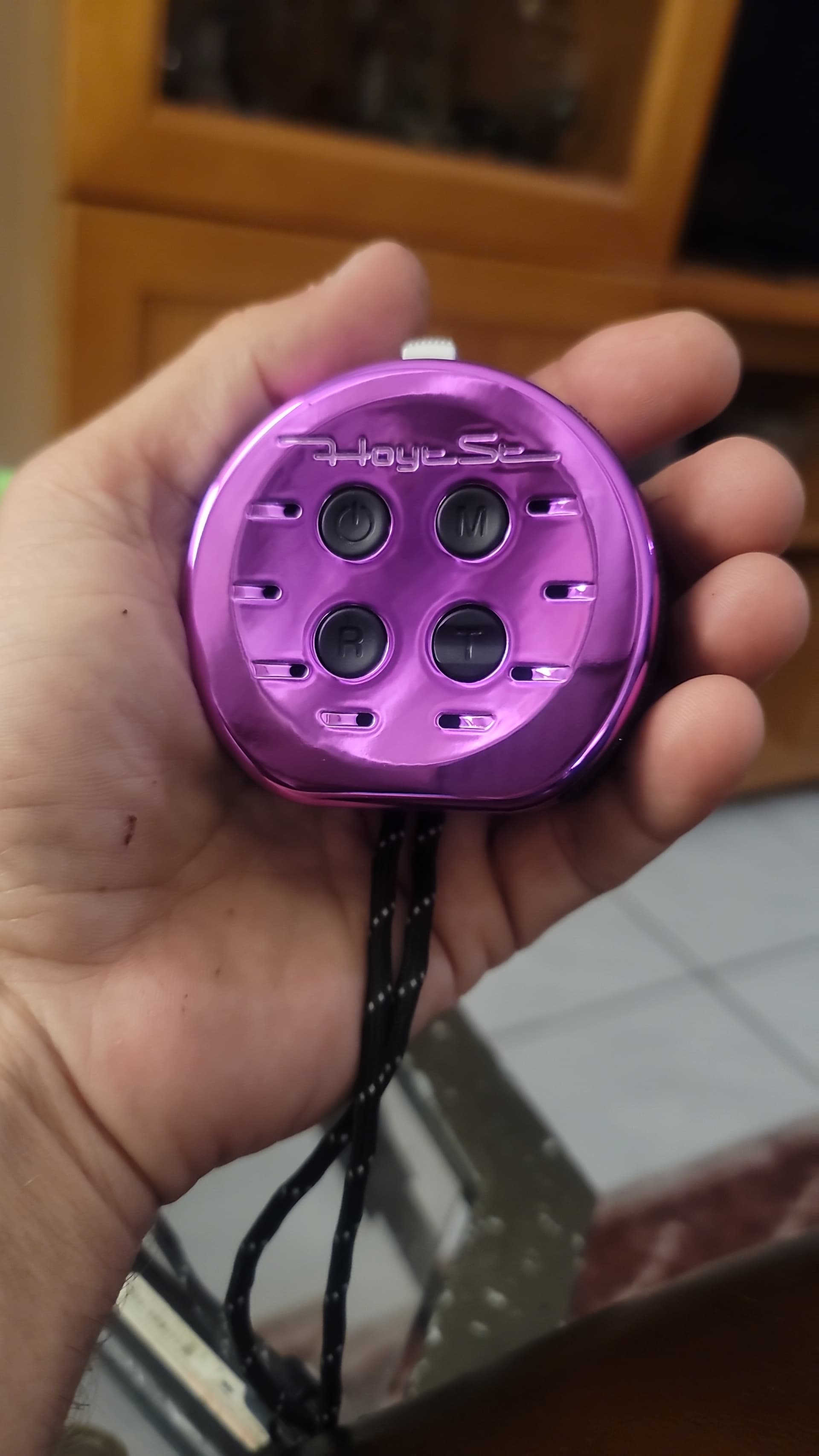

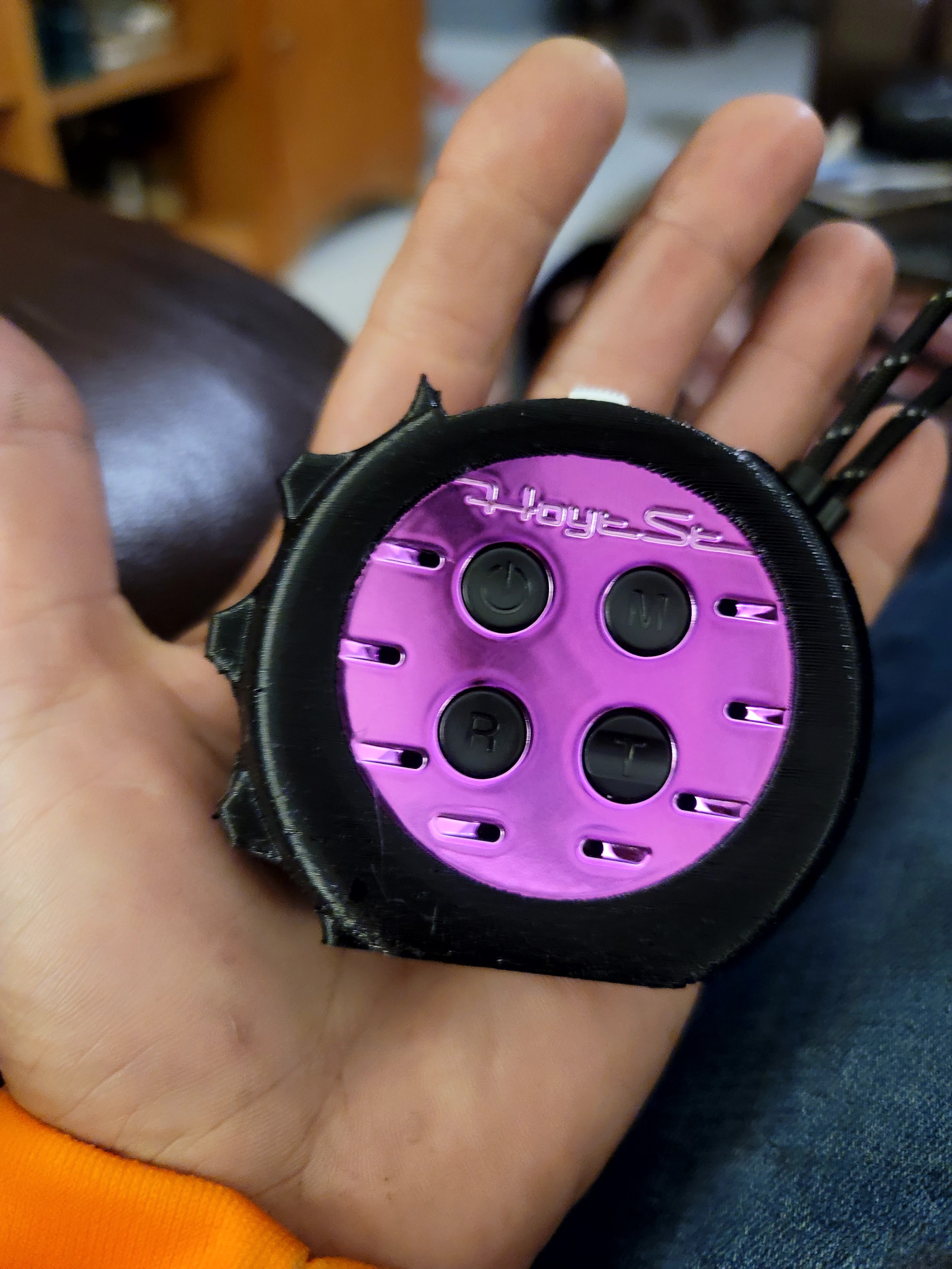

also the new Hoyt Puck 2.0 arrived, this will be going into Duality asap. Im not a fan of the vx4
3d print finally arrived, now we’re in business!

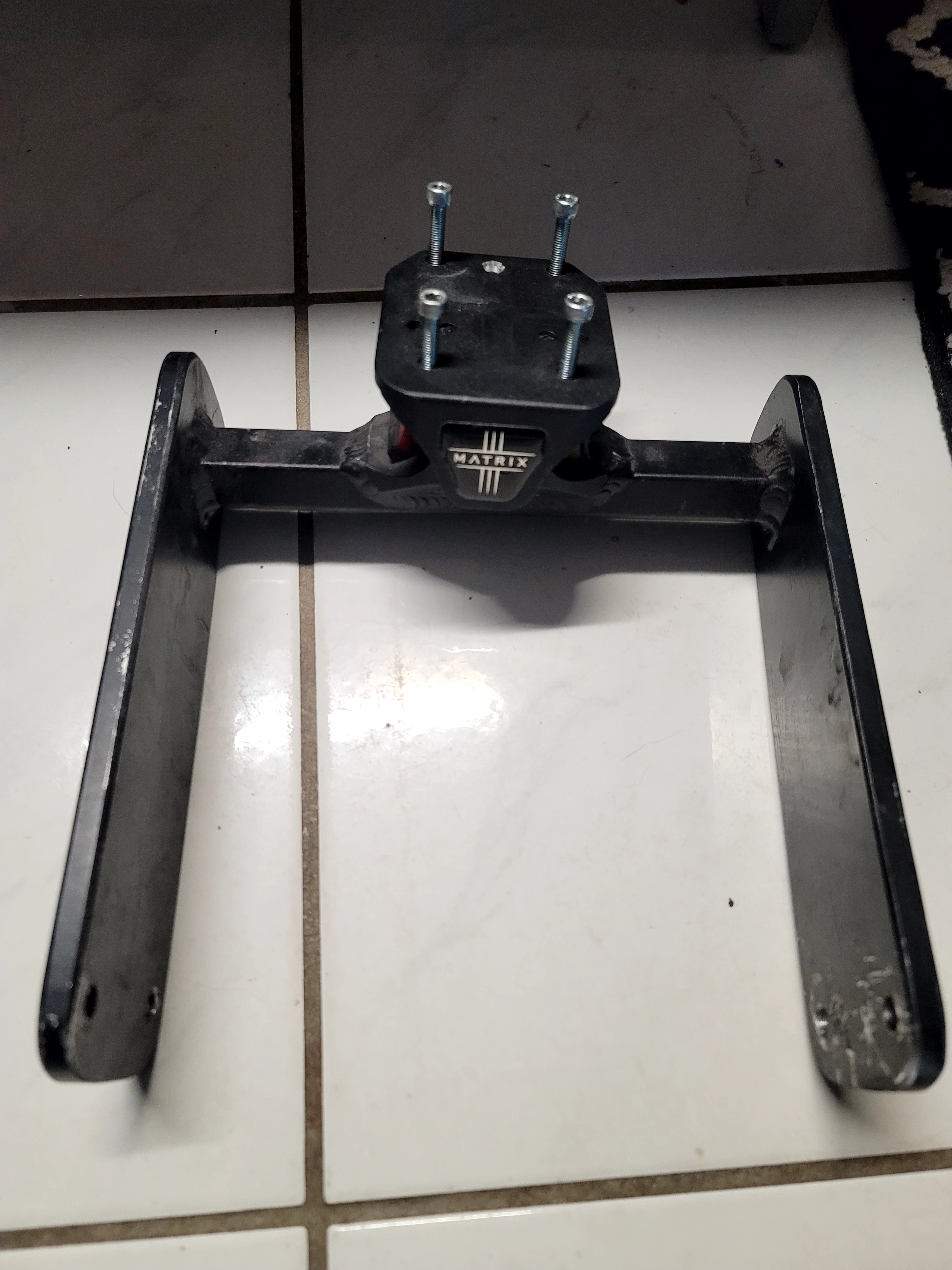

If anyone wants the matrix3 front truck with welded onewheel hub mount, I’ll let it go cheap. $50+ shipping. I have Way too much crap sitting around.
It’ll work as a rear mount also
