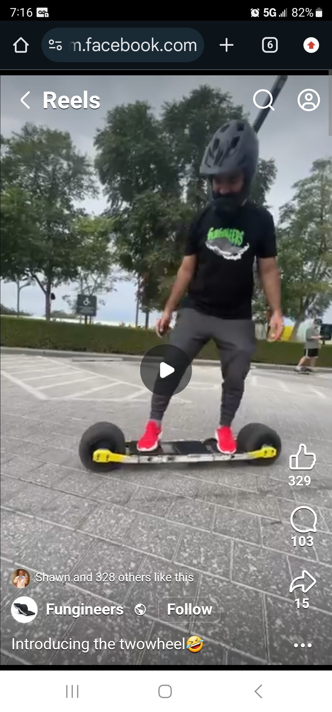

Looks like we have an imposter!
Too bad theirs has zero ability to turn
