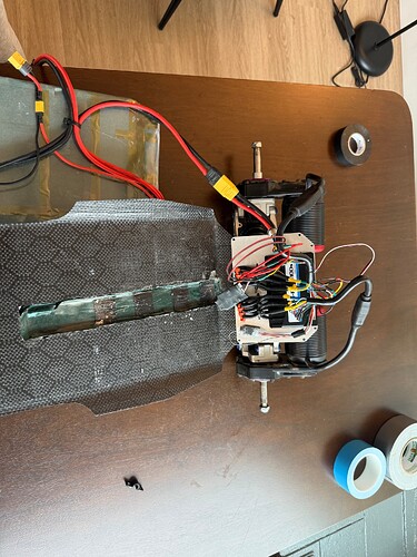

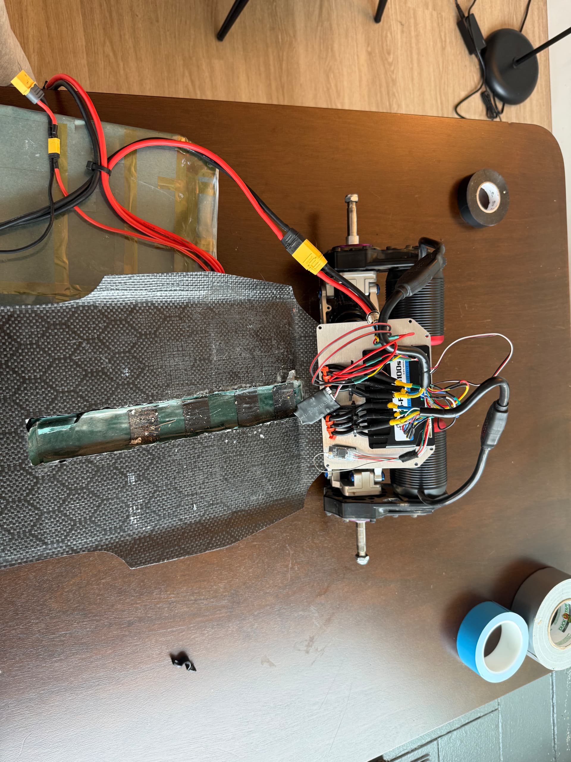

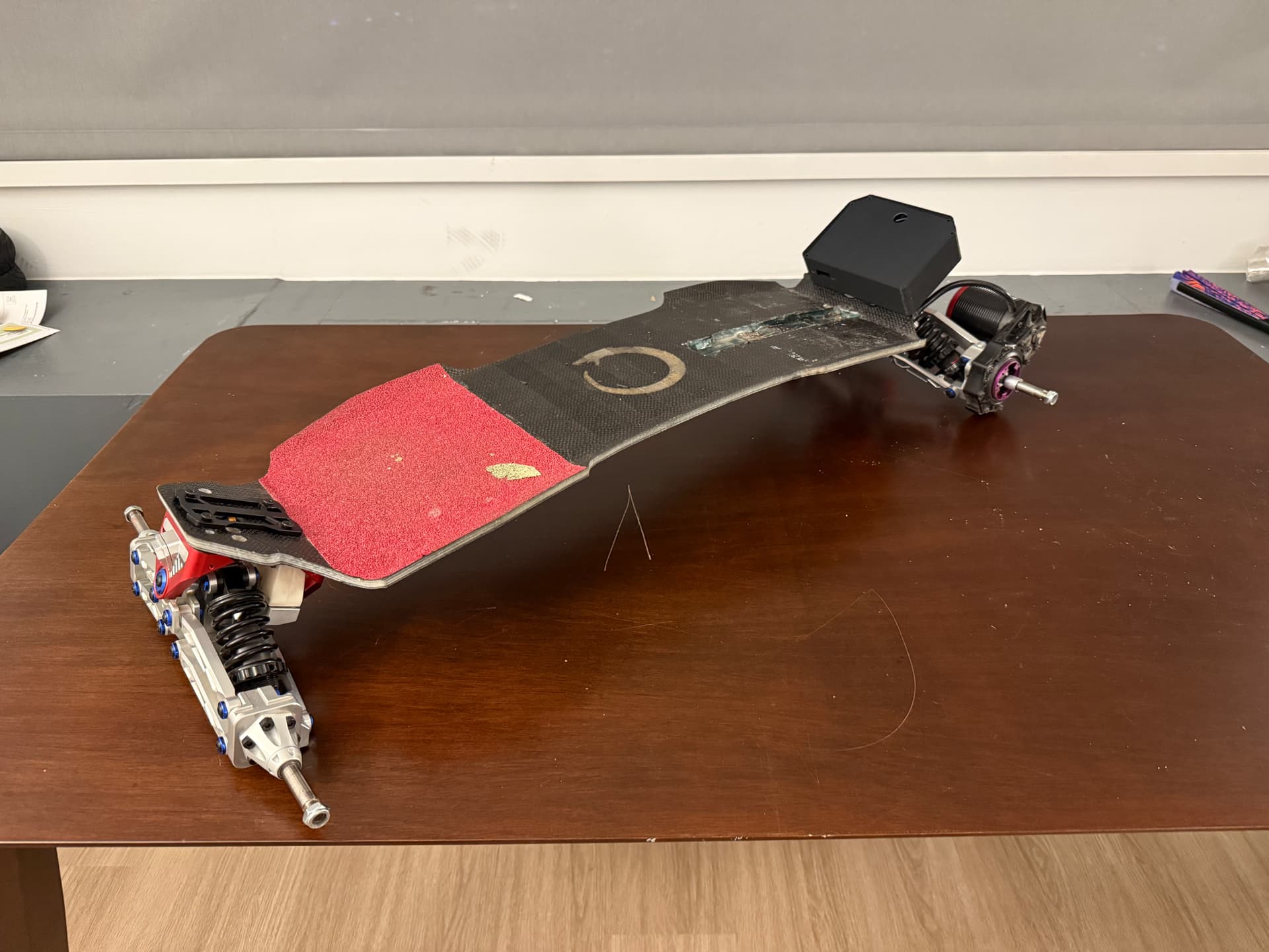

This pack will also act as the primary pack for my second horizon, which I have stripped the battery/enclosure from and am the process of converting to a full top mount MTB build with an esc box (sorry Jackson). The idea is that this pack will be easily swappable between the two boards depending on my needs for a ride. I’m keeping everything Acedeck except for battery/enclosure. I haven’t done any true offroading with the horizon yet so I’m very excited to see how the suspension performs.

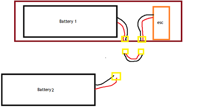

I had a similar setup on my Kaly board a few years ago, albeit with much smaller batteries. 12s4p inside, 12s6p p42a on top.
I ran them exactly like the diagram you drew, worked fine. Eventually I got annoyed at switching the packs over in the middle of rides, so just wired the batteries in parallel. Not a great practice, but it worked fine as long as they were the same charge when I connected them.

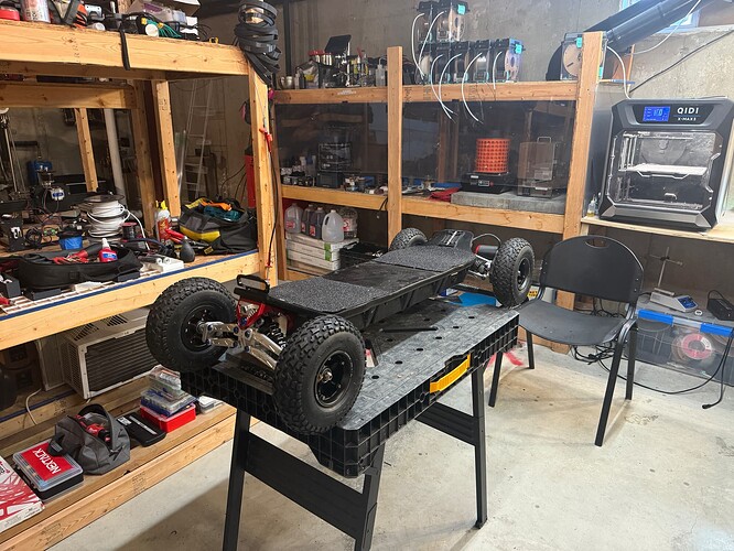

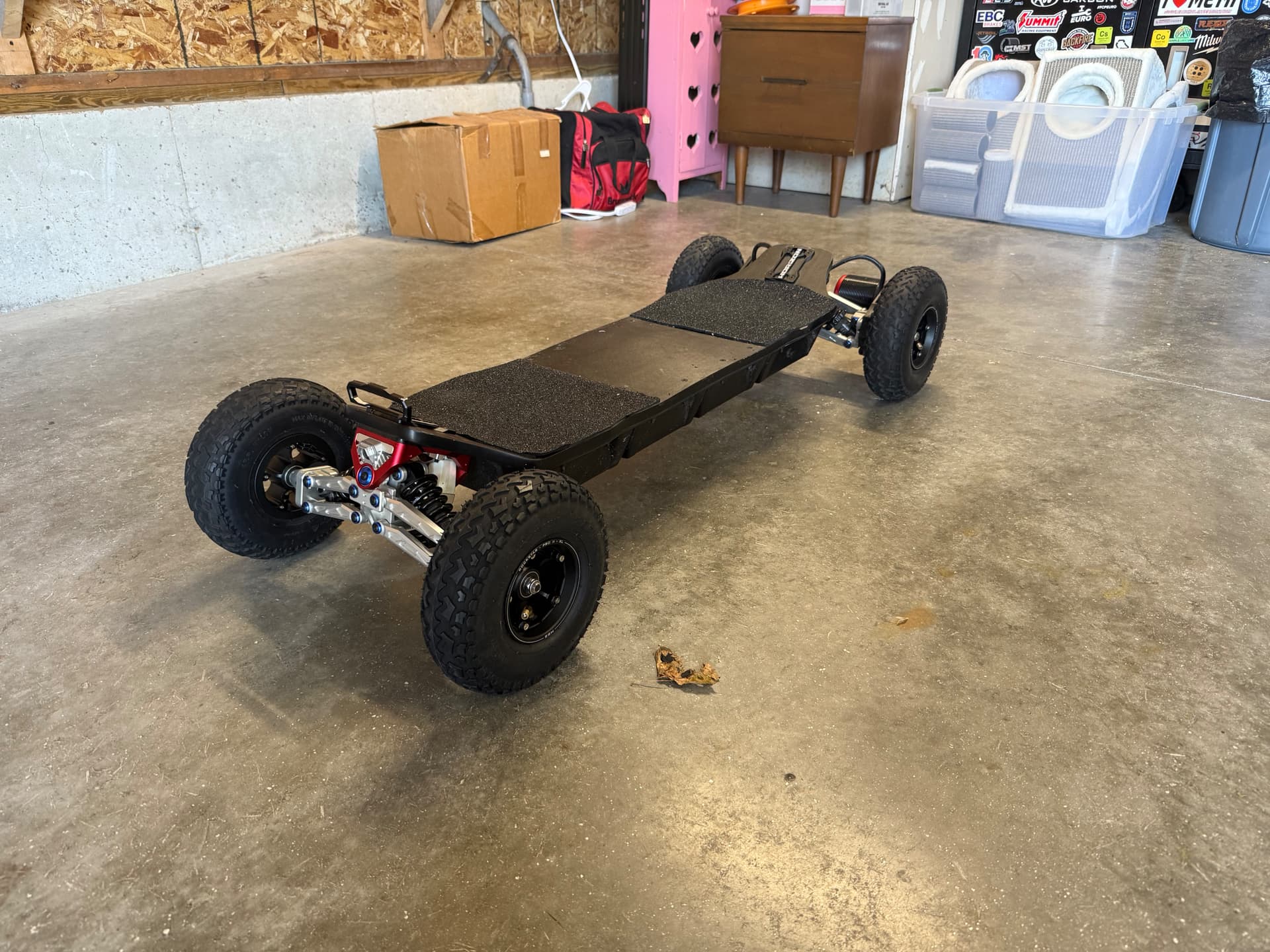

MBS adapters installed, thank you @AlexB! Next modification will be replacing the shocks with heavier ones. They are 250lb now but acedeck sells 300lb.
Looking good!
what do we think about kaly deck acedeck trucks?
Goddamn those trucks look like they weigh like 5kg each :sweat_smile:
The back truck is incredibly heavy with the motors and gear box
For anyone curious, the sensor pinout for the acedeck horizon motors is as follows:
Red: VCC
Black: GND
Blue: Hall A
Green: Hall B
Yellow: Hall C
White: RT
D100s mounted and sensors detected! Wiring needs some serious cleanup will do that next.

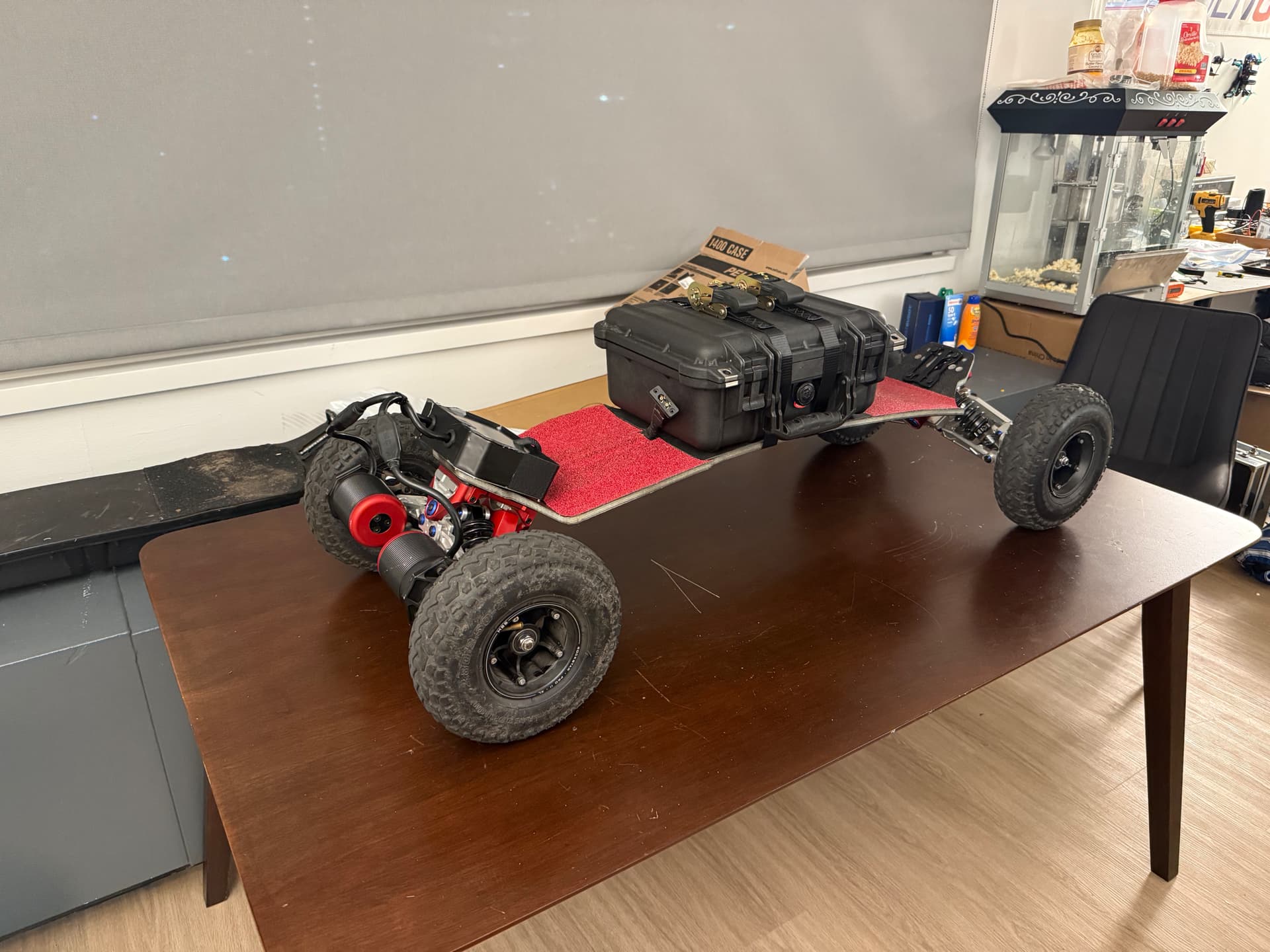

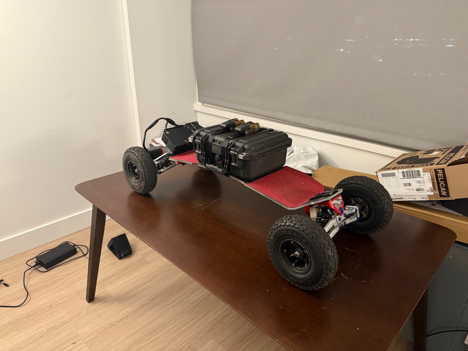

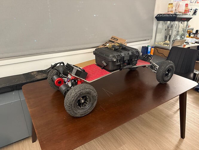

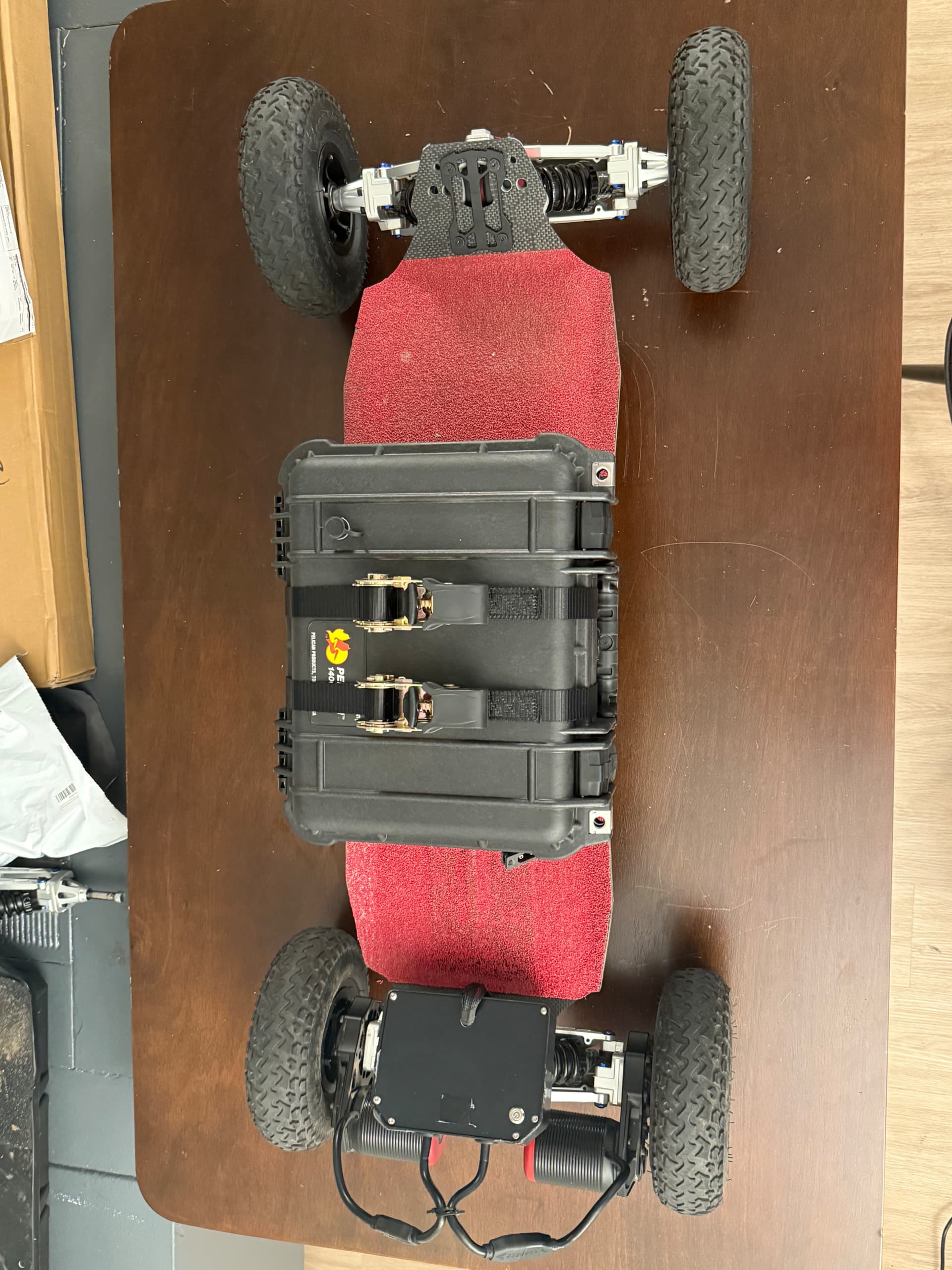

She’s all done (pending battery)! I’m patiently awaiting an 18s8p p45b pack from @MichaelWA. This thing is gonna be an off-road beast. Specs below:
  • Acedeck suspension trucks, element gear drive, 6890 motors
  • Kaly 2.0 stiff deck (allegedly one of the first that Ernesto made)
  • D100s
  • 18s8p p45b brick pack in a pelican 1400
  • MBS rockstar II XLs with 9 inch tires
Dude screw the deck just ride the pelican case holy cow :joy: how do you even have room for your feet???
Nice work I actually was wondering this
Yea dude we’ll see :joy: . I think I should be alright, I’m more worried about the ESC box than the pelican. If there isn’t enough clearance I’ll prob deck swap to a Deathwish.
Might dig into the sidewall of your shoe a bit.
