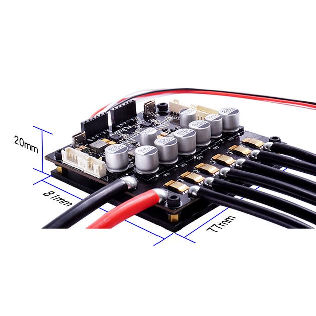

Now, I am tired of Enertion and his null response still paying the warranty of his product. I really want to go out with my own assembly. For what, I was looking to buy the Dual VESC from Flipsky, but I can’t decide, because I can’t find the difference or which model of these two would be better.
Somebody could help me?
I have a 10S5P setup with 80A battery current and 190KV 6374 TB motors.

The first one has more power and will run smoother, if you’re making a off road or racing board it will be better, second is good enough for a street build

Thanks! But is too much height for my enclosure.

I wouldn’t take the one with built in antispark, because the antispark is prone to fail.
I’ve heard capacitors were better on the second one.
I don’t think the first one will give you more power than the second one.

I have the non-plus 6.6. It has been reliable for about 250+ miles of riding with up to 70A per motor and 32A per VESC from the battery.
My only complaint: the voltage monitor is terrible. It is useless for determining remaining capacity.
Better the devil you know. I have damaged 4 flipshite esc it usual the antispark that dies easy to bypass. But my 4.2 duel died yesterday. Worked well for 2 weeks on 10S but upgrading to 12S on motor detect one of the becs died. I bought from hglrc.com so 6 months warranty instead of 2 months flipshite warrranty. I have older 6.6 plus still going strong on 13S dont use the antispark as I need to power a buck to power my lights. I use a homemade 200Amp A/S and not flipshite amps. Next build i am going to try the maytech or maybe torqueboard will come up with some duel vesc goodness.
