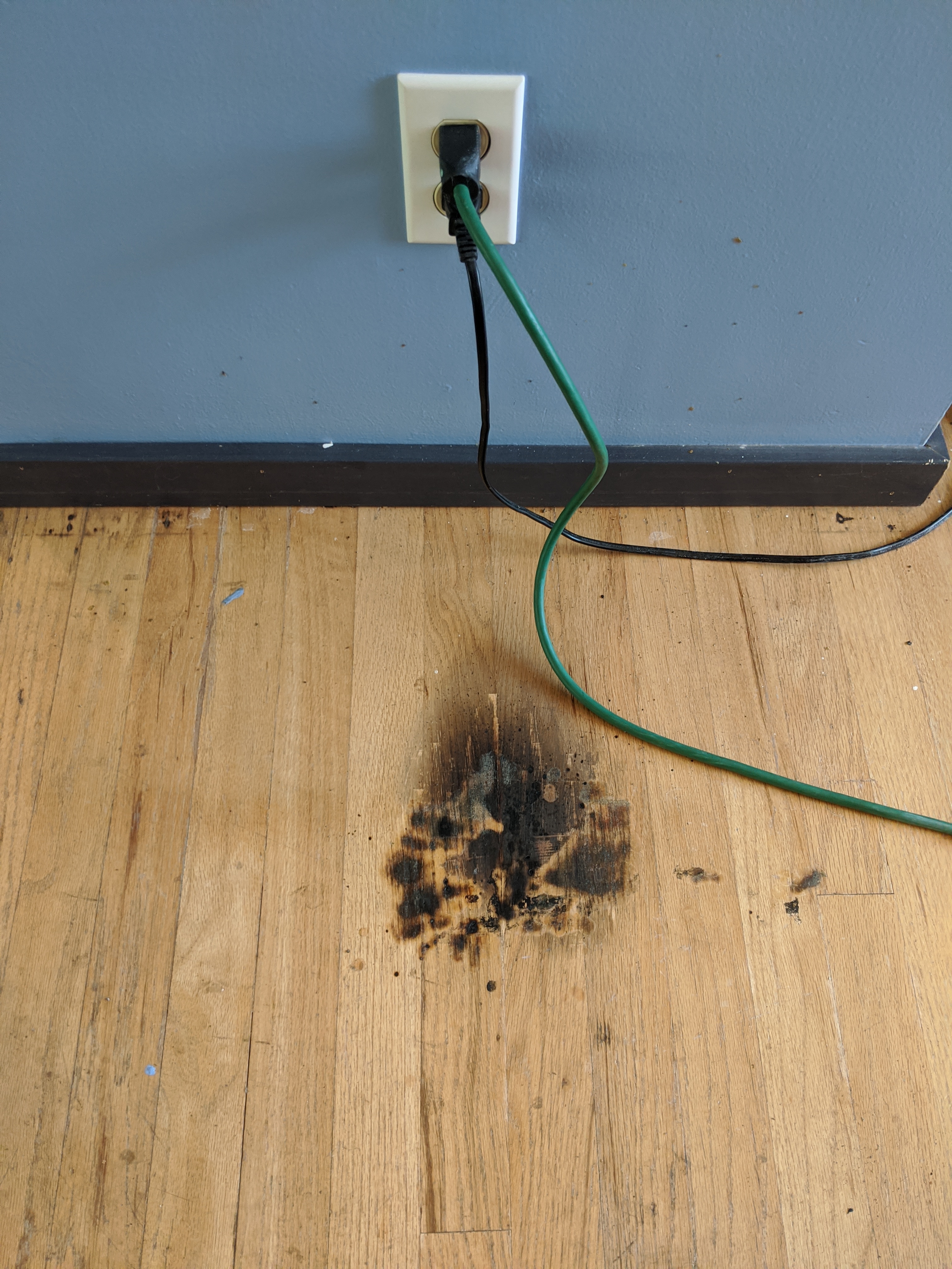

Miraculously I am working from home. I hear a pop, but I ignore it since all the windows are open I assume it’s something outside, but when I hear that hissing sound I know exactly what that is. I run down and sure enough, flames are just starting to come out from the board.
I grab it and drag it outside onto the grass in the back yard, turn on the water and hose it down. Puts the fire out no problem, but the batteries are still hissing. So I just keep watering it. I also put out two small grass fires.
Finally I get it to the point where it’s no longer combusting. I take it into the shop, remove the orange cover, cut out all the wiring and start to remove each battery bank (each bank has 10 batteries) The first bank starts to hiss again, so I take it outside and hit it with the hose again.

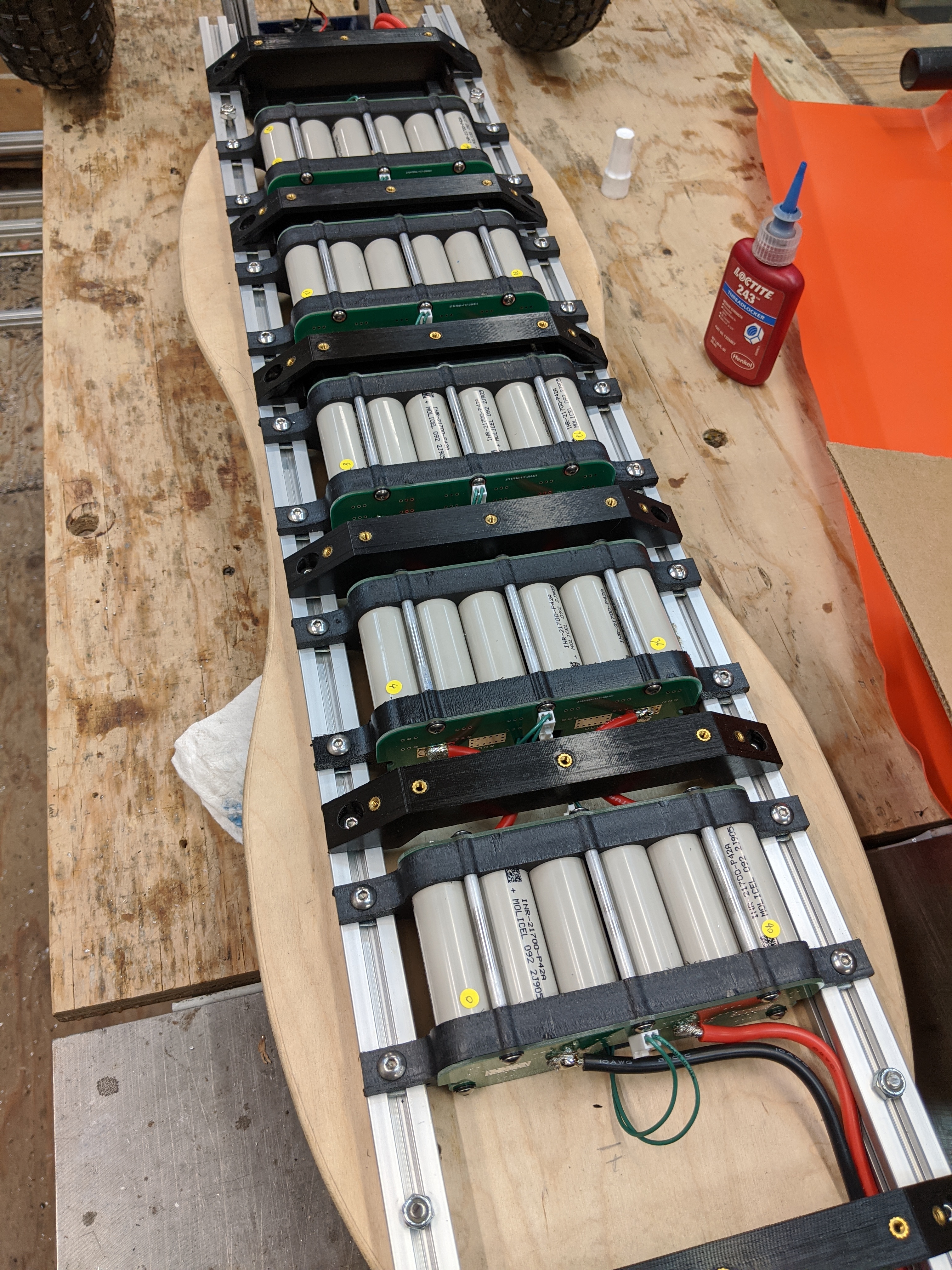

My system of having each battery bank separated by a small distance (about an inch) actually did what I intended for it to do and the fire did not spread to the last 3 banks. It may have not spread to the second bank, but because it was so close it’s completely black so I can’t really tell until I do a full post-mortem.

this picture was taking during development, the wires were routed after this. Notice, though, the orange circle. This is a screw terminal that connects to the volt meter. The pins are 0 and 40V - full voltage, and they are only 0.1" apart. This is where the first fire started.
This charge port has been essentially the same since the very first build. It has survived rain and hail. In this case I even made little caps to put over the white plastic connectors to keep the sand and water out of them.
My best guess is that wet sand got between all the connections and began to conduct. As it conducted it heated up. As it heated up the solder started to melt and at that point the mixture of solder, sand and salt water created a dead short from all battery connections to the ground plane.
What I don’t understand is how a fire starts 15 hours later.
The irony is that I used to have PTC fuses on every balance wire to handle just this sort of thing, but I took them off because they wouldn’t allow me to do high-current charging.
I guess I’ll be putting them back on, and redesigning (and conformal coating, and 3D printing a cover for) the charge port. However, I might not ever bring the Sand Runner back. I might retrofit my other two boards with newer safer charge ports and re-introduce the PTC fuses to make sure the other two boards are safer, but it seems like salt-water and electric skateboards might not be such a good idea.
I got to it before it could seriously damage the floor, but still, that’s going to take a bit of sanding.
