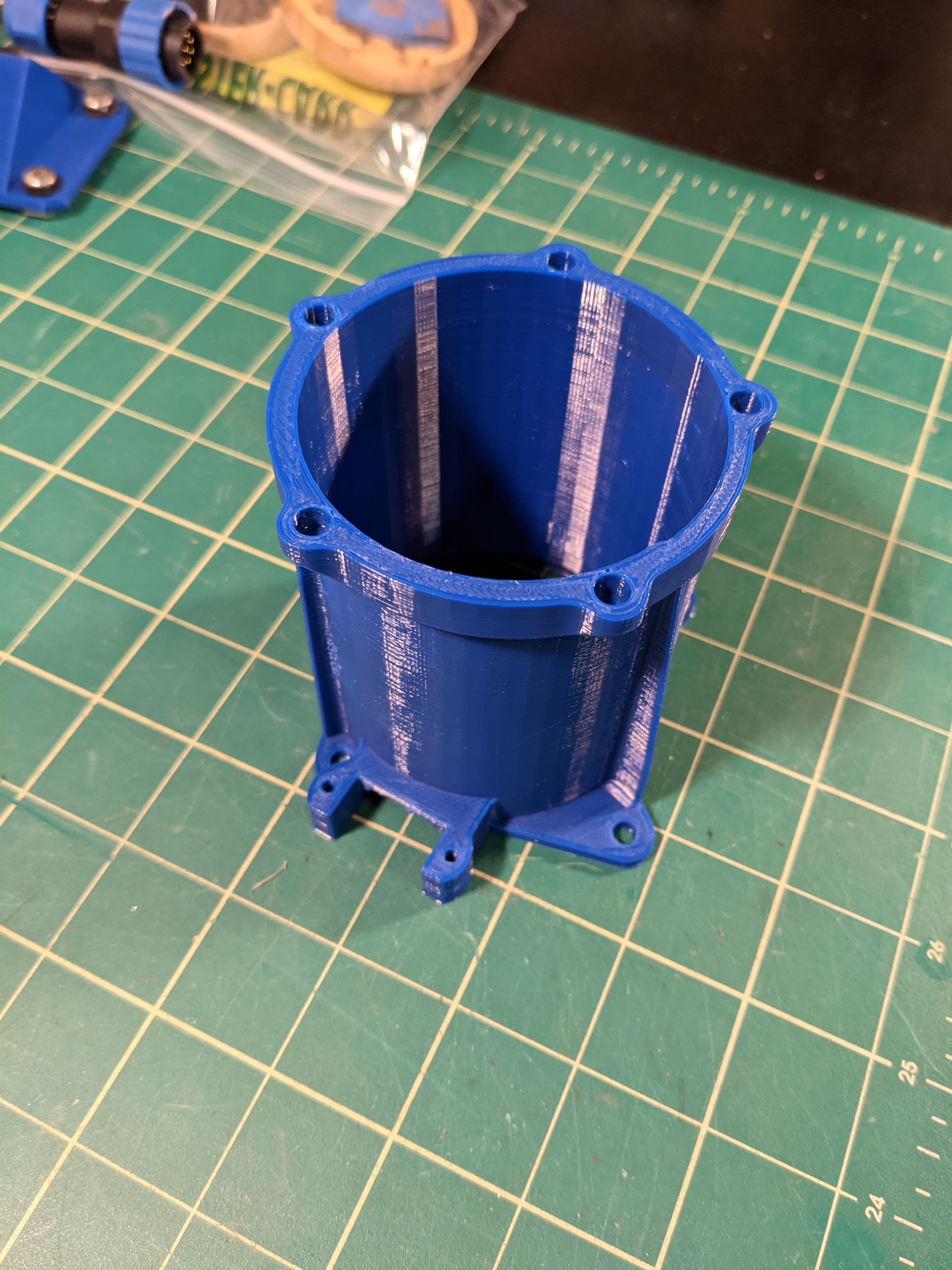

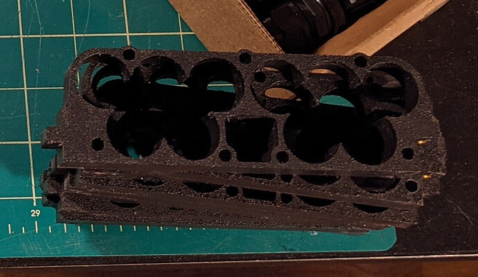

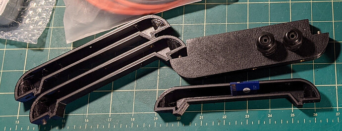

So I started by re-printing and cutting all the parts that burned, melted and otherwise smelled funny after the fire. This was basically everything plastic that was in the battery box. Most of them were 3D printed, a few of them were 2.5D CNC carved.
Here’s some of the new 3D printed parts (in PETG this time but otherwise the same part):
and the new battery cage ends:
Note that the way these mount to the frame has changed completely. Where the old ones bolted to the bottom of the extruded rail these slide inside the rail and have a mount clip that holds them in place. This way I can close up some unfortunately large water entry points.

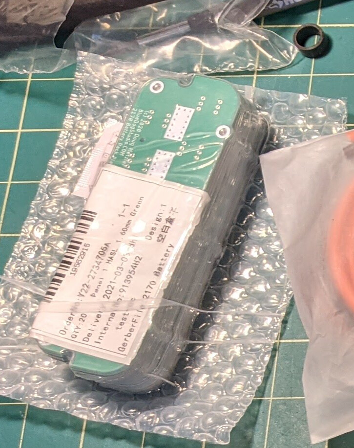

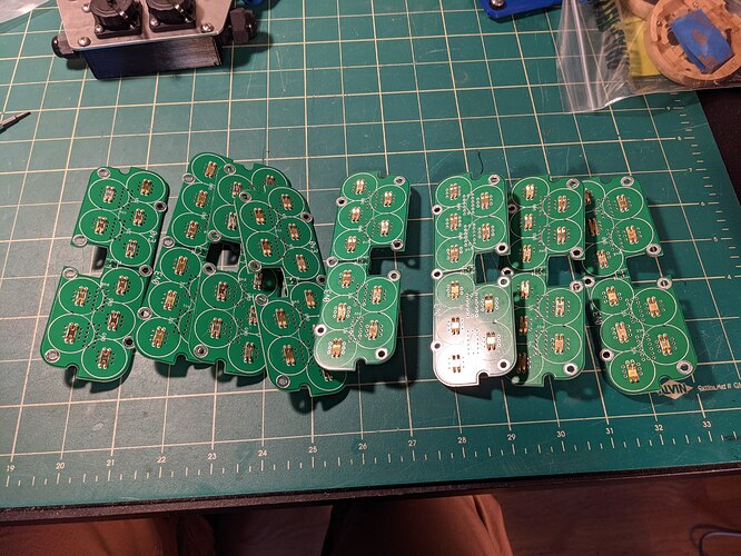

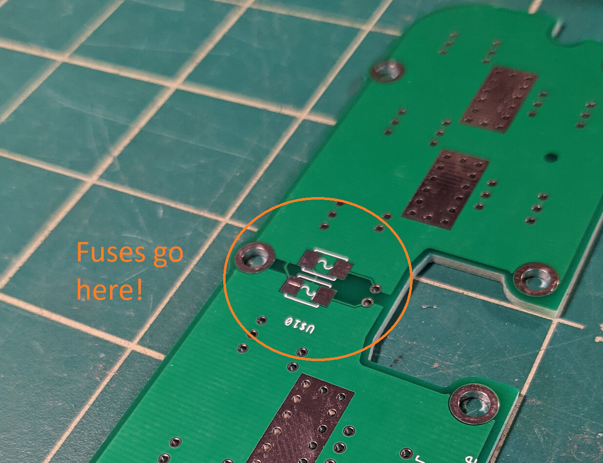

The new circuit boards:
which have fuses on them (see, I can learn from my mistakes)

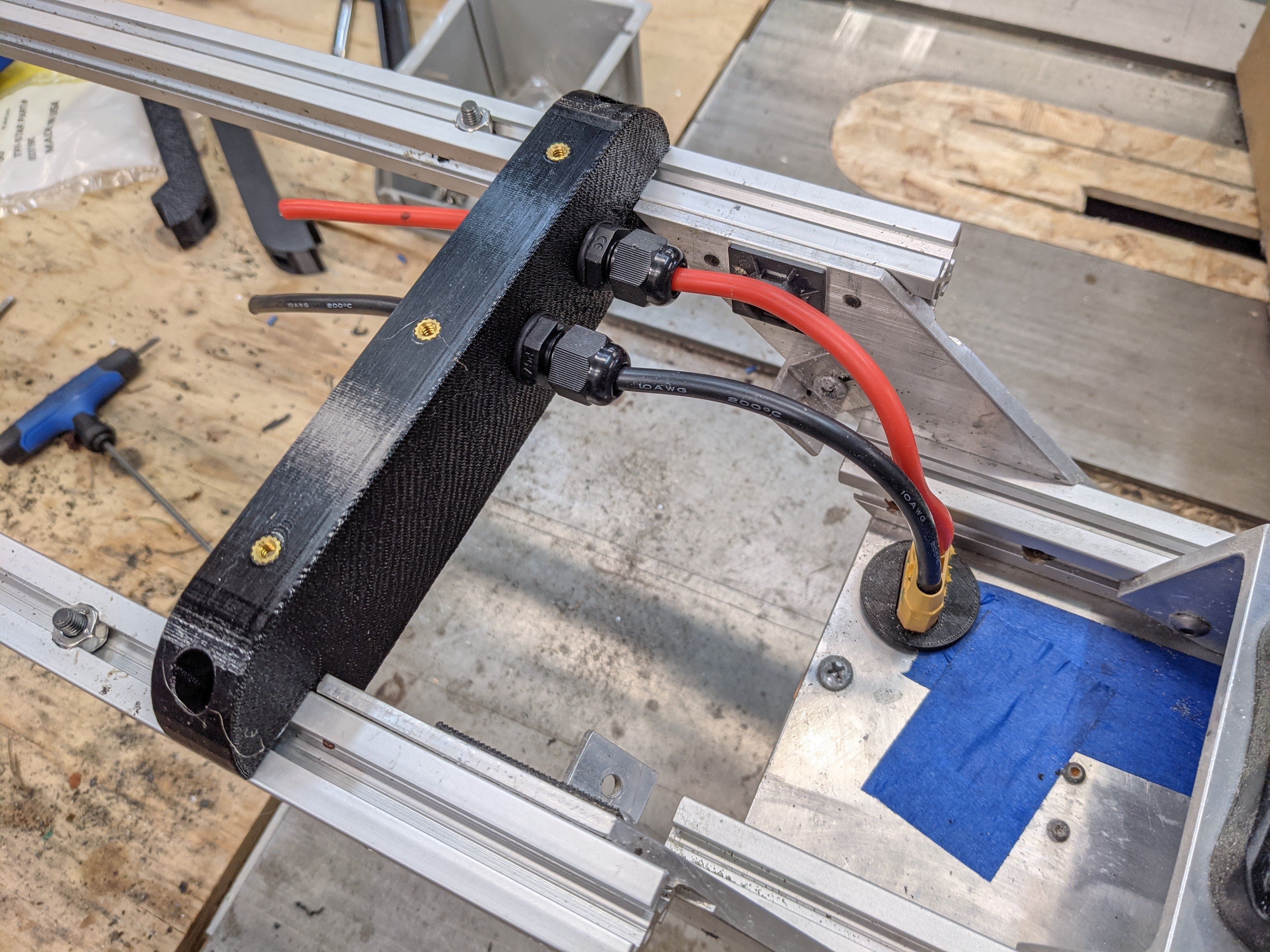

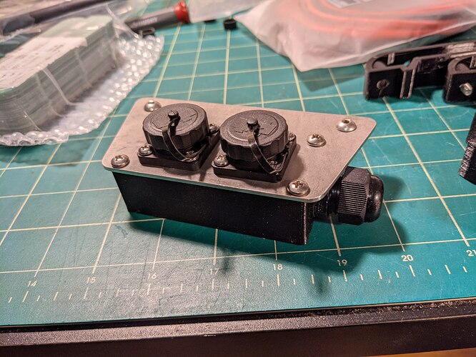

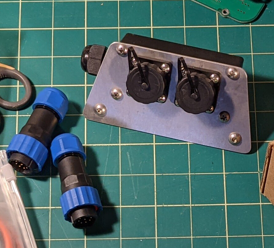

And here’s the new charge ports:
I went seriously overboard on making sure that no salty water came into contact with, well, contacts.

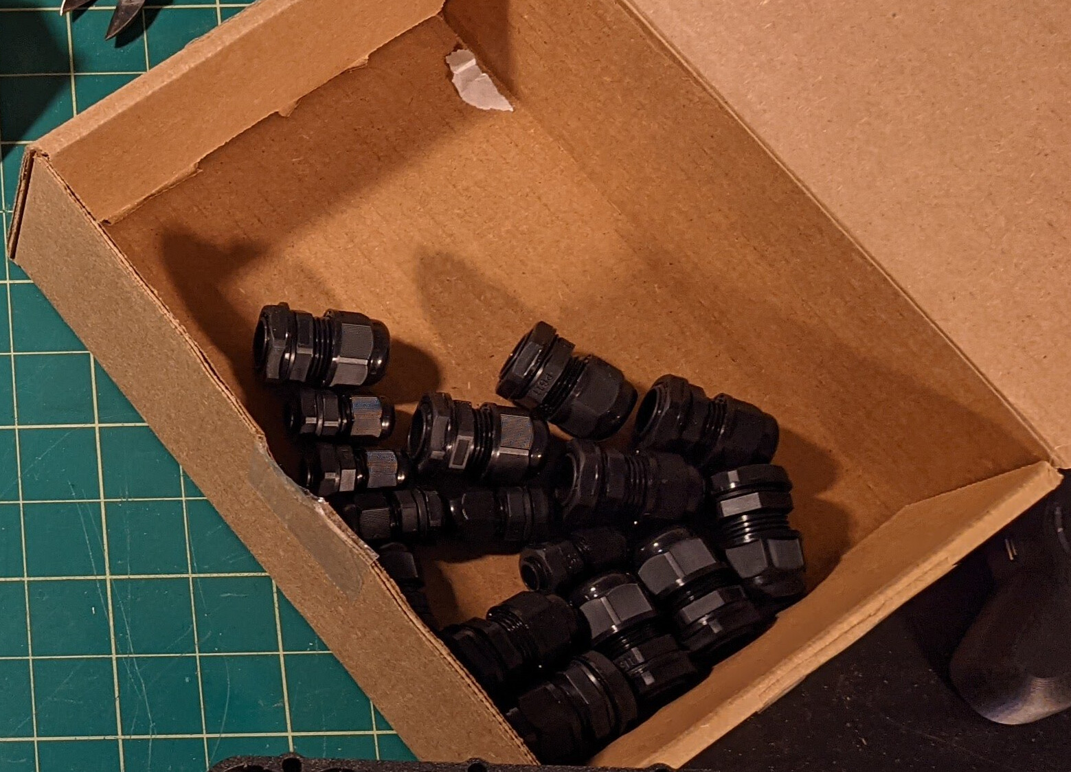

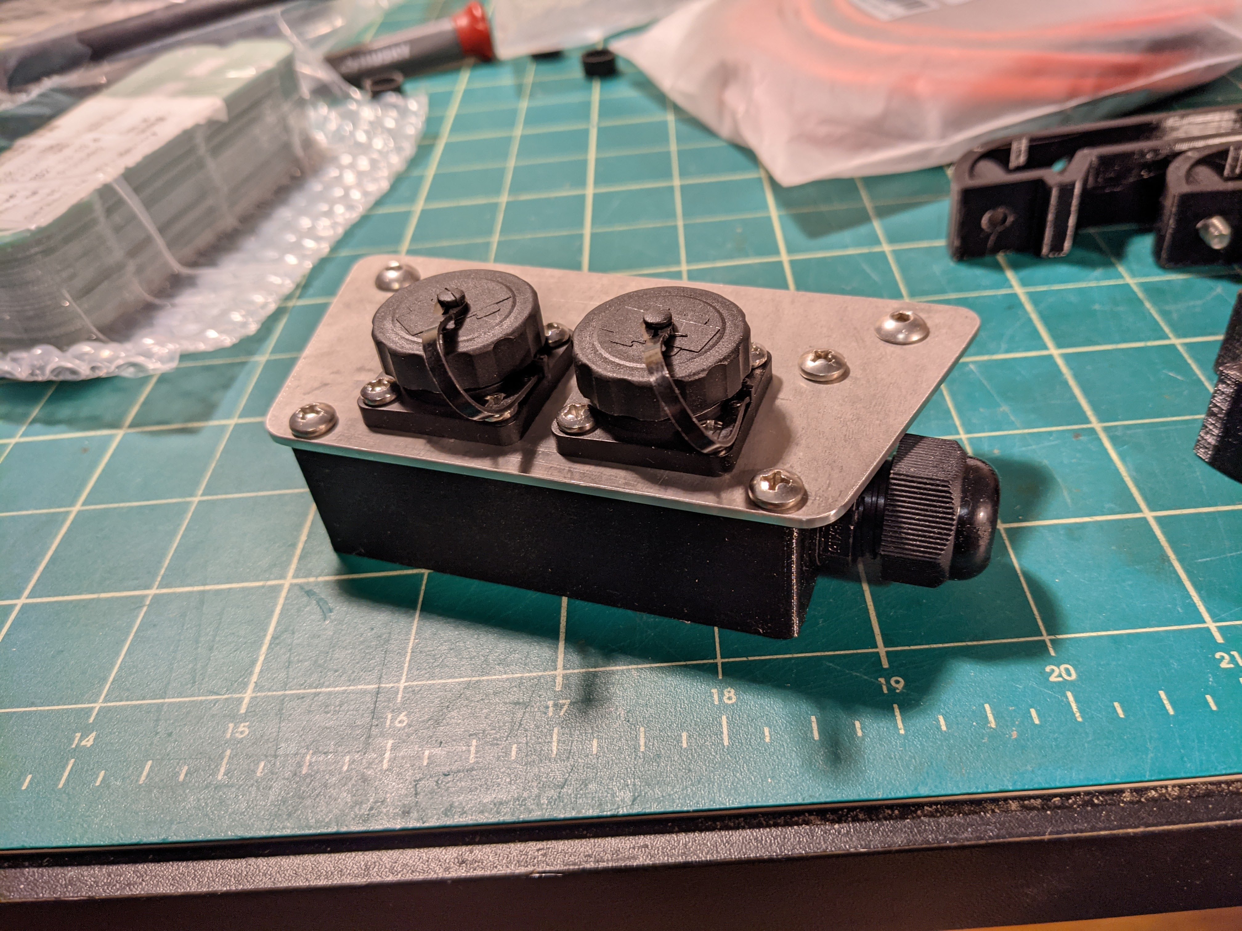

Now, on to more thorough waterproofing. I started with Bud fittings (Gland fittings if you are Googling or Amazoning). These are basically IP65 rated wire seals. Here’s a bunch of them in a cardboard box
and while this isn’t a great angle for showing how they work here’s a shot of them attached to a battery box end cap.
Oh, wait! here’s a nice shot of them in dress rehearsal:
(don’t ask about the blue tape. That was a really bad day. I’ll fix that eventually)

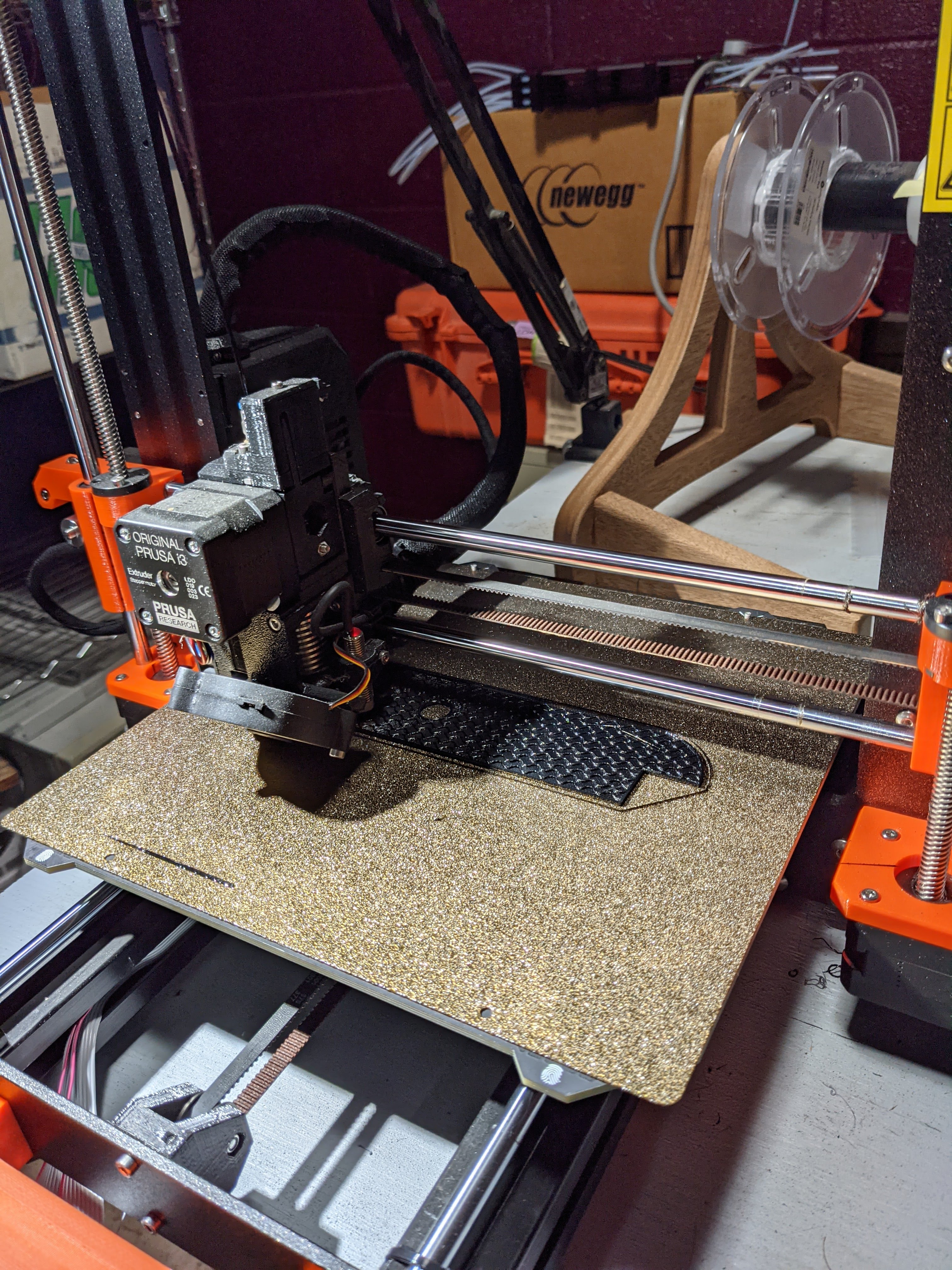

Here’s a sexy shot of the parts being 3D printed on my bling print bed:

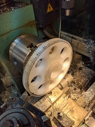

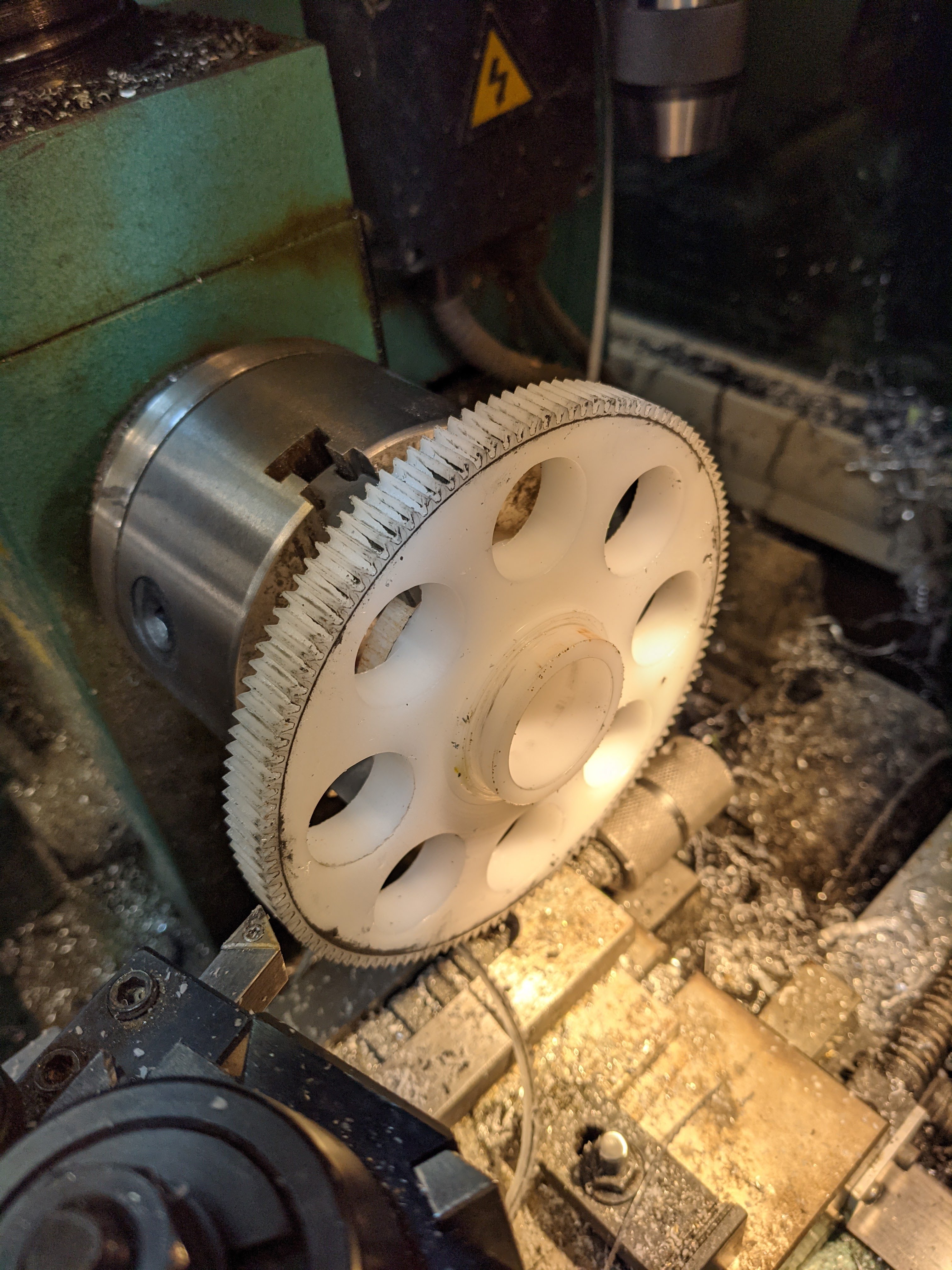

I had to crack the transmissions because there were a few shortcuts I took in the original build that left un-checked would have allowed water in. And I have these shiny new 6380 sensored motors that I wanted to replace the old un-sensored motors with.
While I was in there the I noticed a couple of problems.
The first is rust. A lot of my screws weren’t stainless steel and really took exception to being soaked in salt water. So I’ve got a lot of stainless steel screws on order.
the second is that one of the drive gears was rubbing on the plate underneath it, causing a lot of scarring and eventually probably would have locked up or at least made a lot of noise.
The third is that the driven gear was a little too wide and rubbing against the bottom of the drive gear and might have been causing the driven gear to not quite settle into the housing straight. Might have been at a bit of an angle. Based on the scarring it wasn’t too bad, but I machined out the black stuff so it has some clearance now.

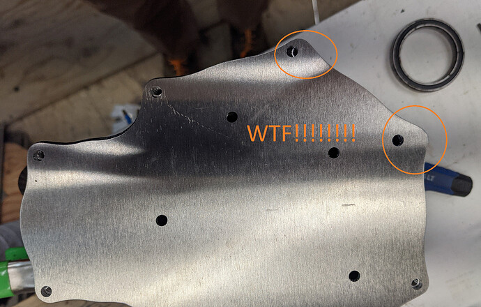

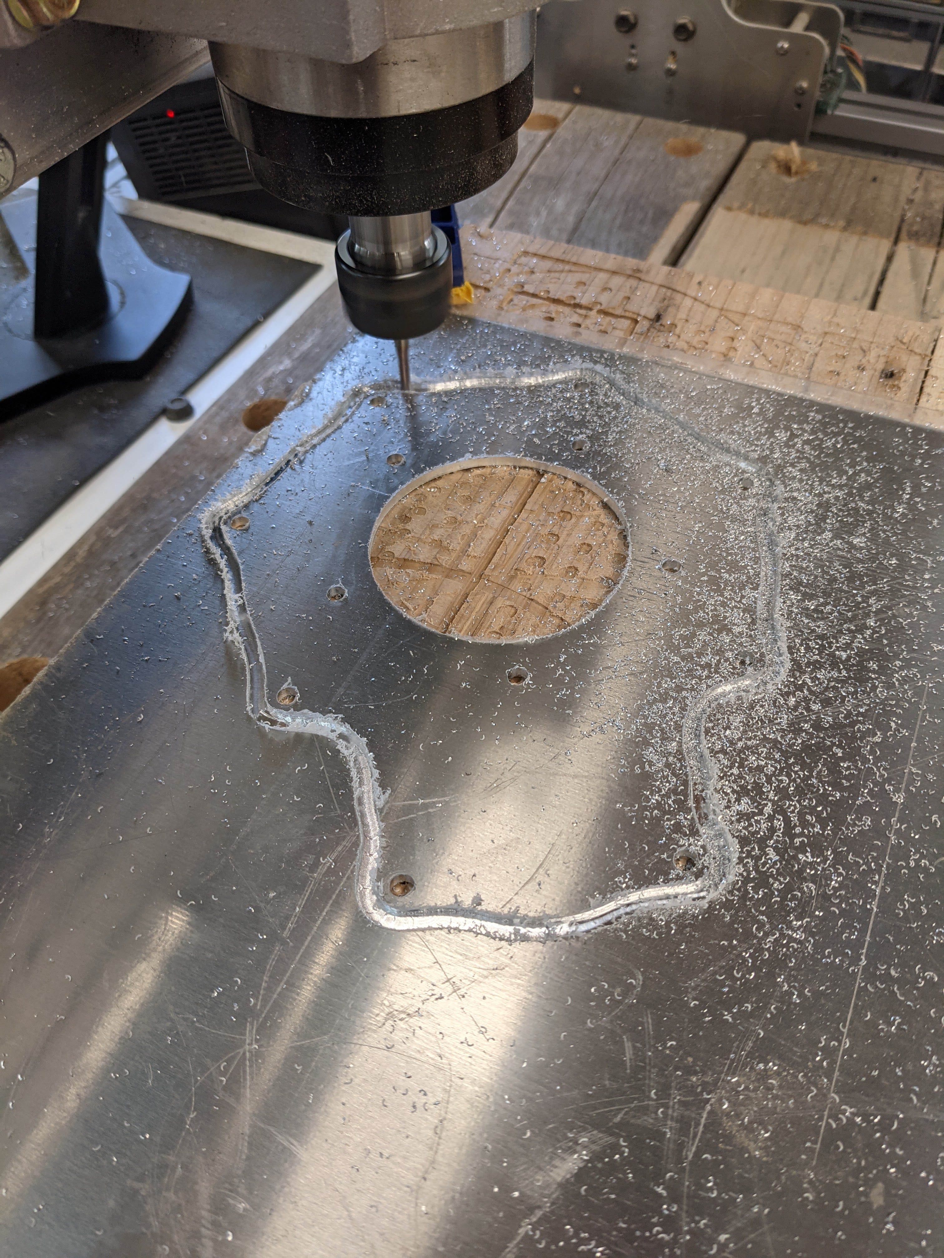

This is where things get weird. The outer cover didn’t change at all from the first build, but when I went to cut a new one my holes went a wandering:
The holes are the first machine op in the script, the outline is the second, so the fact that the outline cut perfectly means the machine didn’t lose track of anything, these two holes are obviously the result of bit rot.
So I re-built the job in CamBam and re-cut the part et voila! Perfection:

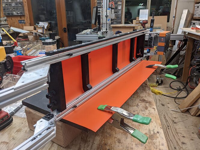

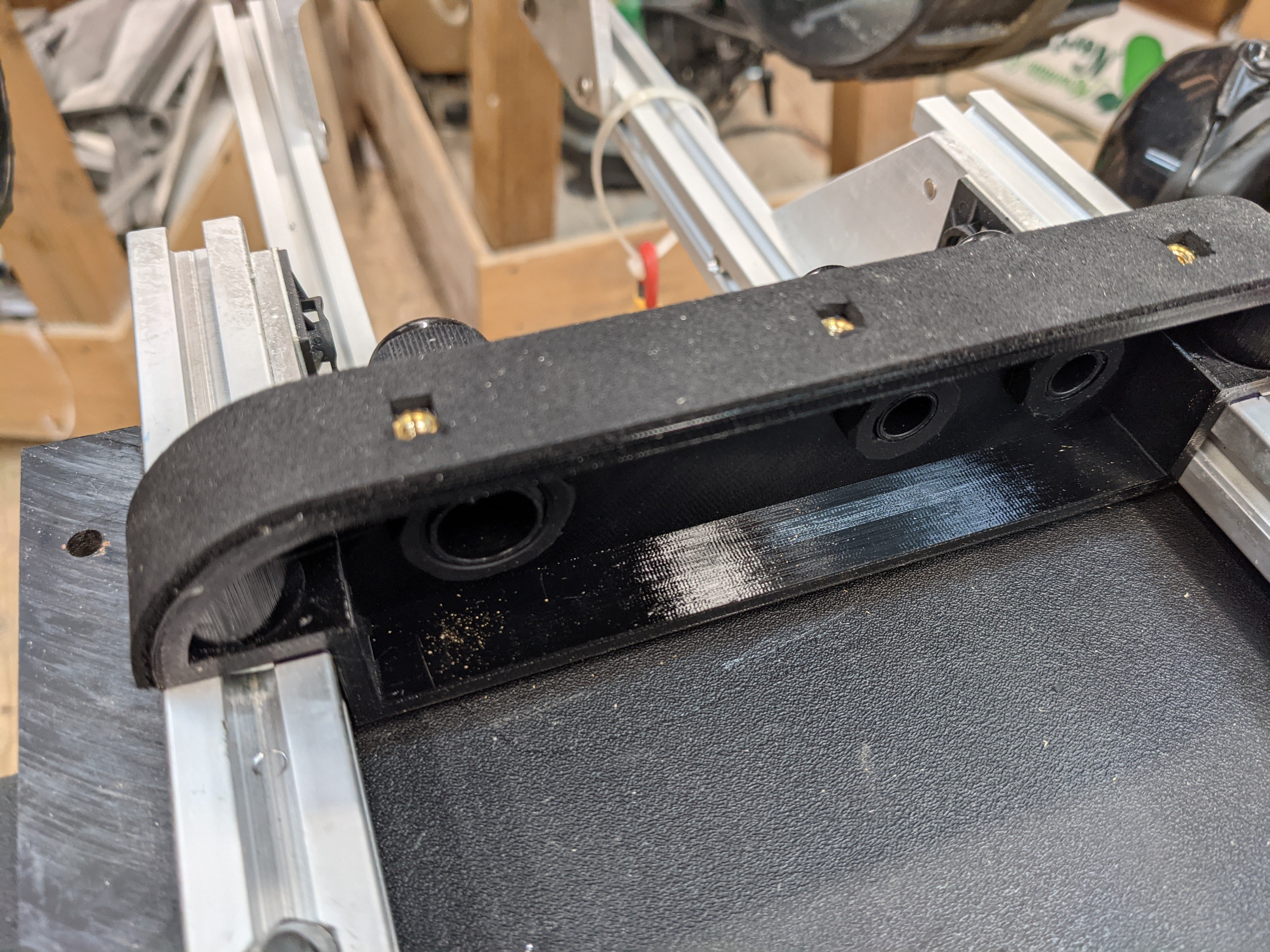

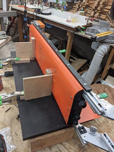

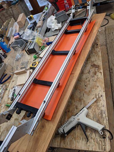

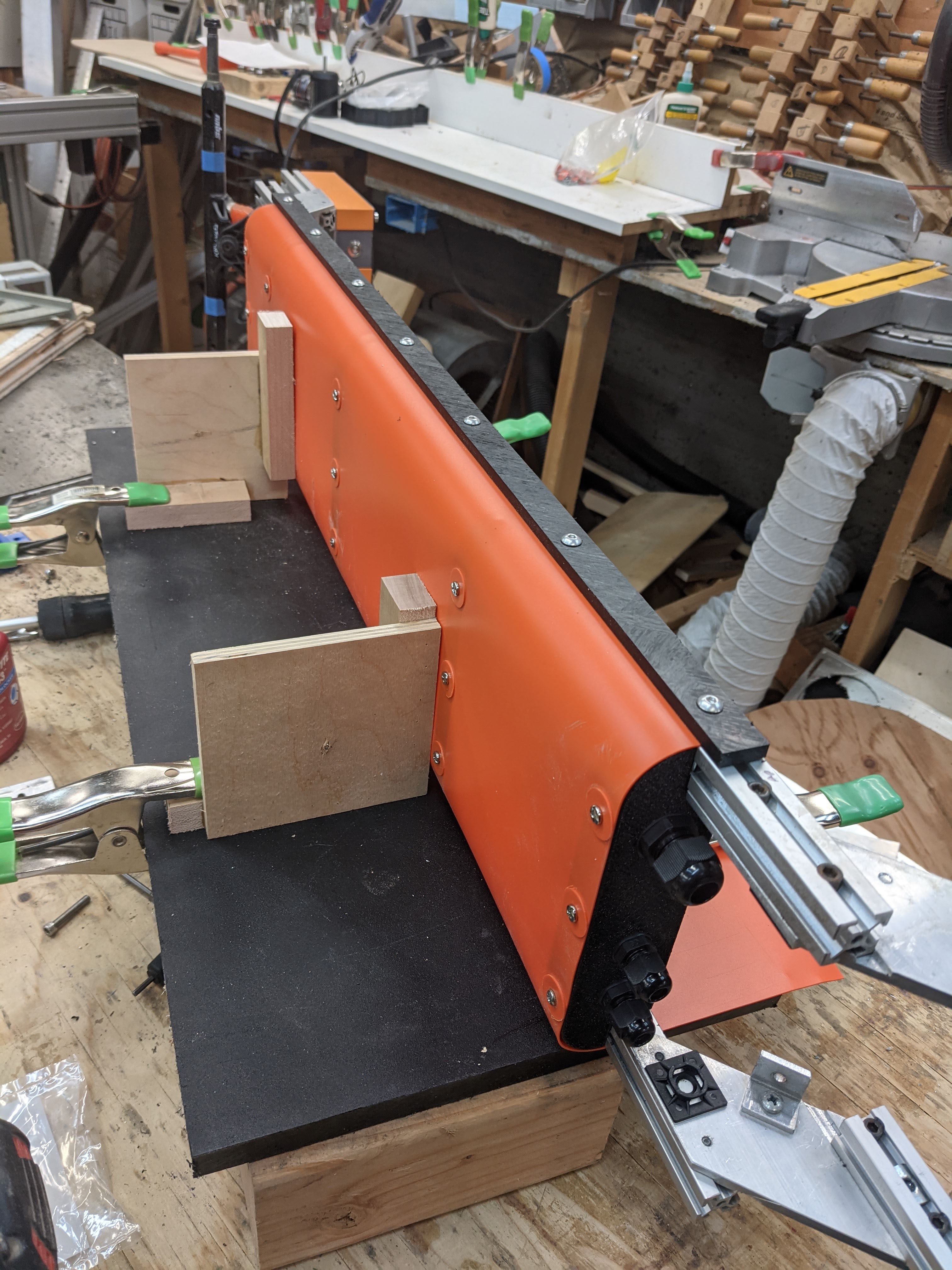

While that was cutting I worked on the battery tub. It has to be as waterproof as I can get it, but also the screw holes have to line up between the extrusion, the orange plastic, and the black plastic reinforcement strips. No small feat.
Lots of time was spent marking and making little fixtures to make sure all the holes aligned, but in the end it went together pretty well.
I noticed during the process of building this that the orange plastic does eventually form to the curvature I forced it into, so my plan is to leave it together for a couple of days, then go back, remove it, install the closed cell foam (told ya I was going to talk about it) between the orange plastic and the end caps to make the seal waterproof.
Another foam seal will go along the top of the end caps and the top of the extruded rails, and will seal to the wood deck. That should give me good solid IP65
Well, almost. The channels in the extruded rail are a clear and thus far unobstructed path in, so I’ll jamb those up with blobs of foam.

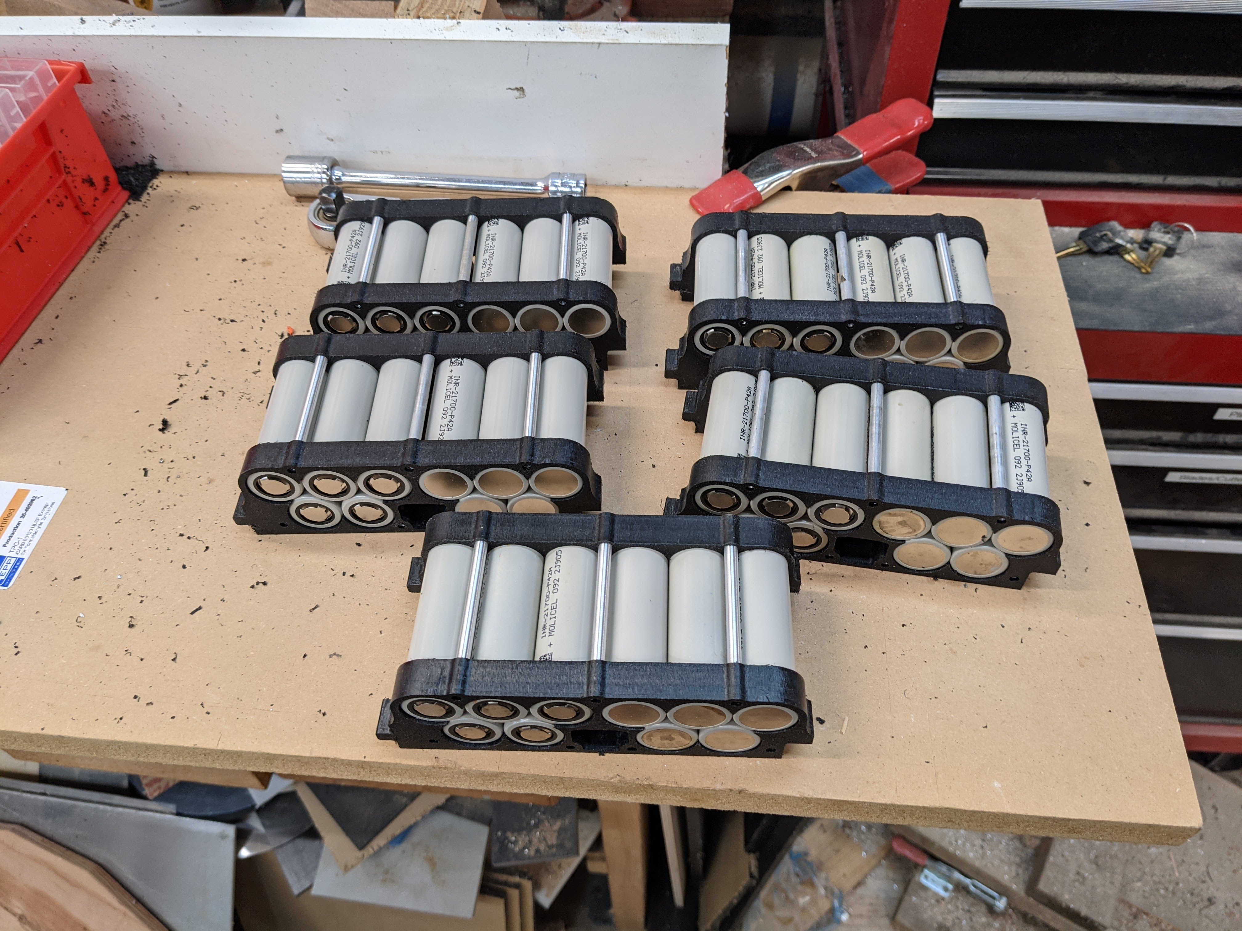

Aaaaaaand we’re off to build some battery banks:

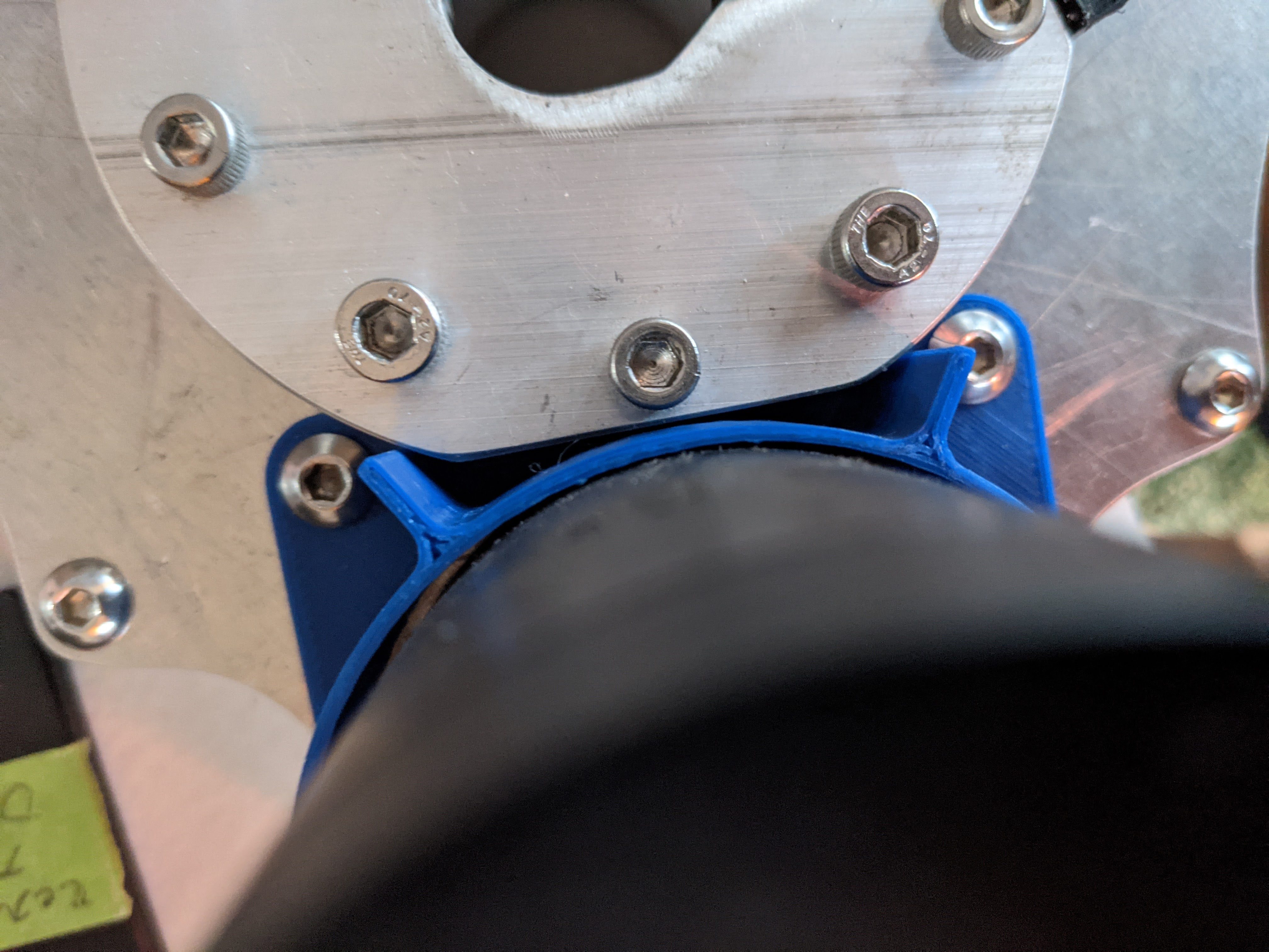

Next challenge was that because a long long time ago I decreased the number of teeth in the drive gear to try to get more power the result was that the location of the motor moved too close to the truck mount
So I had to do a bit of singing and dancing to get the motor cover to not interfere with the spinney part. But they look kinda cool.

Next up was final assembly of the tub. I installed the closed-cell foam on each of the end caps
and reassembled the whole thing hopefully for the last time.
I did figure out what I’m going to do about the channels in the extrusion. One of my favorite glues, for many weird reasons, is E6000
because it holds really well but comes off clean.
I’m going to try to get it into a syringe and inject it into each of the channels to seal them up. I was going to use hot glue but once it cools it doesn’t stick very well and is likely to pop out.
Next up is completing the battery cages

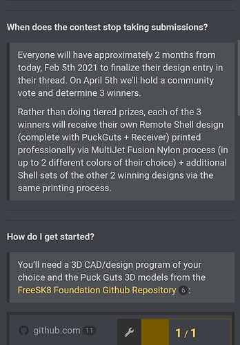

And one funny story (you know, funny in a sad and frustrating way). There was a website that had a contest - design a custom housing for your Hoyt remote and if you won they would send you a free professionally 3D printed version of your housing in nylon and a complete set of Hoyt guts so you could build and use it.
I got super excited, and I actually, because I’m trying (and mostly failing) to become a Youtube sensation, recorded the entire design process, and went to enter aaaaaaaaaaand, the contest had ended a month prior.
But here’s the design - I went ahead and got a version printed and I’m going to use it on the maiden voyage of the new Sand Runner.
The thing I like about this design, and the thing I don’t like about the Hoyt, is that the circular version of the remote doesn’t give you very positive location feedback in your hand - so you have to carefully adjust how you hold it so the thumbwheel is always in the right place.
My version solves that problem, but creates another problem, which is that the remote is specific to left-handers. Or maybe right-handers. I’m left handed but I hold the remote in my right hand. I assume that right-handed people hold the remote in their left hands. Maybe they don’t.
Anyway here we are. If you look closely you can see little bumps in the remote. Those are because the Hoyt screws are too long and I didn’t realize that until they became unusually tight :frowning:
ā€œa websiteā€
Lmao idk just was funny, I thought everyone knew about freesk8
Love this design @DougM! Very cool. Is the stl available so one might be able to give it a try?
Finally I’ve been waiting for the revival of this project. I’ll be following
Hey Doug-
The contest is still ongoing. Please submit your design when you get a chance. I like it!
Ends April 5th:
@BillGordon this is great news! I guess I totally misread the entry deadline :slight_smile:
I’ve Submitted my design to the contest.
@Lionpuncher The STL’s are in the above submission, if you print the remote post pictures please.
