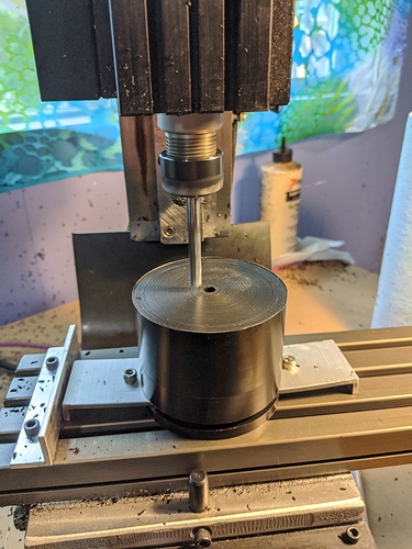

The 3" Delrin rod arrived.
I decided that the most accurate way to cut it would be to CNC the top holes, which included the interface holes, so I threw it on the lathe, turned it more or less round and put a 1/4" hole in the center, then using that hole centered it into the mill.
Then just push the green button and out comes the top of the part
Then I manually turned down the other end (that will fit into the hub of the Kayak Carrier Wheels).

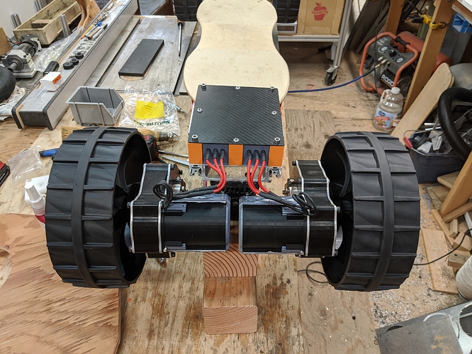

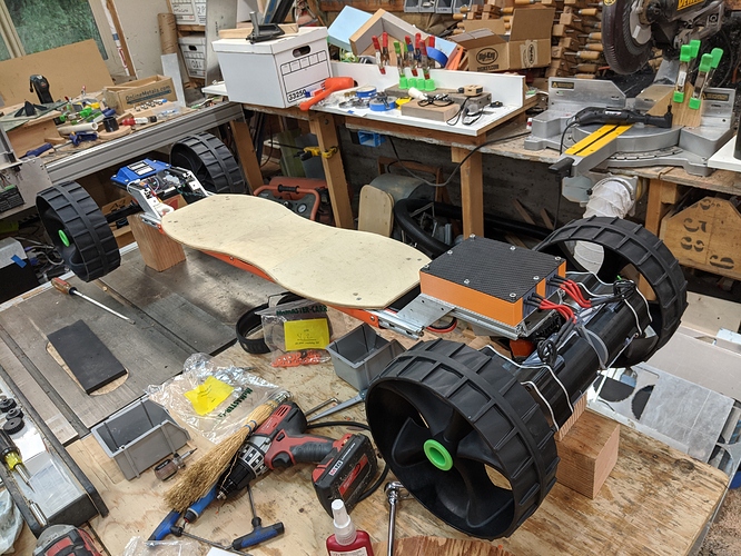

Here it is mounted to the truck, but not interfaced to the gearbox.
I did this 3 times. I know what you’re asking, why 3? Well, because I totally screwed the first one up and the outer bearing alignment with the inner bearing was 060 out which gave it an alarming amount of wobble. So that one had to be binned.
Also, in a moment of inattention I turned the wrong bearing OD on the wrong side, so I had to sleeve it, which wasn’t nearly as hard as I thought it would be. It’s nice to know I can save screwed up parts by sleeving them.

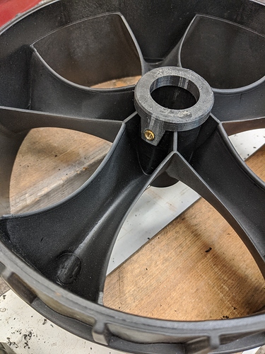

I’m waiting for a 90 degree micro-drill attachment for my Dremel so I can drill holes in the Kayak Carrier wheels to mount the hubs. It is supposed to arrive tomorrow, so with luck I’ll be back out road testing this thing by this weekend.

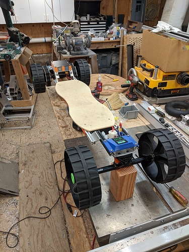

Managed to wrap it up tonight!!!

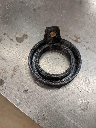

The tricky part was drilling the holes in the rims to lock the hubs into place. I 3D printed a fixture to drill the hole in the right place (sacrificed a heat-set insert so the drill operation wouldn’t eat away all the plastic)
then I waited somewhat patiently for a right-angle attachment for my Dremel to arrive
After that it was just a matter of pressing the hubs in, putting a screw in
and baby’s got 4 new shoes
Also, here’s a shot of the display panel. The top one is volts and the bottom one is amps
Unfortunately I’m bound after work for the next 3 days, but I hope to get it out this weekend for some grass testing.
My big concern is that the way I designed the battery pack it isn’t going to allow enough current through to push the motors and it will generate a lot of heat.
That’s what the Ammeter is going to tell me.

Those wheels looks funny on this board, are they sturdy enough to widstand thr weight and vibrations ?
Curious to ear of the in situe tests
Congratulations for all your work.
I’m very curious to see how the wheels will handle the job.
What kind of wheel is it exactly? (there are some golf cart wheels that look similar).
It’s probably the way to use larger wheels without being too heavy to be ridden…
@Plurf, @Flexboardz,
They are kayak carrier wheels - they are surprisingly tough and lighter, with a bigger footprint than the rubber tires. I too am interested in how they fare :slight_smile:
They are rated at 500 pounds each, so no problem carrying my weight.

What’s the diameter and contact patch? My friend wants to ride her MBS board in the beach and this looks like a mod I can do
10" Dia, 3.5" width, but since they aren’t inflatable the contact patch isn’t that big - but since they are flat edge to edge I think it’s a lot better than a rubber tire, which at that size seem to bulge in the center.

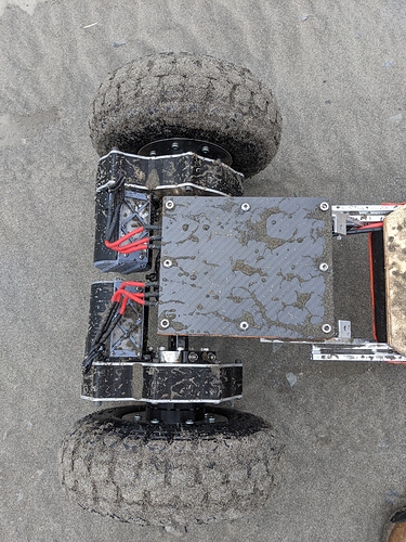

Much more important, I’ve found, than the tires is the sand condition. The first time we went out it was on my mountain board, which has 8 by ~1.5 standard mountain board tires and it worked great, because the sand was heavy and wet and a much larger part of the beach was wet.
The most recent time we went out, to test this board, it was soft and damp, and most of the width of the beach was dry sand.
There’s no way you’ll get over dry sand without 4WD and even then it’s iffy. Soft wet sand isn’t much better. So whatever conditions cause the sand to be heavy, wet and wide (low tide maybe?) are the best conditions.

Seems like the best solution to soft sand is horsepower, 4WD and big paddle tires. The problem is that the machine becomes really heavy because of the amount of battery you’d need.
I tried to drive the Sand Runner into the soft sand with no rider (just the board) and it bogged down immediately and just spun the back tires.
I’m ok with only riding on packed sand, that’s the most fun anyway because it’s tangentially similar to snowboarding (you can kick the back out, etc.), but I wasn’t expecting the beach conditions to be so variable. Now I’ll need to look at the tide tables when planning my trips.
