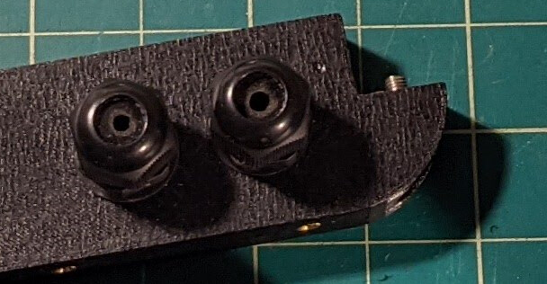

I went seriously overboard on making sure that no salty water came into contact with, well, contacts.
Now, on to more thorough waterproofing. I started with Bud fittings (Gland fittings if you are Googling or Amazoning). These are basically IP65 rated wire seals. Here’s a bunch of them in a cardboard box
and while this isn’t a great angle for showing how they work here’s a shot of them attached to a battery box end cap.
Oh, wait! here’s a nice shot of them in dress rehearsal:
(don’t ask about the blue tape. That was a really bad day. I’ll fix that eventually)
I’ll talk a little bit more about how I’m going to seal the bottom of the box in a later post because I haven’t completely figured it out yet.
