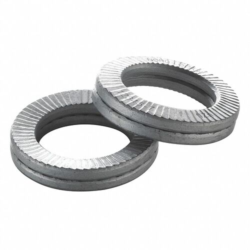

Split ring washers
or like Nord lock washers.
Because the first is totally utterly useless for stopping a fastener from backing out and you’re better off using a normal washer with enough torque. I’ve read the paper, tested the outcomes.
The second are :dizzy: awesome and i applaud you if you’re overkilling it that hard.
