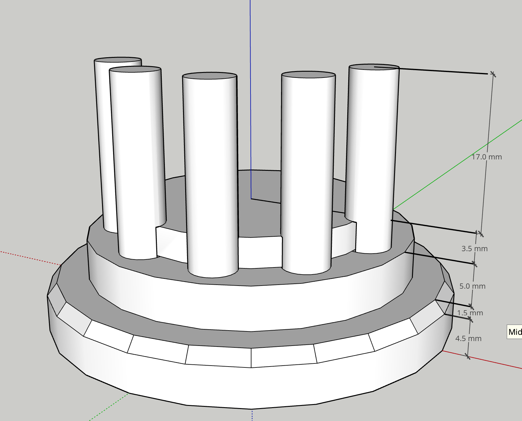

Diameters
28mm (ring part way up pegs)
40mm (Ring Below Pegs)
49mm (top of chamfer )
50mm (Base)
ABEC measurements in case thay fit better
ABEC hight
17mm Top part of pegs
2.5mm ring part way up pegs
5.5mm ring below pegs
1.5mm Chamfer
4.5mm Base
Diameters
28.5 ring inside pegs
39.5 outside of pegs
49 top of chamfer
50 Base

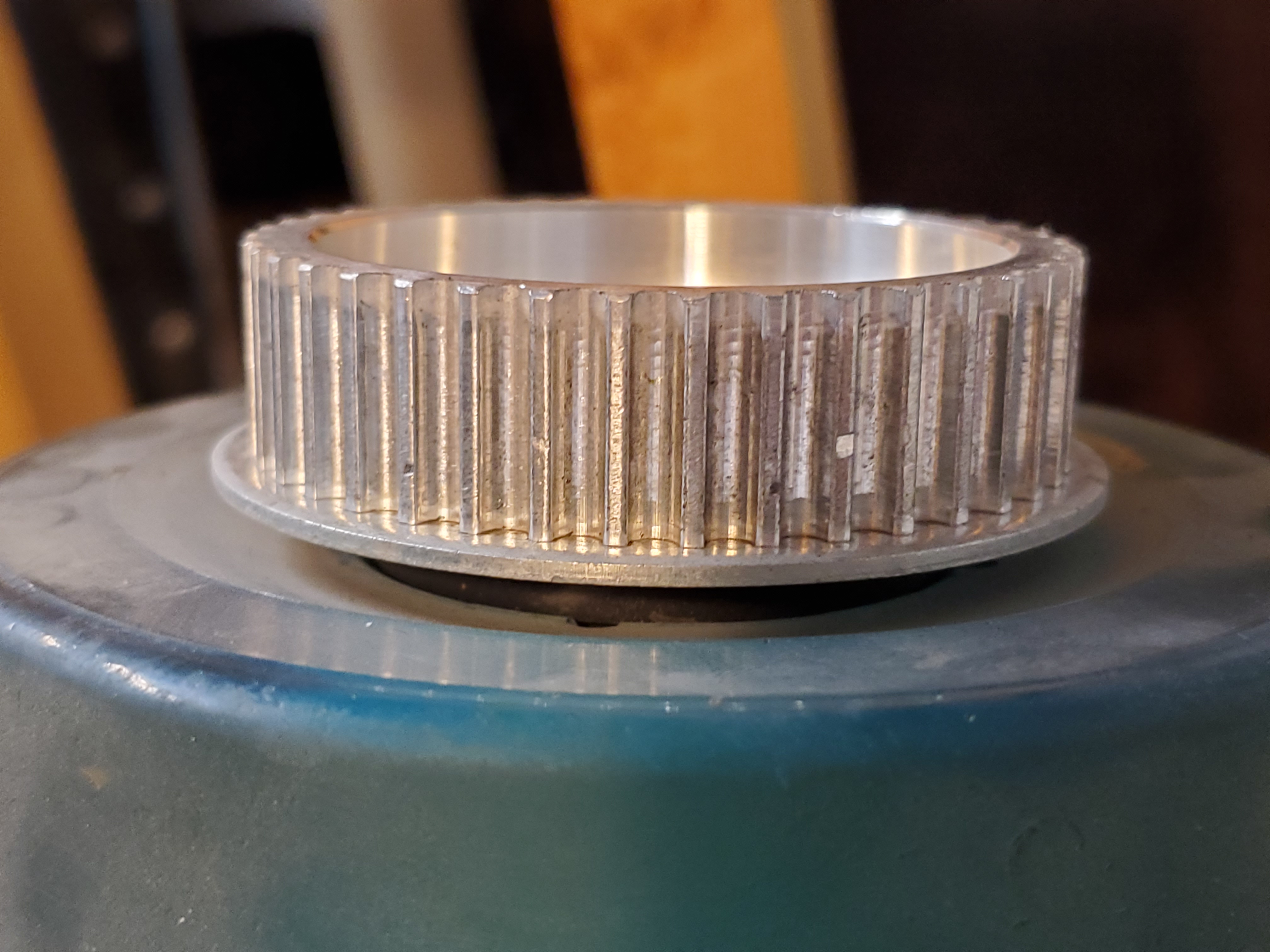

Are those pulleys designed by you? I also want to check your Kegel and ABEC finger fitment too.
Nice looking pulleys!
That is the @3DServisas pulley I also posted with the two wheel adapters.
@fujio001 most definitely
Yes, these two pulleys fit - Kegel and ABEC. Kegel with the exception:
The kegel pegs are long by 6mm. Same thing for the Boardnamics - kegel pegs long by 6mm.
Option A) You’re ok to shave off 6mm off the pulley
Option B) You want me to modify the tooling (Yes, there is space and I think it would be structurally fine, but it is probably an additional 30 days in tooling modification… and also a couple thousand in tooling fees for me)
Option C) Something else…

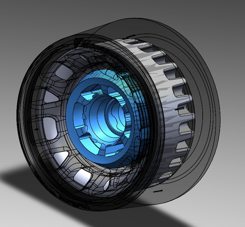

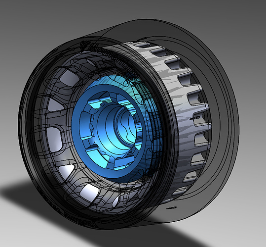

Hollow Wheel update. Please view this link for the latest information
Thank you and I am trying my best to keep everyone up to date.
If you didn’t get an email, please let me know. I am now 100% sure that I got everyone in the email list.
Got mine, I voted for tooling to stay the same despite my complaints, I’ll figure out a way to make it work
I wish I had the contacts to do things like that was just a quick SketchUp and cheap callipers
Do you have a STL file your willing to share? Some of us print prototypes for test fits visualisation.
clarify what you were talking about?
There is a special size washer that goes between the bearing pulley and the wheel bearing, this offsets the pulley so it does not touch the urethane at all. It doesn’t bottom out
Re: BN and 3D pulley. So I looked at the survey results

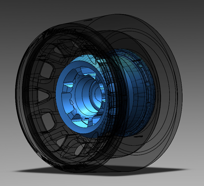

So I took a look to see if it is possible to carve out an extra 6mm from the cover so that people don’t have to remove 6mm off the top of the Kegel pegs. If I take out more material from the current cover, which has ABEC thru holes, the kegel clearance geometry starts eating from the spoke of the kegel and it causes a rotation imbalance and creates some vibrations. The only solution is to come up with
two new tools and also carry an additional SKU, which I just don’t have the finances to back that up. Moreover, there aren’t enough orders to justify that extra tooling cost yet. Hopefully as everything keeps to mature, then I can save up more money to do that.

So is there a option to add comparable pullys to their order?
@TheGoodMomentum
On your website for pre-order it states you’ll email us for kegel or ABEC, but reading through the posts here it sounds like kegel core wheels (pegs on pulleys 6mm too long?) will not be an option. Can you confirm if kegel will be available or not?
