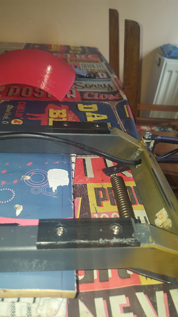

As requested , ignore the absolute s**tshow of the wiring and battery this is all temporary ATM.
Frount end
Some replaceable plastic bumpers on each corner to stop the frame getting bashed up , which as you can already see turned out to be a good idea. That in the background is half of the 3D printed fender for my DIY onewheel project.
Underside as you can see loads of room for cells , Due to rather unfortunate lack of foresight though didnt quite make it wide enough for 2x 18650’s side by side :man_facepalming:
Topside featuring the world cheapest skateboard deck
if you could ignore the weld’s as well that would be good :smiley:.
I can weld good enough to get by but I dont get enough practice really … I usually get pretty good by the END of a project like this.
Thats the sort of thing I was thinking but something smaller and more refined.
the spring is only 120mm long and most of the turnbuckles I have seen are already longer than that. Sure I could fabricate a smaller one but there is a limit before you lose any meaningful adjustabiliy AND on top of that I dont actually know (YET) how adjusting the spring will affect the board and by how much.
Using the two springs I have I know that its ridable without a spring (or a underpowered one) but the steering tends to flop and overadjust , using a overpowered spring means you have to lean the board at a alarming angle to get a small steering output.
But that could be just as much down to learning how to ride it without letting the steering flop Im used to riding a esk8 where there is a force holding the board level and you have to push to “unlevel” and turn.
This is exactly the opposite YOU have to keep it level and to “unlevel” the board you have to “let” it tip by a controlled amount
Needless to say Ive got a lot of expeimenting and learning in my future , as well as no doubt a few bruises and grazes.

Just drill multiple holes for it. The farther away from the pivots, the stronger it will be.
Was that because you were turning very tightly, or was it a more spontaneous thing? I’ve always suspected that putting Drive forces on the front wheel could make a four bar steering mechanism unstable, but I’ve never tested it.
That seems intuitive, but it won’t actually do anything. When the front wheel is centered, the spring forces are balanced, and the centering Force only comes from the change in the spring length. So the only things that work are to adjust the spring rate, or the physical rate at which the spring is extended.
Spring centering makes it easier to balance at low speed, and reduces the steering sensitivity a little. I’ve ridden my own board with and without a spring, and tbh the difference wasn’t huge. The rake of the steering axis has a much stronger effect IMO.

I think it was a combination of things. It was the first and only time Ive had it on full power coming down a hill round a corner and I used the brake which was much harsher then I was expecting. At first Ithought Id just screwed up and overestimated my abilities but upon checking for damage I saw where the paint (and skin) had been scrubbed off.
The main issue was that when I first built it the steering was limited by the linkaged butting up agaist welds on the frame (100% a very happy accident) then I cleaned things up and ground some welds down and it never occured to me that I might have lost my steering “hard stop” . Something which has since been rectified so it cant physically happen again ( unless something gets bent).
Massive thanks for your insights , they are going to be very helpful , at least i wont be worrying too much about getting the spring “just perfect”. Unfortunatly the steering geometry is somewhat set it stone (or steel) at this point without rebuilding the linkages and they were far too much work for me to want to start over.
I did wonder about having a drive wheel on the frount since all of the other ones Ive seen are rearwheel drive only but I figured it was worth a go. My gut instinct is that having a drive wheel on the frount wont be as much of an issue as having the frount do the braking as well , couldnt explain why though.
As a fourbar mechanism steers, the steering axis moves sideways. Steer left and the center of rotation moves right, and vice versa. This means that applying throttle should torque the front wheel straighter, and applying brake should turn in in harder. There should be a tipover point where the instability from braking exceeds the stability from trail, and the front wheel tucks in. It’s hard to quantify cuz it should depend on a combination of link geometry, trail, lean angle, and a few things about the tire.
Do you experience higher steering sensitivity when braking, and less sensitivity under throttle? That should confirm the idea.
