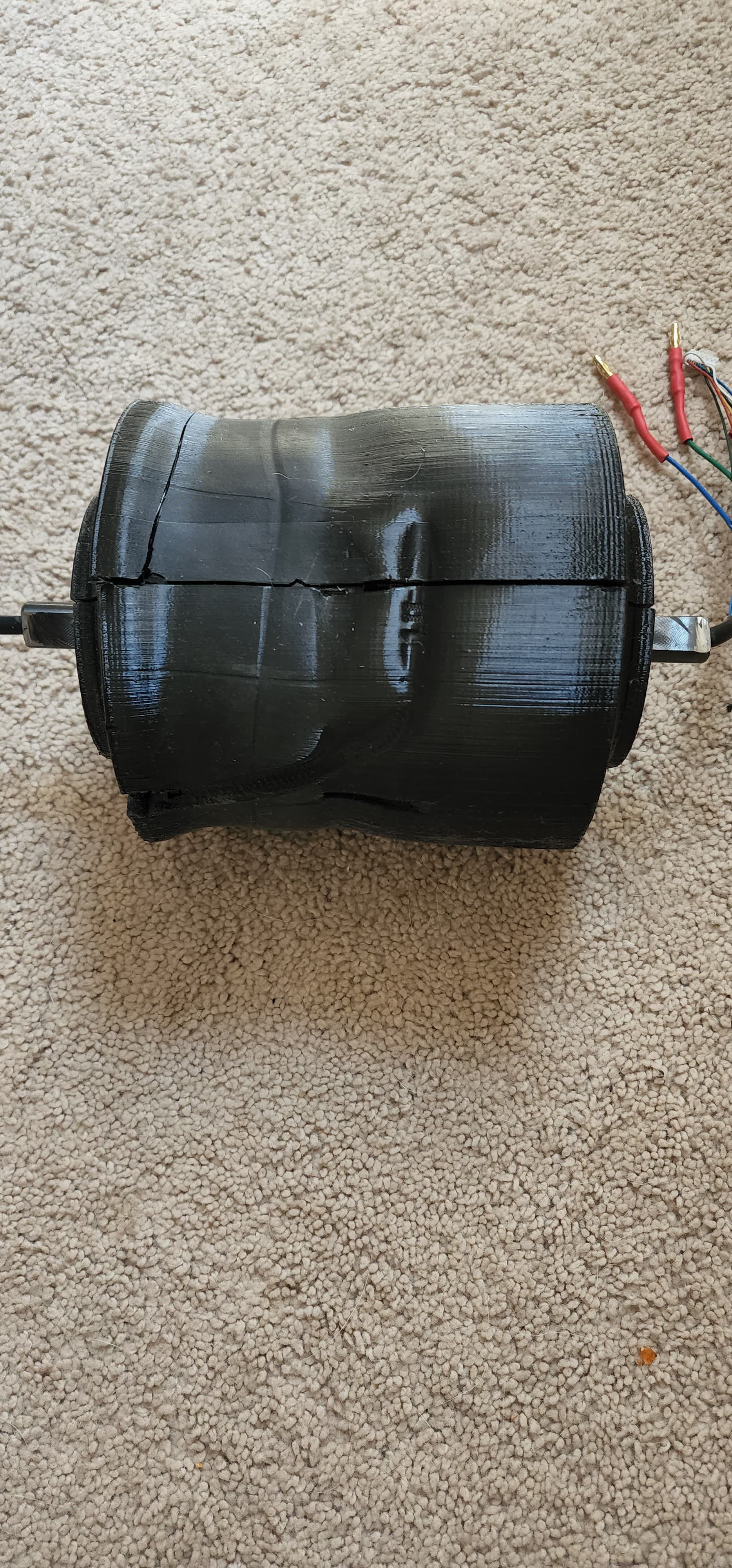

Melted my 3d printed rim. Overheated a motor with vesc and too much D gain. Grabbed my second set of motors and made a new motor. I bought two lawnmower wheels from harbor freight. They were 13x4 tires with a split rim. Rim is sized for a 6 inch tire. I drilled through the stock bolt holes on the motors all the way through the face. Then I fed 8/32 rod through both motors. Then added half a rim to one side. The exposed threads had me concerned for the innertube. I used some aluminum foil heating duct tape. Wrapped the center 4 times. Folded the sides over the motor lips. Then I wrapped over that with electrical tape. Since both halves of the rims I needed had valve stem holes. I covered one with 4 layers of aluminum tape and then wrapped that area of the rim in electrical tape. Inside of rim was now nice and smooth. I put the taped end plate on the motor. Then I put a 13x5x6 innertube in the 11x6x6 tire. I turned the tube on its side. So it would face the hole easier. Then I realized it would be a pain to get the valve stem out. I removed the tube and put the stem through other wheel side wall. Then put the cap on. Then I tucked the tube back into the tire. Bolted the second half in place and filled with air.
The harbor freight rim hold fits perfectly on the bump in the hoverboard motor plate. I used that alignment to put the drill through the back plate and drill the harbor freight rims out. Worked out very well. Tire fits perfectly.
Just wanted to share the way I built my rim/motor. The tires from harbor freight were 14.99 a piece. I spent more than that printing my first rim. I think on my next build I will do the exact same except print a tube that slides over the inner motors instead of using foil tape. Hope this helps some of you. Link for rims I bought.
