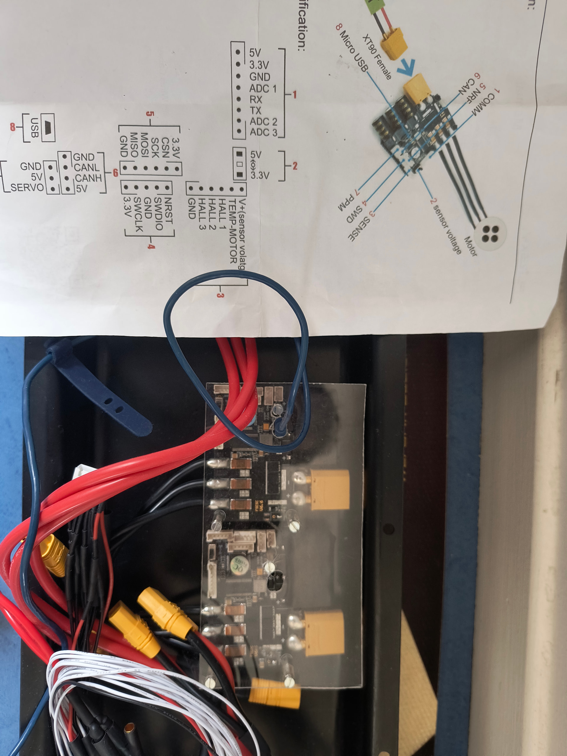

Hello,
I finally put the last drop of solder on my project and I’m ready to start the configuration. My setup is a double FSESC6.6 with two C6364 outrunners (not sensored) powered up with two 10S4Ah (35-70C) turnigy Lipo in parallel.
I connected my VESC to VESC-tools (v6.05 in linux). I managed to connect the VESC HW to the VESC-Tools app but it tells me that the firmware is outdated and the the connection is limited in the available features.
When I try to run the motor detection, it ends up with the message :
”Cannot read motor configuration” and it does not spin the motor a all.
Is this problem coming from the firmware version ?
Which version shall I use ? I read that 5.2 is favored for the model if FSESC6.6
Sorry for the basic questions … I read a lot of stuff but there seem to be specificities for each ESC and I could not fund that much on this single FSESC6.6.
Also is there a way to know which version is currently installed ?
If you want to use firmware 5.2 you need vesc tool 3.00 . You can find it here Precompiled VESC Tool Archive

You should update to the latest firmware. It’s just better
It is safe to do so even with this “no so recent“ VESC design ?
Yeah of course. Vesc 6 and vesc 4 architectures are by no means obsolete
