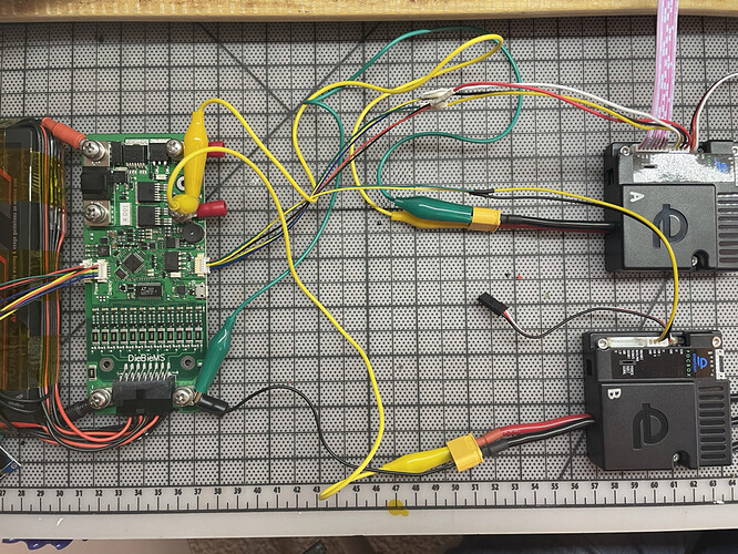

It’s there or it’s not if you have the baud rate and things set up properly, which I believe I do. I use the DieBieMS Tool for the BMS and VESC Tool of the VESCs. Everything seems to be operating as expected except the BMS is not showing up over can.

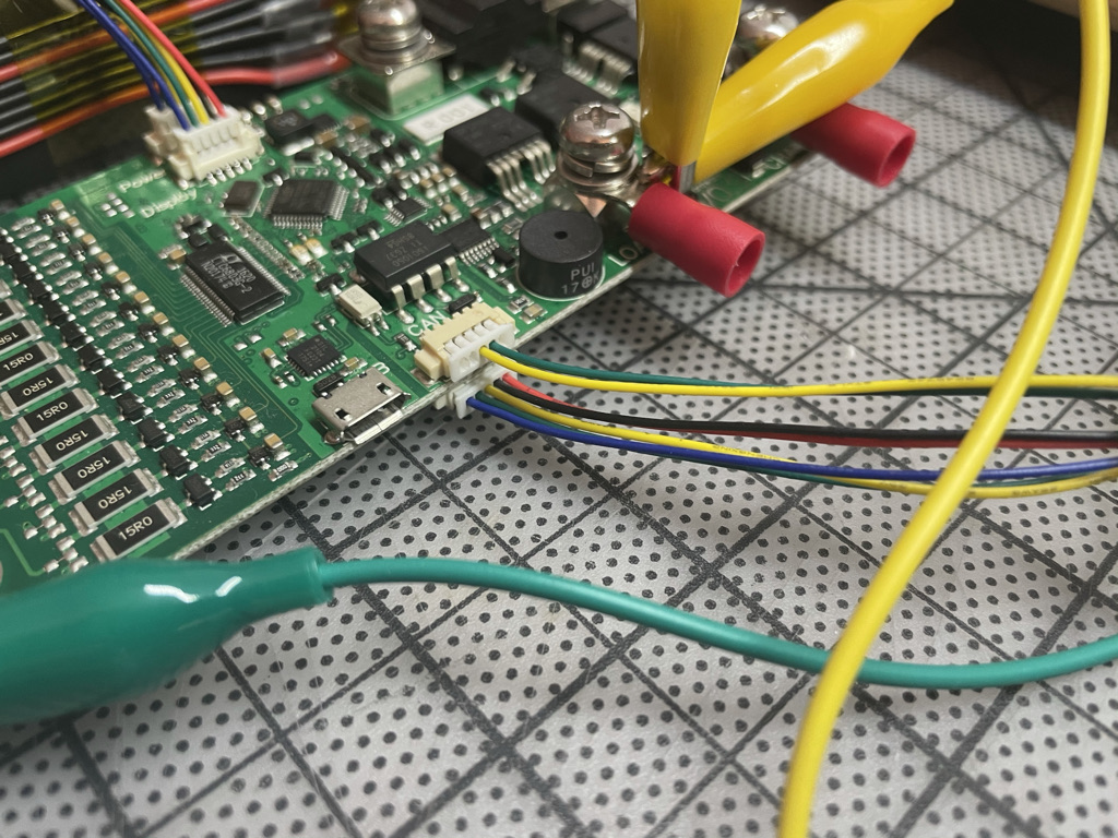

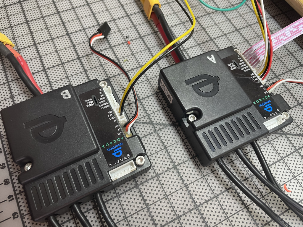

Here is my mess of wires at the moment (not running the motors with these tiny wires, just getting the rest of the system set up first). There is a Metr Pro plugged in that is not in the photo. I appreciate any tips you can offer.
Do you supply 5V to the CANbus port from one of the VESC (not only CAN_Enable) ?
EDIT : chapter 2.5 of the manual.
Yea, confirmed the CAN IC was seeing a clean 5V.
Are all the CAN IDs different ?
The VESC FW set a random CAN ID.
If you’re unlucky, one of them can be set to 10 (same as DieBieMS should be) and mess everything up.

@JTAG got my DieBieMS back on its feet earlier this year which was unexpected and I am very thankful for. I am finally getting back to wrapping up my built and was in the process of confirming everything was operational. Things seemed to be fine but maybe a little rough in BDLC so I went to try FOC (which I always ran on my last board) and a spark shot out of the FOCBOX near one of the phase wires. Still unable to detect its origin but the FOCBOX is now dead. When I meter it’s power connector it appears to be shorted.
The DieBieMS displayed a precharge error and I got some magic smoke off of the wirewound resistor (R33) and now it appears cracked. It appears this is part of the precharge circuit. I believe this is the part: SMW318RJT
Any thoughts on what could have happened? Could a short at the ESC cause this type of damage to the DieBieMS before it’s protections kick in?
