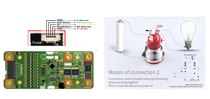

how do i wire this so the led turns on when i push the momentary switch?

no worries, i have a specific switch i want to use for aesthetic reasons :wink:
the one in the photo actually
I’m not sure what the “LED Smart” pin does, but wiring the push button led+ to 3V should be enough, since 3V will wake up when you push it.
Is the led smart pin a battery indicator light thing?
nope, it just a led ring that light up. you can wire it so the led always stays on or only turns on when you push the button
LED You want
  • led smart (+)

@PixelatedPolyeurthan that picture does nothing but confuse me but if I would guess:
In my connection the NO pin is logic low. Blue line(gnd) is connected to both “1” and the “NO” pin thats not drawn on.
Ignore both of them wireing guides the DieBieMS dose clever things with the smart led to blink the led to give you more information. Don’t link any thing just take 4 cables from the DieBieMS to the switch. You just need to identify LED+, LED-, Com, N/O needs to be a momentary switch I’m guessing that it’s not looking at the wireing guide. there is a setting in the DieBieMS for useing a latching switch
