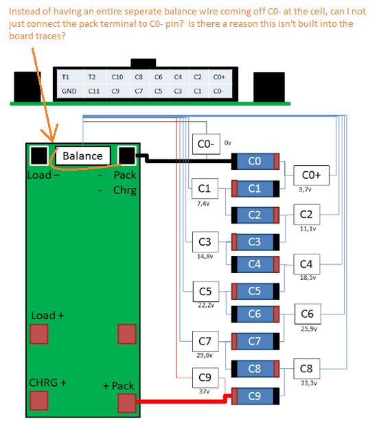

Here’s my question.
Technically there could be a difference in resistance if your B- cable is much longer, etc, but it would be so minor I highly doubt it would make any difference. This should be just fine.
