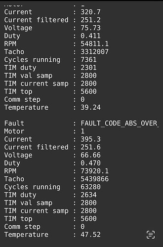

So is it throwing OC’s because its using the the 4 total escs amps but only for what the dual max current can do?
Say max is 250a for the makers dual, but running 2 duals you should be fine at getting up over 400a.
Seems like a 4wd fw glitch to me
I might be wrong, but i don’t think the faults care about the combined total amps, only ‘per esc’ amps.
It seems fucky to me too. Those be some low amps really to be getting overcurrent faults.

They’re not currently connected over CAN cause I think I damaged that so, think of each as it’s own. But I think @glyphiks is right they don’t care about total just per side.
This is a fault print out from just one side back when I had it set to 200A abs max l, you can see the spike is for 215A thus over current.

394A over a 214A filtered seems like a big short spike.

your other spikes above are also close to 2x over filtered. which i’m assuming to be the “slow abs” number. and whatever interval it’s averaging over… the high water mark is double the average. i wonder how short that interval is.
Yeah not sure how that works. I guess we can’t change that interval either.

Next I tried traction control mentioned by @glyphiks and started at 7500 diff ERPM mentioned in @Titoxd1000 post. And wow I was surprised that actually helped. Today I did also notice the wheel spin happens toe side more than heel side so traction control really helped. I dropped it to 5000 ERPM diff which further reduced the wheel spin.
I was at this point able to start hitting sub 2 sec launches, was feeling good.
Then the best time yet and fuuuuuuck I faulted under load at 20-25 mph.
You can see above where the last fault happens at ~74k RPM.
I tried dropping the amps to 60A but I don’t have to tell you my confidence was a bit shattered and I just didn’t have it in me anymore today. Times went back to shit.
At this point idk. Two more things I’m thinking of trying. One try going, sensorless and two replace the front motors with my old 225KV ones. I guess third option is to send them in to @YUTW123 but damn AVS around the corner.
I have half a mind to set fault time to 5 ms and say fuuuuuuck itttttt.
