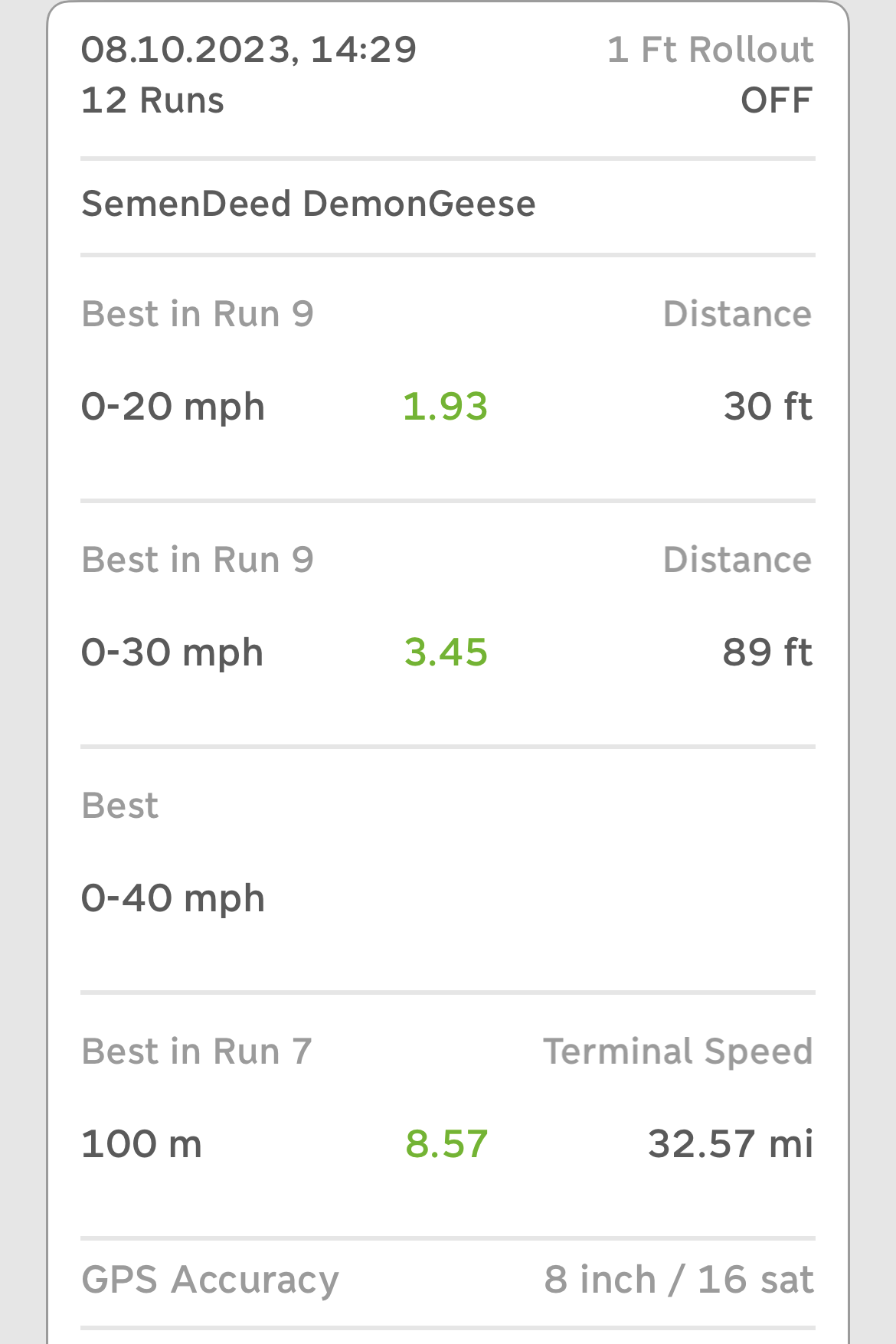

I was at this point able to start hitting sub 2 sec launches, was feeling good.
Then the best time yet and fuuuuuuck I faulted under load at 20-25 mph.
