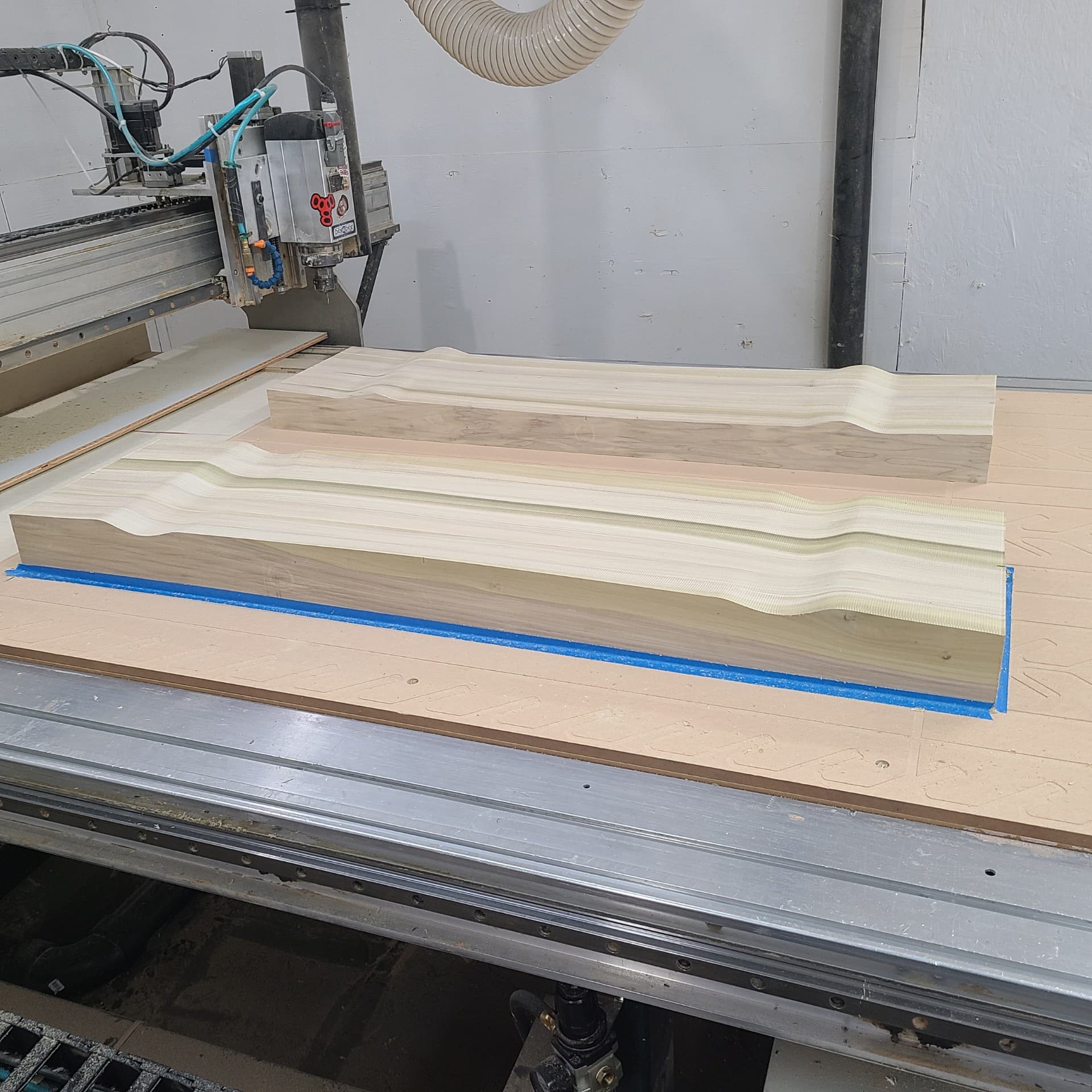

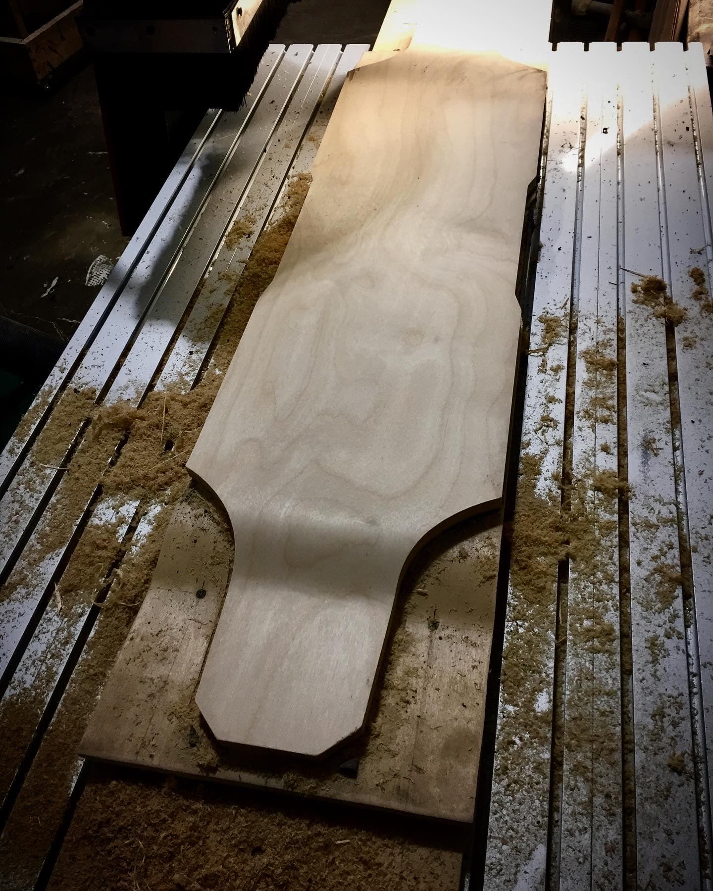

The molds were cut! Gorgeous work by Vince at Pushmore:
They’re on their way to Pennswood now.

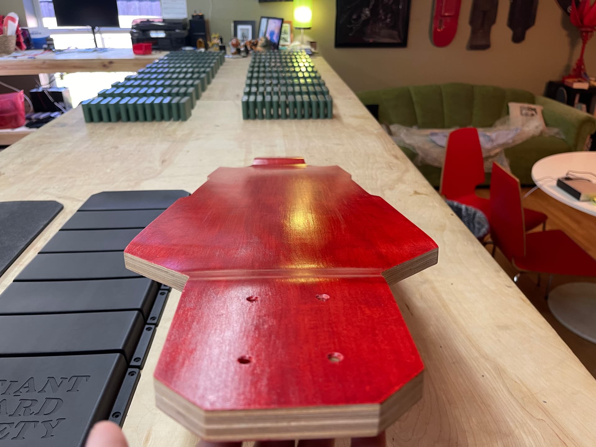

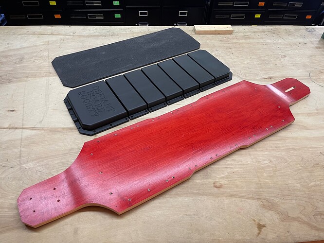

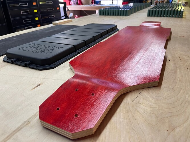

And here are some pics of just the deck as we would receive it (minus grip and graphics, they will be doing that for us as well) once they’re all pressed and shipped, alongside the enclosure and foam gasket:
If the samples come back from Pennswood correct we’ll be happy to post pics of the final deck with grip and graphics once they arrive.

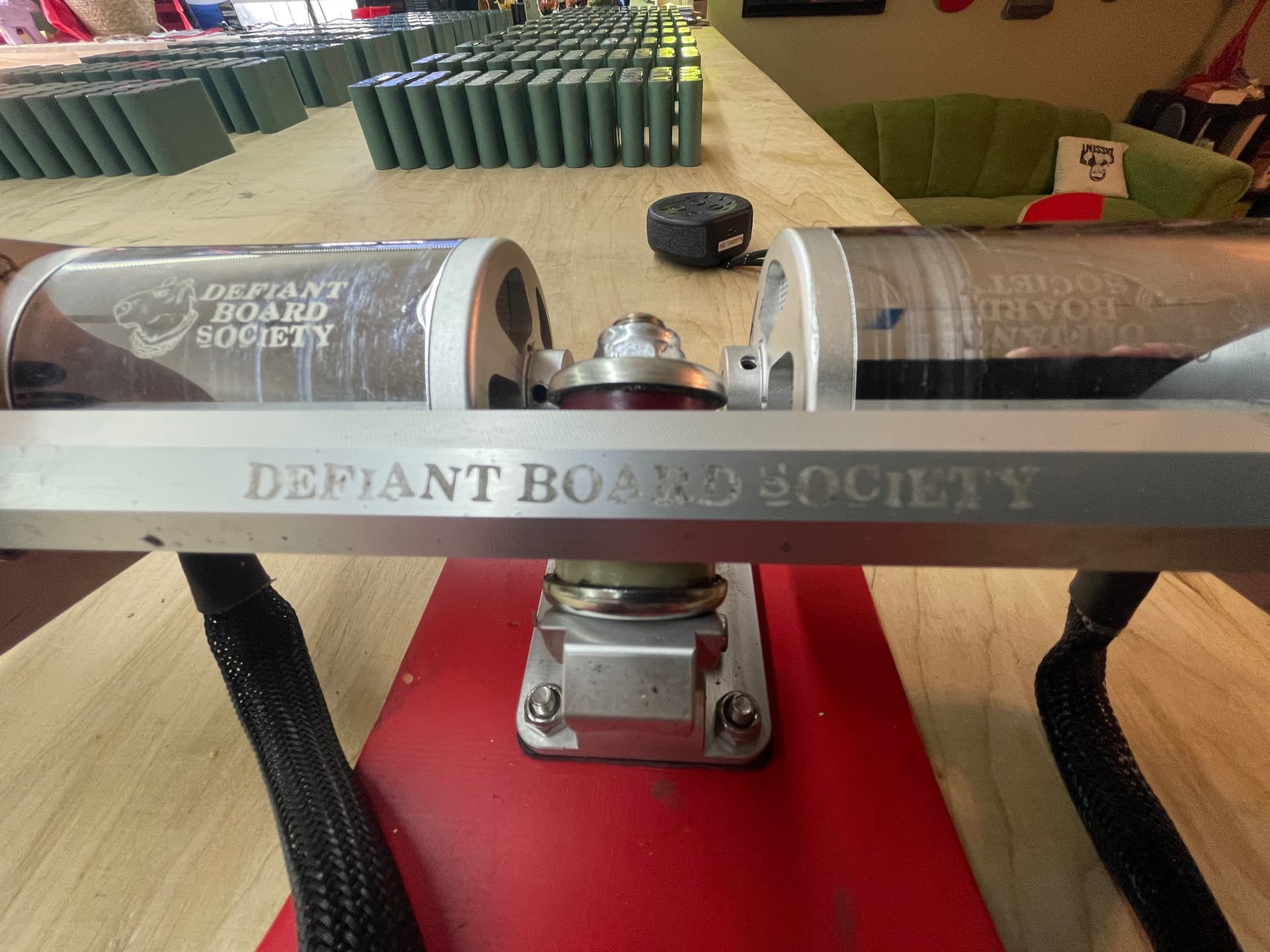

Trucks and gear drives finally showed up. Sorry if we held up anyone’s Boardnamics orders…
Some of you may know already that these aren’t stock BN gear drives. The motors are rotated outboard at a fixed angle, the hangars are bevelled to accommodate that, and because we had a specific ratio in mind (2.22, or 60/27) the casings are super tight around the gears which should help keep them lubed a little better.

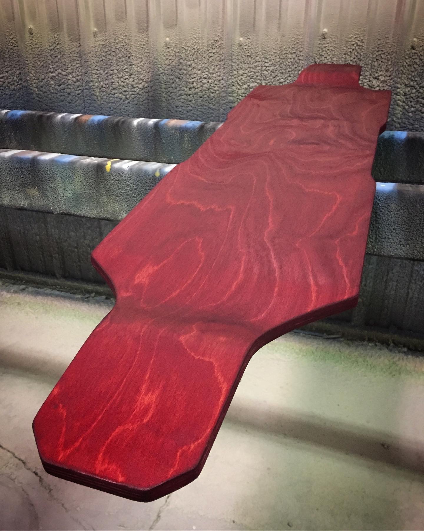

Also, we got picks from the deck factory. We should have samples in hand in a few days but these are the pics they sent us:
As a cost cutting measure we decided not to go with the nude edges on the production decks. The two sample decks from the designer have nude edges, however, and those boards will be used as review units.
