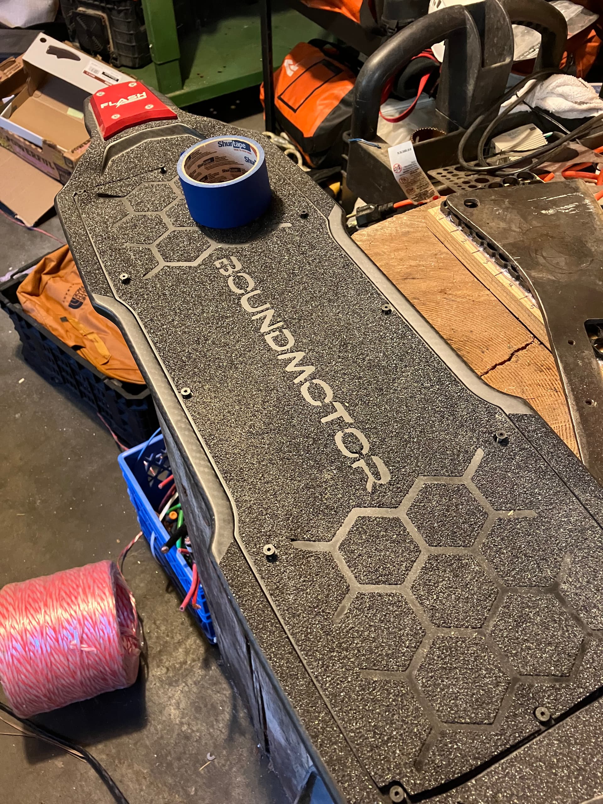

Integrated enclosure, like this?
New but dusty, was a poorly planned purchase and my build went another direction. I decided I can’t live without flex.
I can take a billion pictures and get dimensions from it if you want? I think it’s still for sale new on their website. Selling cheap so dm if interested but i can show you all the details regardless as a lack of details is why i never used it.
Yep that’s the land cruiser deck right? I was looking at that and it was pretty sweet. That was one of my first choices too but unfortunately boundmotor does not ship to Korea and I’m a little concerned on the shipping cost of the thing lol. I’m also running a bit low on funds… It is awesome and I would love to get it tho.

Well if you do decide on a boundmotor deck the flash i have easily fits a 14s4p p42a with room for vesc and bms. I think they have a newer one that fits a large battery but I don’t know their products well. The deck is very good quality but their grip tape left a lot to be desired. The factory applied tape doesn’t fit correctly and pops up and off in a few spots due to the curves of the deck
Yeah Boundmotor octopus deck was my first choice when I originally planned for a 12s3p deck. Until I found out they don’t ship to Korea. You reckon if I give them an email they’ll make an exception? It’s pretty much exactly what i’m looking for. The flash deck that you’ve got would be my first choice now that I’ll be using a 12s4p pack.
