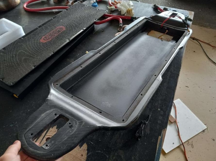

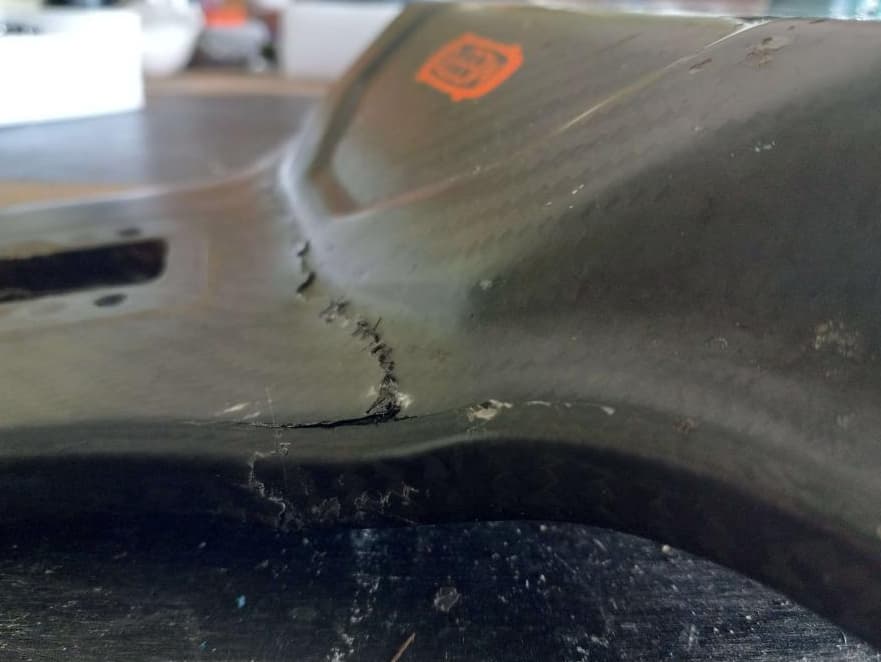

So long story short, I got hit by a car today. My deck is cracked all the way through right behind the front truck, and I’m looking for some options to fix my board. A new deck from Meepo would run me about 500$, which makes me want to consider other options. Hurricane 3K Carbon Fiber Deck. Another option would be repairing my deck myself using either fiberglass or carbon fiber, but I do not have experience doing either of these methods, and I’m not sure that I would trust the deck 100% again after being repaired. The third option would be replacing the deck with something else entirely. It would need to be a very stiff deck because of the battery, and of course have a similar sized enclosure. Do you guys have any recommendations?

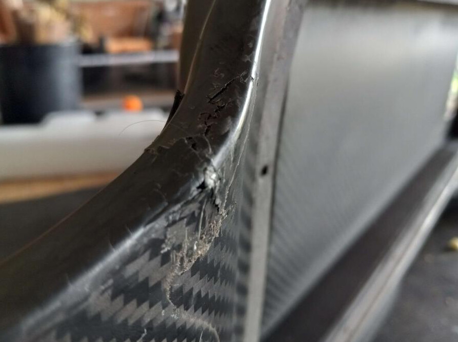

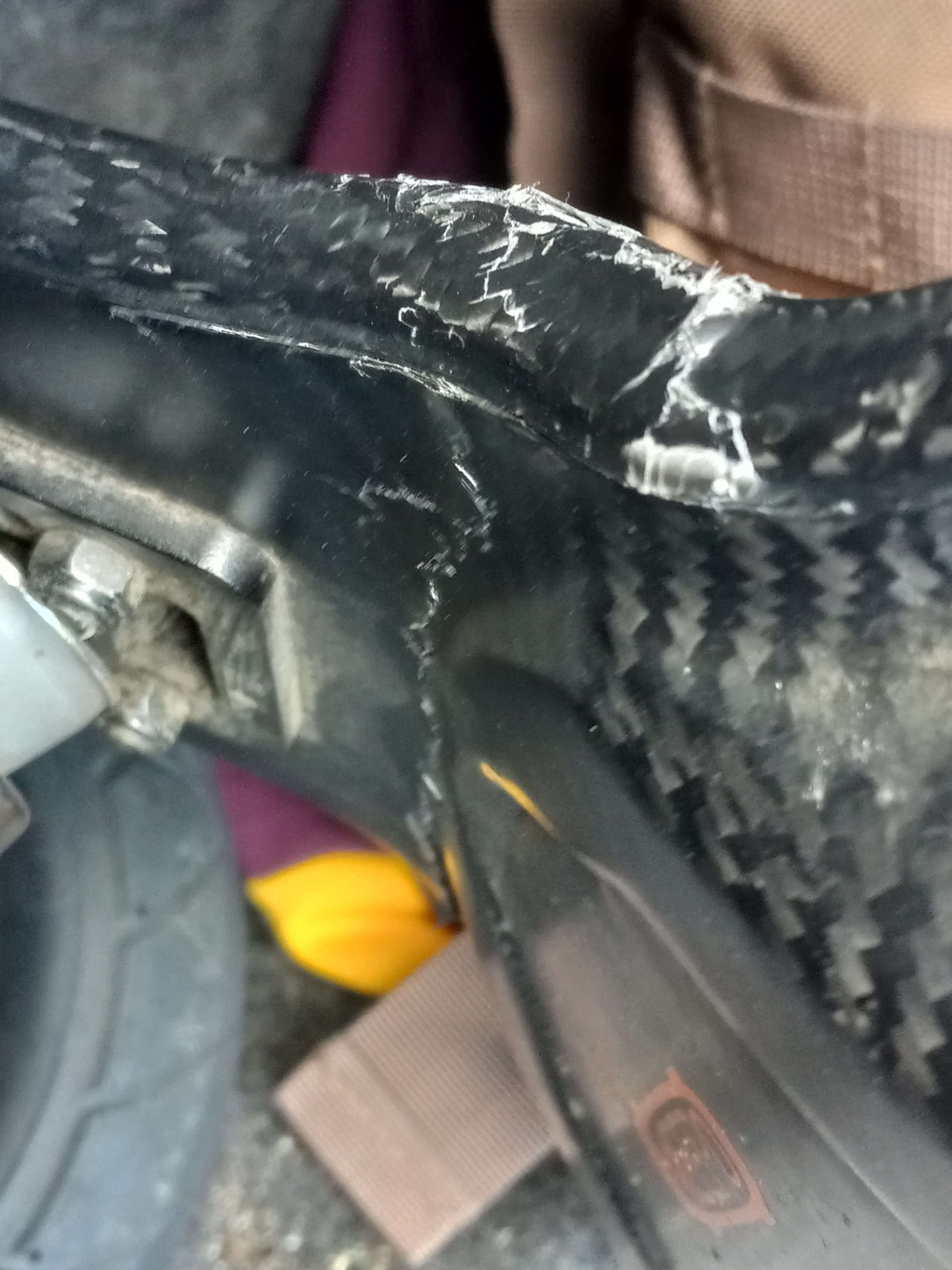

can you upload a photo of the break? It might be pretty easy to fix depending on the break.
also that deck price seems a bit insane. Is it for just a deck or is it for an entire new board?

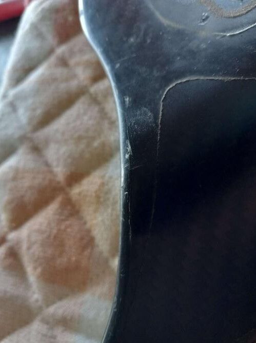

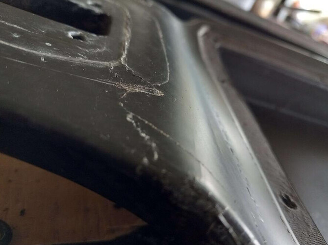

Yeah the deck is definitely super expensive, I’ll add some photos here.

Damn, if it wasn’t for that bend it would be a less than $20 fix unless you needed to buy some tools that I had already when I fixed a similar break
This was the fix I was going to propose but that can’t work due to not having the surface area for the lumbar tie to bolt onto:
I still have this deck and would be safe to use it IF I didn’t want to run an extension bracket so I can use a surf adapter. which might still be safe but I didn’t want to risk it
I do still think your deck can be fixed but it won’t be easy. If you did any part of the fix wrong it could end up unsafe, so I don’t feel comfortable trying to explain how to do it online. Even more so if you have no experience with epoxy resin since it is easy to mess up. Also without being able to see it irl or having fixed a similar deck before, I am even more hesitant to give advice on fixing it.
Yeah if I’m going to repair the deck I think I would have to fill the crack with resin, and then layer more carbon or fiberglass layers on the outside.
I’m looking at some of tomiboi’s options right now, and it looks like there are a couple drop-deck options that would work nicely. They are both a lot cheaper than a new deck from Meepo, and I can ask him to make it extra stiff due to the battery.
Personally, I’d want to sand away some extra material from the outside on the top quarter or third of the deck and then add sheets of fiber glass on top of the entire section. On top of the repair of the crack itself.
I’d want to double check about the strength of using fiberglass instead of carbon fiber first though since it could require more bulk to be added to get enough strength back. It is easier and safer to build back up to support way more weight than you’ll ever need since that way you know for sure that it is safe. Also you’re not building a bridge so the extra time and money to make it too strong isn’t an issue. :rofl:

That deck is toast IMO. You could probably frankenstein a fix with a lot of work, but i’d never trust it.
500 for a complete deck/enclosure of that level of finish is a decent price, i feel like trying to transplant onto something else would be more hassle than it’s worth.

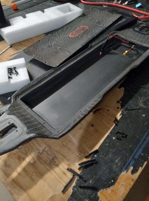

Quick update, I’ve fully disassembled and stripped down the deck, and I’m going to attempt repairing it with a LOT of sanding, epoxy, carbon fiber fabric, and patience. If at the end I test it and its strong enough to use, great! If its not strong enough to use, then I’ll just order a new deck and swap over all the parts.
