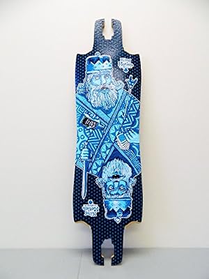

This is my brothers board its actually a customskateboard.com deck I linked above.
i mean i guess its a temporary solution, as for the decks im looking at them right know and i really like them. Are most of their decks flat or do they have concave?
They do have concave, a good amount of it too.

I’m looooving the feel of this deck. It holds the feet so well.
it looks kind of cheap? ill look into it though. ur dog is cute asf
@J0ker rocks one as well. I took his advice and don’t regret it.
Haha thank you. My other dog is better looking
I actually use this deck as a cruiser/downhill dick around board and its stable and durable.
It holds your feet in well and you can always get a good stance on it.
hmm well if both of u like it i think ill try it but ima try to find a way to take off the graphic
Agreed :face_vomiting: I’m currently in the same boat. Thinking of doing a gold foil on the bottom.
