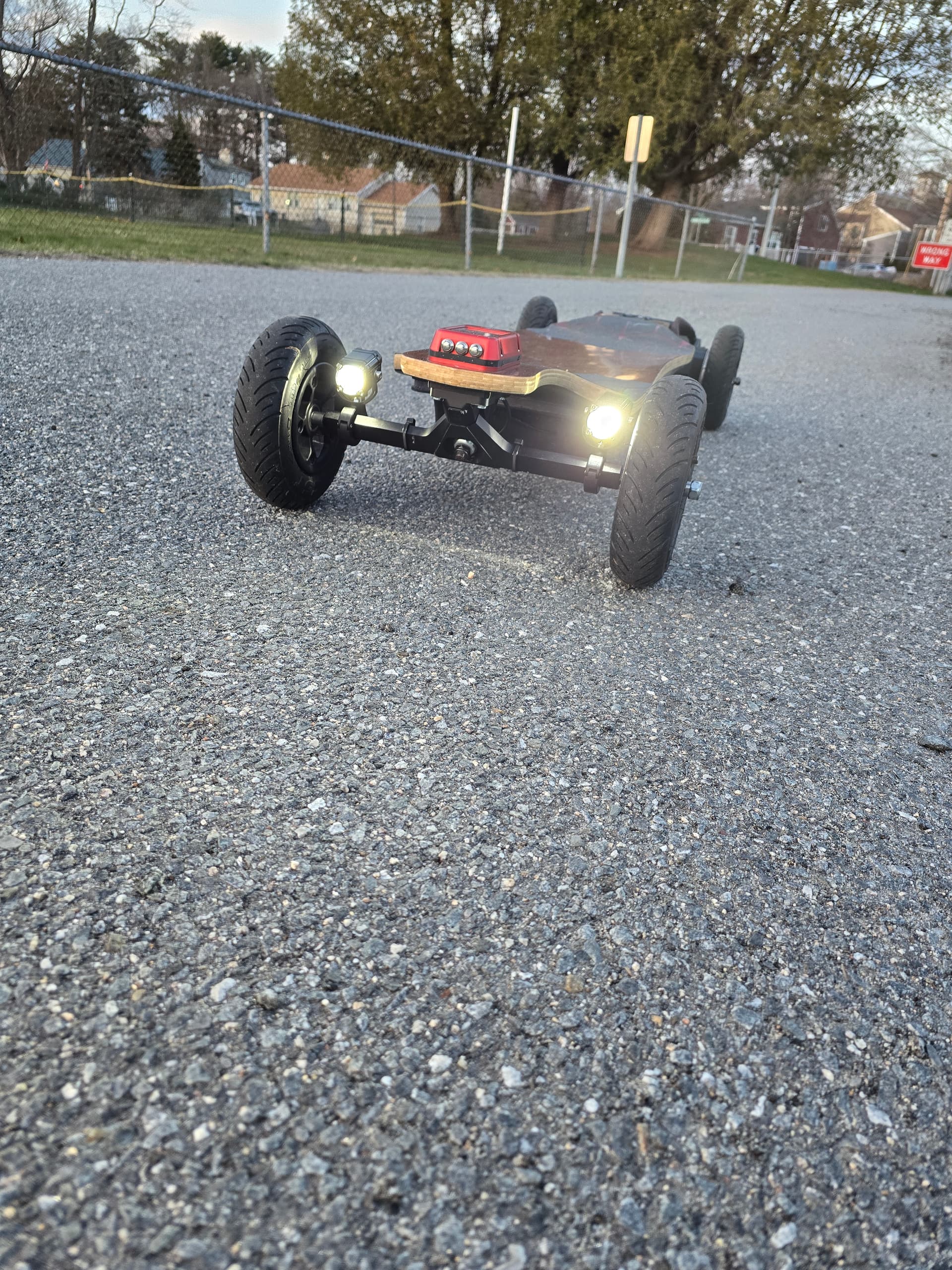

Deathwish Build
Another build that I have wrapped up for the most part
14s 18t/60t 179kv 193 mm tire 3950 beta thermistor
Deck
  • Tomiboi Deathtoll 45"
  • fiberglass top
  • carbon fiber bottom
  • dried blood red stain
  • double stack enclosure
  • custom deck spacer
Trucks
  • Hoyt Rosa Split angle
  • bushings 93A wine red Riptide
  • extended axels
  • motor pulley cover delete
  • 2 mm risers
VESC
  • Ubox V2 100V vesc 5.3 no limits firmware
  • 150 phase amps per motor
  • 100 battery amps per side
  • Weipu SA8 connectors for motor sensor wires
  • TPU gromets through deck
  • Bioboards heatsink mounted with thermal paste through deck
  • 5.5 mm bullet connectors
Battery
  • 14s8p
  • p45
  • ltt smart bms
  • charging at 15A
  • 3d modeled design
  • carbon fiber nylon printed components
Motors
  • Reacher 6495 179 KV motors
  • Boardnamics Motor Mounts
Remote
  • Hoyt Puck Remote 2.0
Belt Drive
  • 18T/60T Belt Drive
  • 21 MM motor pulley
  • 24 MM Idea Wheel pulley
  • 20 mm belts on the way
  • MBS Rockstar Hub with 3d printed spacer
  • CST 200mm Tires
Other
  • hardwired mounted headlights

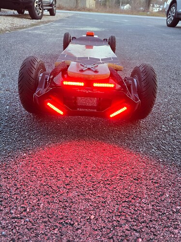

  • hardwired brake lights - work with remote

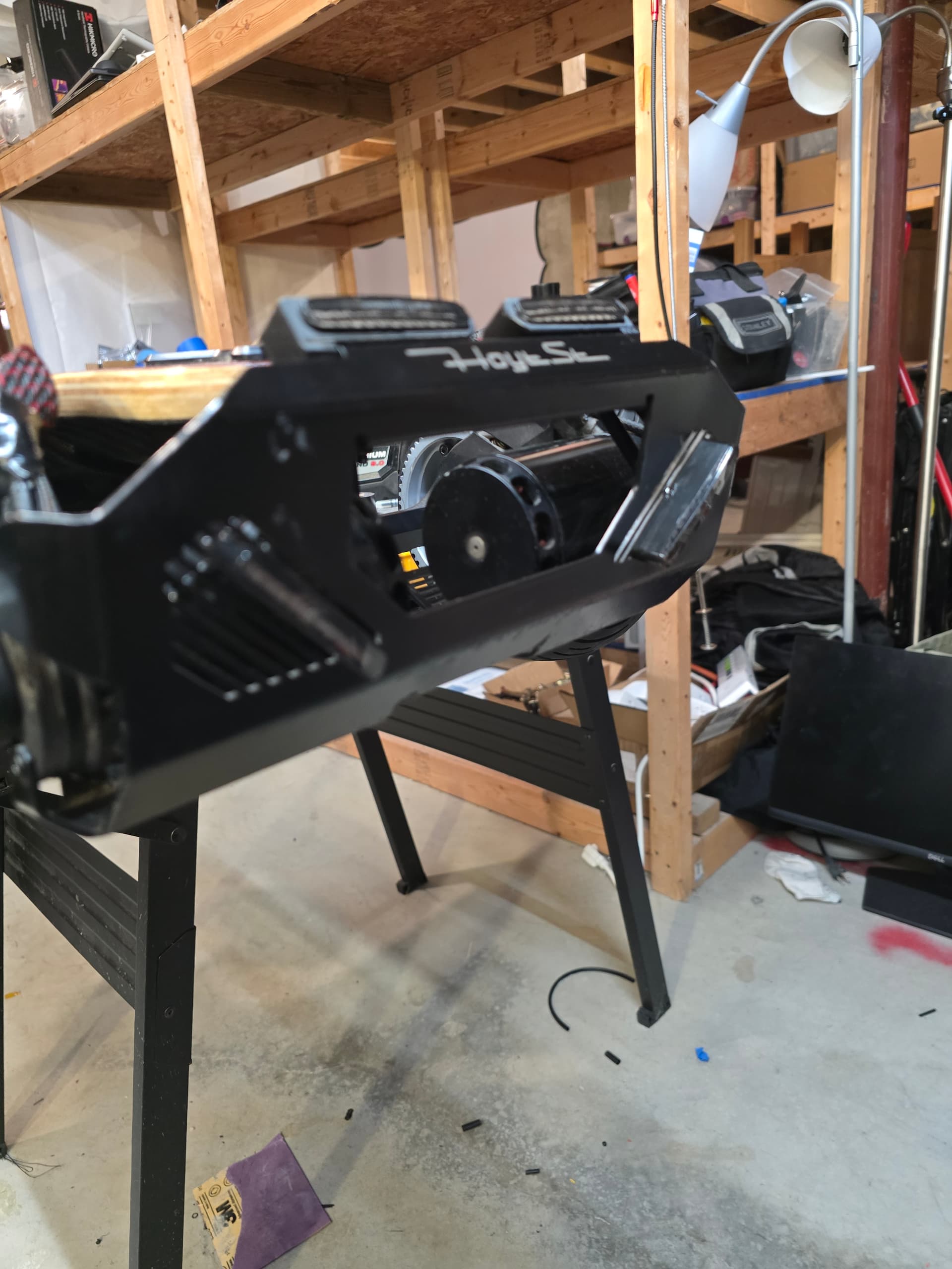

    • brake light housing uses an expanding friction fit design inside of Hoyt
      truck handle
  • Davega
  • Radium antisink plates
  • I had Newbee Triple Link trucks on this for a few hundred miles at one point.

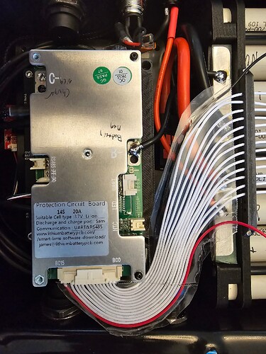

Love the balance wire routing :star_struck:

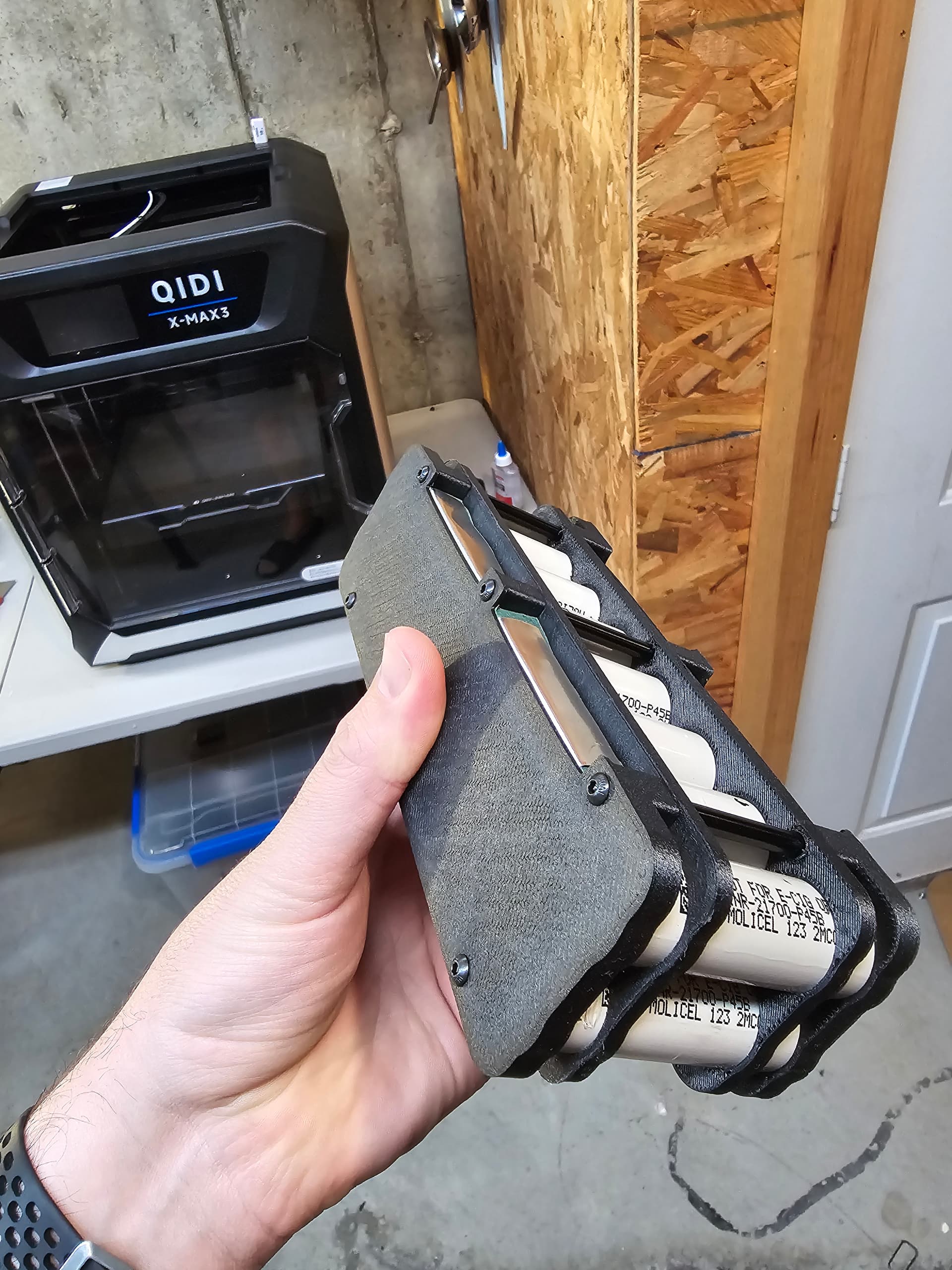

It serves a dual function to protect the series connections as well. The underside of my deck has 1/8" foam.
These balance wire separators press into the foam when the enclosure is on. That way the battery is secure and doesn’t move around, but the load isn’t being placed in the balance connectors if that makes sense
